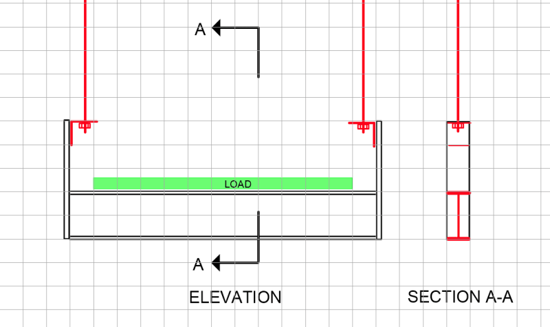

I have a beam hanging from rods as shown in the attached sketch.
What do I take for the buckling length?
The load is on the top compression flange so I'm considering it destabilizing, the compression flange has no lateral restraint and no torsional restraint. BS 5950-1 table 13 gives a value of 1.4*L(length)+2*D(depth).
Does this sound right?
Thanks, Nick

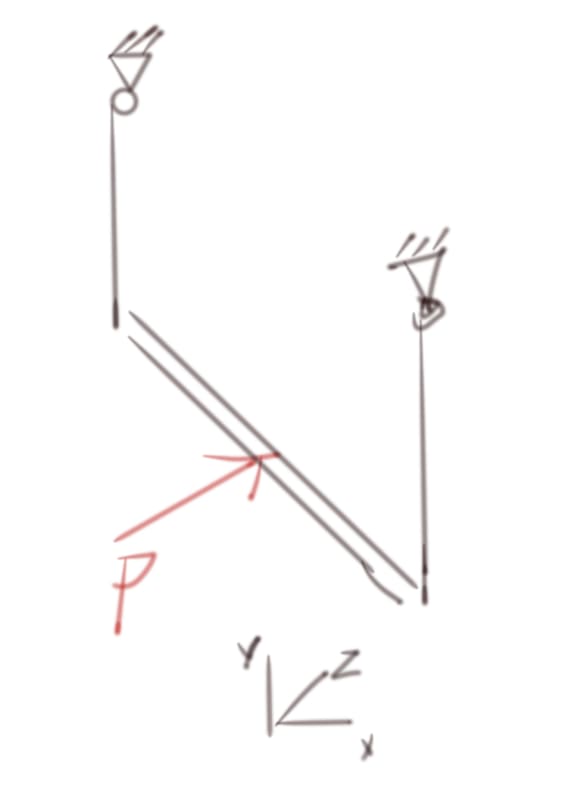

If this is a single trapeze set up as below, and if P represents the Lateral 2.5% force in the Compression flange required to cause buckling.. then what resists this horizontal force to cause buckling in the first place?

that's the trouble when your structure is a mechanism. But lateral buckling due to bending is an issue, no? the lateral stability of the compression cap … it not like there's a lateral force applied, and yes, this mechanism would probably act in odd ways. If there were stiffeners on the web, supporting the cap flange, would that do it ?

Suspending from a higher point would improve stability (see below). I think the beam could be considered torsionally braced.
