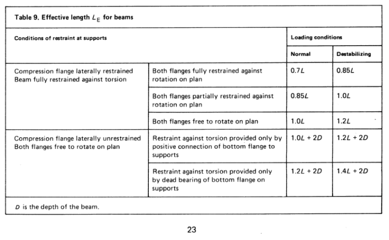

Hi all,
I have a beam hanging from rods as shown in the attached sketch.
What do I take for the buckling length?
The load is on the top compression flange so I'm considering it destabilizing, the compression flange has no lateral restraint and no torsional restraint. BS 5950-1 table 13 gives a value of 1.4*L(length)+2*D(depth).
Does this sound right?
Thanks, Nick

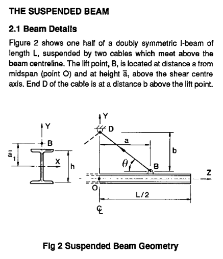

It really depends on what height we are talking about (at least according to the research I cited above). According to the Dux paper, at least when the cable angle is 90 degrees, the height of attachment would have to be impractically high to get close to the simply supported buckling value.
Apparently (to answer the why of how this happens, as has been raised in this thread)....the height of the attachment makes possible the mechanism for buckling to occur. To quote from the Dux paper:
"If the load attachment point is raised to the shear center axis as well (i.e., 2a2/h = 0), the flexural-torsional buckling strength reduces to zero. This is a consequence of the complete absence of torsional restraint when the beam undergoes displacement u and rotation ø..."

I couldn't find that quote in the Dux paper, but I suspect a2 is intended to be a1 with a bar over the 'a' (see below). Following the procedure set out in the Dux paper is one option but perhaps not worth the effort for a single beam. Instead, it may be easier to replace the hanger rods with something designed to prevent torsional rotation of the beam.
Dimension a1 in the OP's sketch is less than h/2, clearly not enough, but it isn't clear how much would be enough, so a little conservatism is warranted.
BA
I couldn't find that quote in the Dux paper....
It's on p.1888. (3rd paragraph)
....but I suspect a2 is intended to be a1 with a bar over the 'a' (see below).
In the Dux paper, a2 is defined as the "distance from shear center to [the underhung] load attachment". Its a1 matches the sketch you posted.

BS 5950-1 provides a conservative approach for equal flanged rolled sections in Article 4.3.7.7 (see below). Use that with LE of 1.4L + 2D.
BA
HTURKAK said:
The case , 1.4*L(length)+2*D(depth) is valid for partial torsional restraint provided only by pressure of bottom flange onto supports.
Your case ; UDL Destabilising load ( drawn with pink) , since above the shear center of the section .
However, the beam is supported with tension rods. That is, stabilizing effect at supports is provided only with gravity. That is, your case is worse than mentioned case ( which is valid for conditions which some restraint provided at supports).
I will suggest you to use sections not subject to lateral torsional buckling, (i.e. square or rectangular hollow section within the limiting value of LE/ry given in Table 15 .).
I disagree with the bold print. Your case is at least as good as the mentioned case; in fact your case is better than the mentioned case because you are supporting the beam above the shear centre.

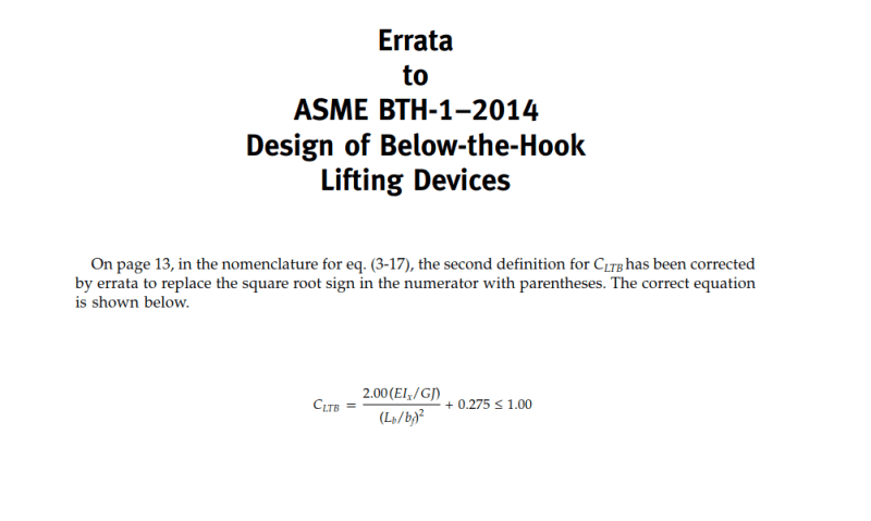

By the way (for anyone who is interested), I had forgot about this (which is embarrassing because it's a thread I started)....in this thread, winelandv was kind enough to post a excerpt from BTH-1 (the 2014 version):
They provide a factor to compensate for the lack of restraint at the ends.
Is this a valid restraint model for suspended beam buckling? From David Duerr "Lateral-Torsional Buckling of Suspended I-Shape Lifting Beams"(2016). The C_LTB factor is the BTH-1 factor that WARose linked to.

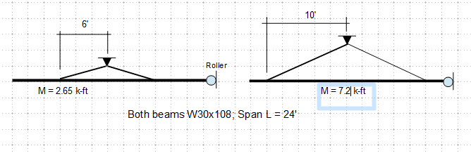

I've performed an analysis on a 24' long wide flange beam, with two lifting schemes as shown. The resulting moments are as indicated. Will they fail?
And, in case the issue wasn't confusing enough already, see below.
BA
Duerr used the corrected equation.
It is annoying that they didn't correct the equation in the text, given it's an electronic document.
