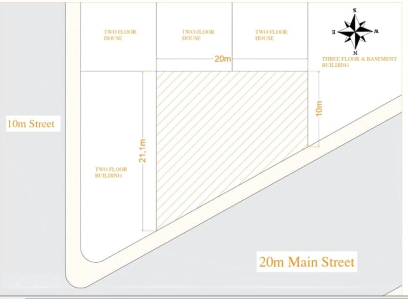

The site plan is shown below.
Buildings to the east and west extend to property line.
On the south border, two houses are believed to be set back from the property line.
The north border is skewed parallel to Main Street.
On the north and south sides, steel sheet piling will be needed to prevent collapse of soil beyond the site borders.
On the east and west borders, sheet piling, if used, would have to be placed tight against the existing buildings, which would be damaged by vibration from the pile driver. Moving sheet piling away from existing buildings or using secant piles may be possible, but that would reduce the footprint of the proposed parking levels, which is not an option.
There appears to be no easy solution to the problem. Others may wish to comment.

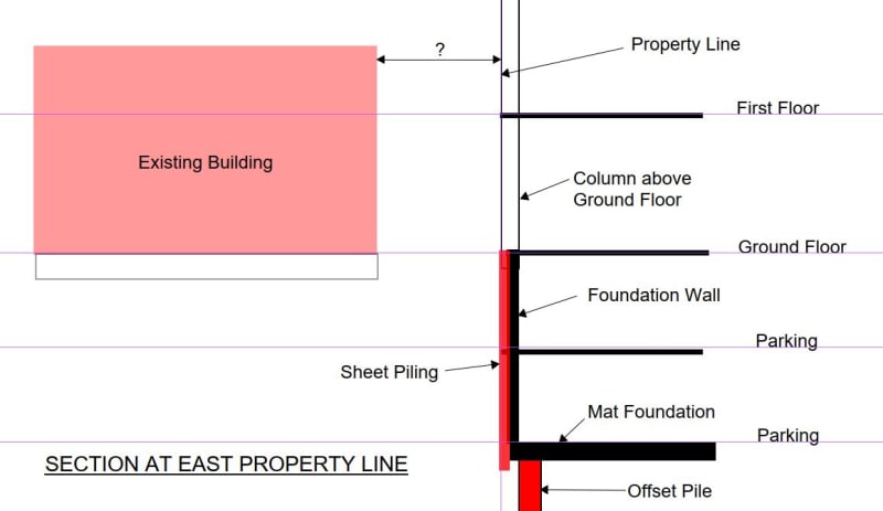

hoshang said:
Just for discussion, suppose existing buildings don't extend to the property line and one uses piles to support excavation. Can one use these piles as vertical force resisting members in the places of the columns since these columns should be located on property lines? If not, i.e., if one uses piles for excavation support only and uses columns on property lines for vertical loads, doesn't these piles reduce available bearing area for mat foundation?
If the existing buildings do not extend to property line, the East and West border could be supported using sheet piling, same as the North and South borders. Sheet piling would extend from Ground Floor down to Elev. -7.2 (or -10.8 if the Architect adds one parking floor).
The mat foundation would extend to the sheet piling. The foundation wall would bear at the edge of the mat and would need offset piles to carry the load from above.

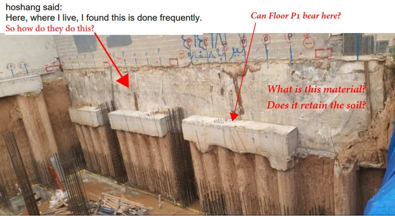

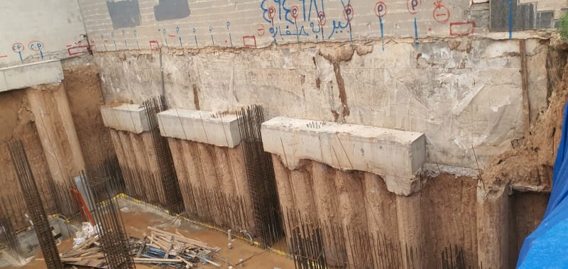

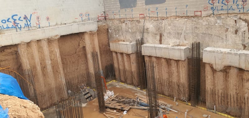

Using secant piles, can one use these secant piles as vertical force resisting members in the places of the columns since these columns should be located on property lines? If not, i.e., if one uses secant piles for excavation support only and uses columns on property lines for vertical loads, doesn't these secant piles reduce available bearing area for mat foundation?
Here, where I live, I found this is done frequently. Please find the images:
hoshang [COLOR=#EF2929 said:
and BA[/color]]Using secant piles, can one use these secant piles as vertical force resisting members in the places of the columns since these columns should be located on property lines?
Okay, I see what you are suggesting. Yes, I believe that could be done, but you would have to leave clearance between the existing building and the secant piles to avoid damaging the building.
Well yes, they would reduce bearing area, but if each column load is being carried by piles, why would you need a mat foundation at all?

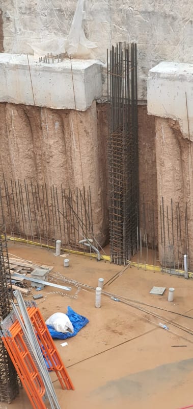

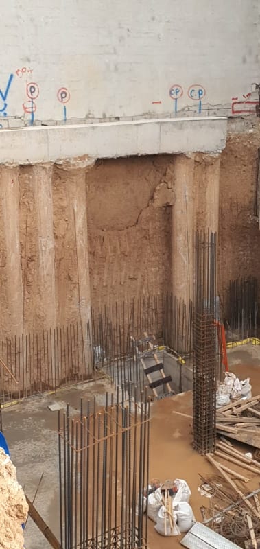

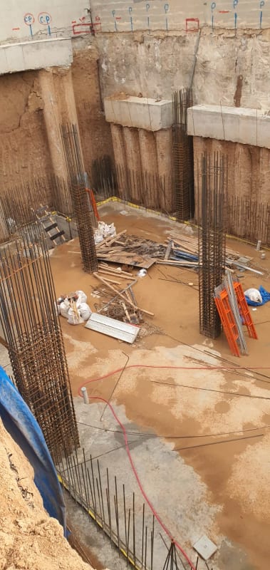

That is interesting. Thanks for the photos. I have never used secant piles on a project. I see no reason why the secant piles could not be used for vertical loads as well as lateral support for the neighbor's soil provided they are drilled deep enough to develop enough skin friction.
If so, how (two) basement floor slabs and beams are supported on secant piles since secant piles are already poured up to ground level before (two) basement floor slabs are poured? Would one use shear friction concept for this?
Of course not! The bottom floor is slab on grade, so does not need structural support. The upper parking level floor could rely on the pile at each column location (a temporary gap in the secant pile wall) to carry a floor beam. The secant piles carry their own weight plus the Ground Floor slab. Detailing to accommodate the upper parking level floor may require a little thought. That is why you get paid the big bucks!

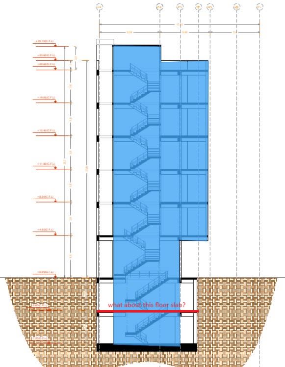

Also, what about the floor slab indicated in the image below:
The answer is yes...secant piles can be used for resisting vertical loads in addition to supporting the neighbor's soil.
hoshang said:
What about this floor slab? (P1 floor shown)
Well, what about it? Look at your own photos. Does that answer your question? Can you come up with a framing plan which supports that floor slab? Draw the framing plan for that floor. If you find that it cannot be done, forget about using secant piles.
If secant piles can be used for resisting vertical loads in addition to supporting the neighbor's soil, what about the floor slab indicated in the image below:
Can secant piles support this floor slab? If so, how do you recommend?
I have never used secant piles. You should talk to a piling contractor.

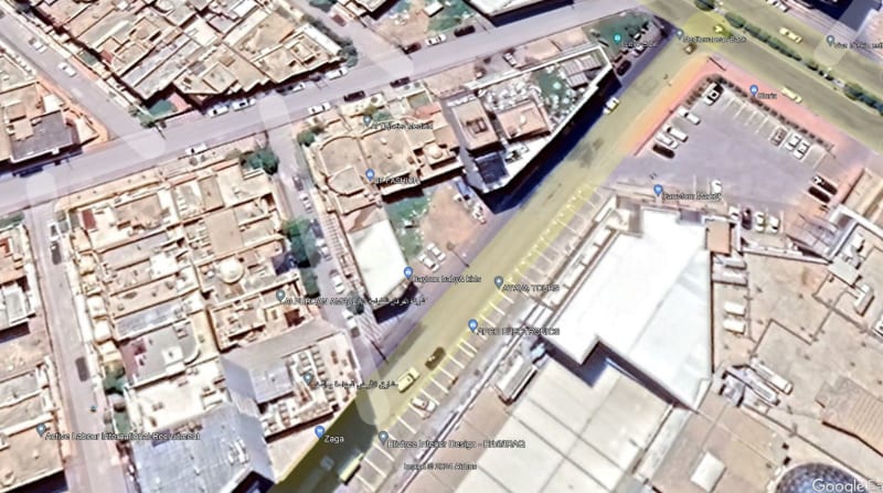

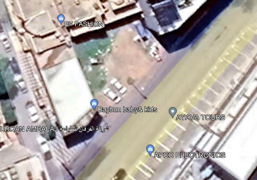

This appears to be the proposed building site in Erbil, Iraq.
The building on the left (east) extends all the way to the property line (see below). Using secant piles would reduce the usable floor area in levels P1 and P2 of the proposed building. Driving sheet piling close to the property line would damage the existing building.
BAretired said:
So how do they do this?
What do you mean? I can't figure the query.
BAretired said:
Can Floor P1 bear here?
How can Floor P1 bear on the back side of the image? On the piles?
BAretired said:
What is this material?
Does it retain the soil?
This is the basement wall of the existing building.

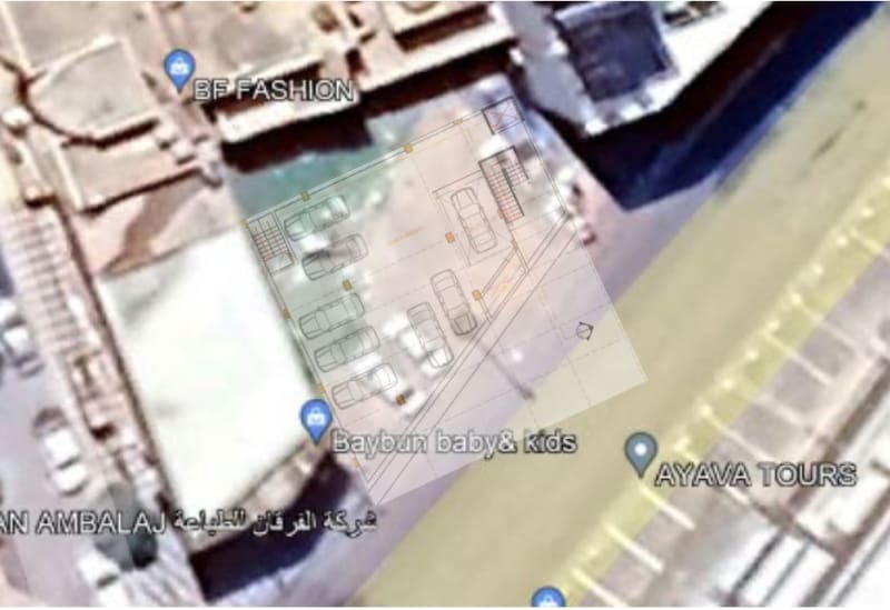

The architect's parking plan (20% opacity) was overlaid on the Google photo (see below). The white cars in the Google photo appear slightly larger than those in the parking plan, but the overlay gives a rough idea of the relationship of proposed to existing.
[li]The car in the Car Lift cannot make a 180 degree turn in the space available, assuming a minimum outer turning radius of 7.77m, even if the cars between Grid 1 and 2 are moved to Grid A.
[/li]
[li]Above Ground Floor, Stair #2 extends east to Grid A. Below Ground Floor, Stair #2 must move to make room for the two cars adjacent to it. [/li]

I am not sure where the south property line should be. I may have assumed it too far north on the overlay.
The parking arrangement is inadequate for the occupancy, even if it functioned perfectly, which it will not. The site is simply too small for the proposed structure.
