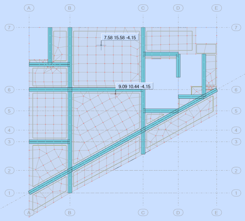

Hi all,
My thought is using response spectrum analysis rather than ELF code provisions for such a geometry.
The center of gravity and center of rigidity are as in the image below
What one can do to make these centers coincide? My thought is enlarging columns and walls.
To my uninformed eye, the CG, in the middle of the plan at (9.09, 10.44), looks about right;
but the center of rigidity, close to the top edge at (7.58, 15.58), looks very "funny".
What building configuration would you recommend for columns and walls so the center of rigidity would be close to center of gravity?
none, not a clue. I was just observing that the data (the center of rigidity) looked out of place.
hoshang said:
What building configuration would you recommend for columns and walls so the center of rigidity would be close to center of gravity mass?
A perfectly symmetrical one.
