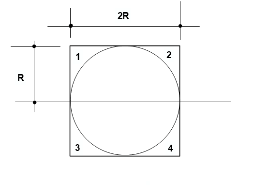

If you want even more accuracy, you could include the fillets, knowing the properties of rectangles and half circles. Areas 1 and 2 represent the top fillets whereas areas 3 and 4 represent the bottom fillets. Including these should provide all the precision you require. It is doubtful that the fabricated shape is as precise.
BA

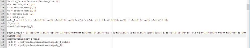

Hi
As per your Matlab code, how are you calculating the properties?
Are you using the geometry functions that Matlab has?
I've done the formulations previously for fatigue analysis of welds, I found the best approach is to use built in functionality that Matlab has, less chance of errors occurring.
Keep in mind that most FEA programs go the method of using an exact solution using an integral calculation of the Laplace equation on a discretised representation of the cross section. This allows for the input of any shape of cross section. I would assume that most values that are read from standardized books would use a similar approach or something slightly more simplified as this would give the best results.
This may be the variance you are seeing in your results.
I have attached a small snip of my code...
Note this is an old revision of the program that does not take into account the fillets, just showing it as the code is more compact and readable.
Hope this helps...
