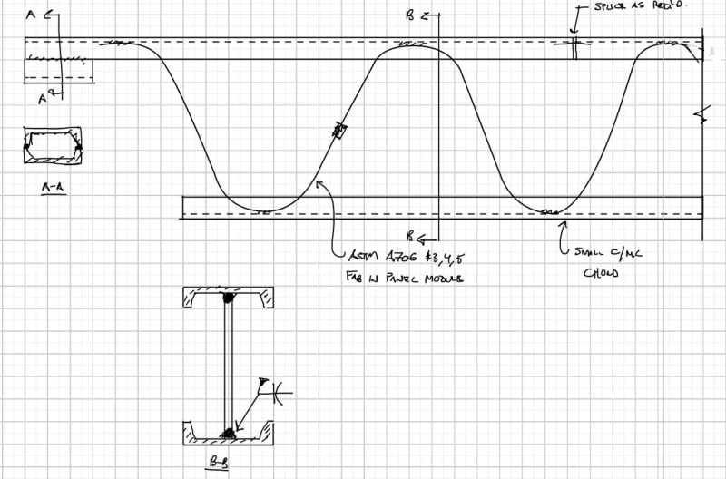

Small C or MC top and bottom chords
ASTM A706 rebar webs prefabricated into common panel lengths (Already getting some rerod for the foundations whats a couple more tons)
Bar Couplers to tie the web panels together, field weld on the bend flats to the C/MC's
Install the C/MC's flanges inward to give a nice flat for roof deck attachment and ceiling finish attachment.
End bearing is created by the formation of a box beam.
Can add additional rebar webs for rooftop equipment on demand.
Use of rebar for the webs keeps the weight down but will need some lateral bracing sim to current joist systems. Can also chop saw down to fit if needed.
I'm making a thing: (It's no Kootware and it will probably break but it's alive!)
Celt...not cool. That is exactly what I thought of KootK posted this. (Though I didn't come to the coupler idea - that's a nice touch). Too bad I had 4 dead lines last week and 3 this week...back to the drawing board...
Also, by not cool, I mean I like it.
Well, I was going to critique the full pen weld, but it appears that you already adjusted that Celt.

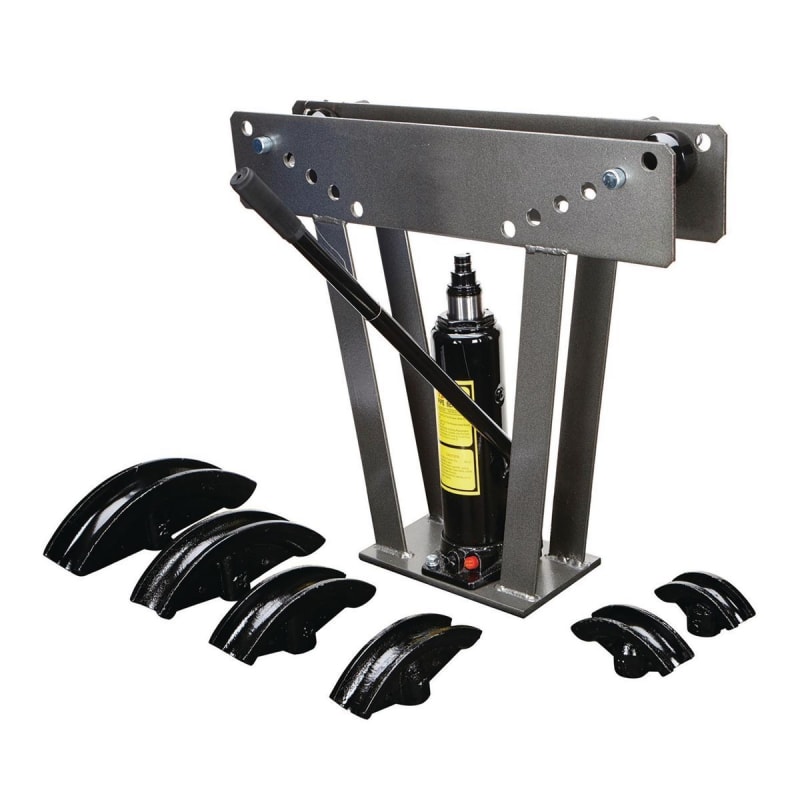

Should be able to bend #3-5 bar using one of these from Harbor Freight, so pre-fab panels an option or send it out in sticks: Link

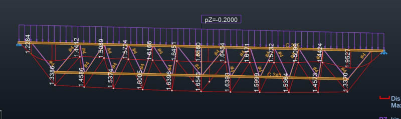

super quick and dirty model with C3x5 chords and #4 web bars - 30 ft long. 24" total depth appears to be deflection limited for L/240 at 200 plf superimposed.

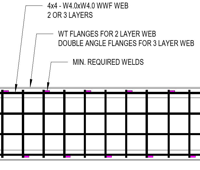

@Bones206: I gotta call you out on this one. You're basically asking for two way Vierendeel action out of that WWF, right? Maybe if you turned the mesh 45 deg.
Nice...
To play Devil's advocate, once you go down the bent bar path, are you not obligated to perform some testing prior to implementation?
