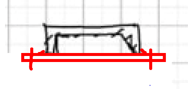

@Celt83: I wonder if you might modify your seat as shown below:
1) With or without the double channel, I think that you capacity will be limited by the single.
2) This arrangement provides the following benefits:
a) Low profile.
b) Improved seat rollover capacity.
c) Bolted connection potential.
yeah I do like that better it also adds the benefit of the welds being standard fillets as well.

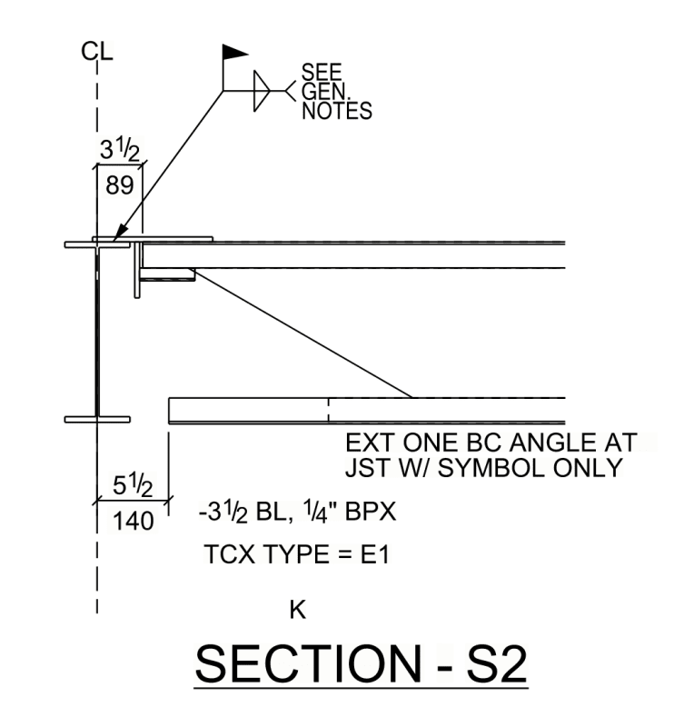

If you are talking low profile seats, I saw the detail below in the fall. Maybe it is common in other parts, but I had not seen it before. I was not the EOR, but if I were it would have gave me great pause.

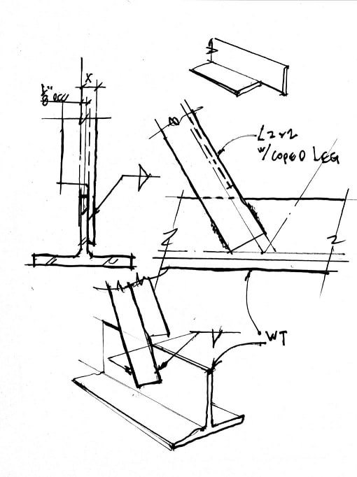

Enable said:
But I feel it would be poor form to submit a similar design with only minor modifications.
If it's better it's better.
For example: I chose to avoid extra cuts to shapes, favoring simplicity. But, if you were to cope the angle, a single angle web could be placed in such a way that reduces its eccentricity to 1/8" ish. This avoids flipping it over and has an eccentricity that we could more easily deal with. Maybe the labor saved in welding twice as many web pieces is worth the work to cope each piece.
In defense of this approach - if you're building and selling these trusses at even moderate commercial scale, the cost to buy ironworker dies for coping and cutting to length of the angles in one operation would be trivial, and thus coping of the angle would add very close to zero additional fabrication time.

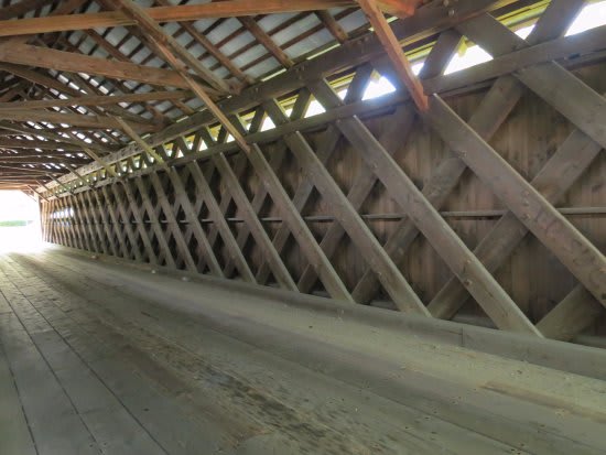

celt83 said:
treat it like CLT and alternate the layup of the WWF maybe 45 degrees to get you less of a vierendeel setup.
I initially resisted that temptation due to the additional labor and waste, but probably necessary to have a chance of working mechanically. Reminds me of the old lattice style covered bridges.
I'll give it a shot.

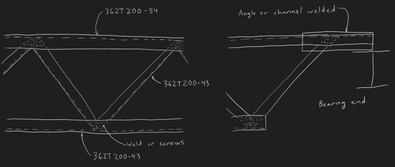

Simple cold formed steel truss with 2" deep tracks. It's basically a built up cold formed steel box beam, but with tracks as webs instead of sheet metal.
Pros:
-Can use same track size for chords and webs
-Each web element can be cut in the same way
-Easy to splice top/bottom chord if needed
-Screws are easy to install compared to welds
-If more shear capacity is needed near ends, welds can be used instead of screws
Cons:
-Can't put vertical webs
-Hard to put the "work point" in the correct place to avoid chord eccentricity
-Stronger than wood, but weaker than structural steel chords/webs

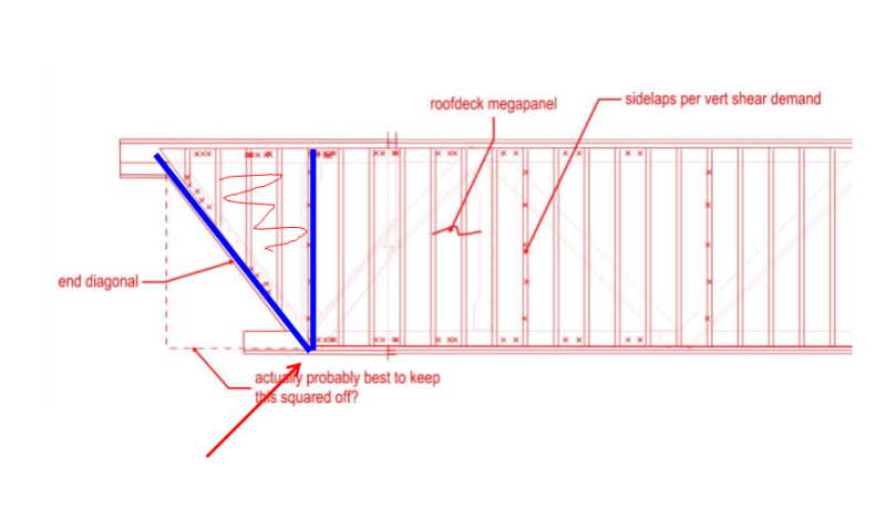

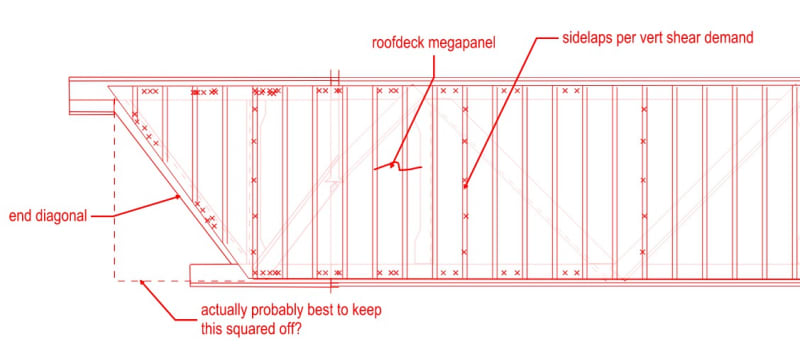

Interesting concept with the WWF. It has inspired a similar and much more half-baked (less baked?) idea. Instead of WWF, what about roof deck with PAFs to WT chords on one side only. The jig would just need to hold the WT chords and then you'd lay the roof deck onto the webs and shoot it down. I suppose the deck ribs would need to be vertical to have any sort of web compression capacity. Design fastening (PAFs) based on shear flow demand plus vertical/direct gravity demand? Heavier fastening towards the ends of the joist. Probably be best to have end diagonals to form a closed "megapanel".
In a way I guess this would be similar to reinforcing a wood truss with plywood.
Perhaps this would be the fastest option to fabricate thus far. Definitely the ugliest. Definitely the jankiest. And like I said, totally half baked.
That's a creative idea. Sort of similar to that Simpson Strong Wall panel except the ribs are going in the other direction.

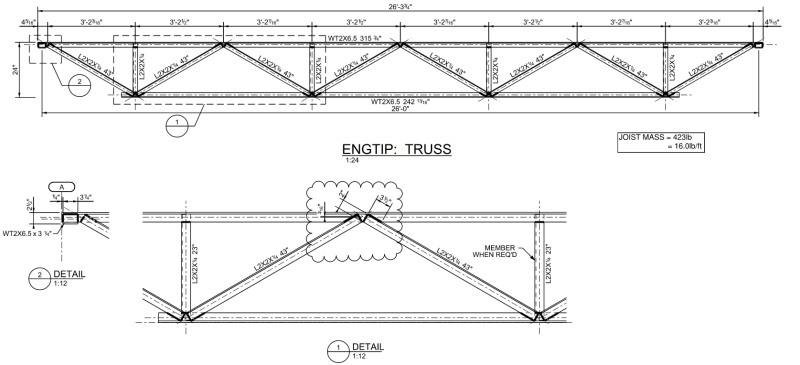

I mocked up a sample truss of kipfoot's.
Notes:
1. Too heavy still.
2. Parts simple, and a jig would be easy to make.
3. Welds seem too light.
4. This is one of the lightest WT sections.
Time to get out the calculator and see where it is at capacity wise.
It seems to me that you'd need both a diagonal and a vertical at the end lest the truss itself kick a large diagonal point load into the decking. It's an interesting mechanical problem.
Ultimately, I suspect that the biggest armor chink for both this and Bone's concept would just be difficulty in running services through the joists.
MSL, that was my line of thinking also. Having no exposure to the OWSJ world, I wasn't ready to propose it without running numbers on feasibility, but hearing that it isn't so far fetched may be enough to get me going.

Much worse than your traditional sawzall hole through a wooden I-joist? I'd think the WWF would be easy to cut and reinforce (for services over 4"), and while the decking might require a reinforcement panel surrounding the opening.. still doesn't feel that onerous.
Edit: How thick is "roof decking" in your part of the world? I'm thinking of our 0.35mm stuff, but yours is likely thicker.
just call me Lo.
@dold That's really creative. You could feasibly run pipes through it with some angle reinforcement. It reminds me of repurposing old shipping containers for homes and such.
@Lomarandil I didn't run any numbers. But if open web wood trusses can work, this can probably work too, just with less capacity than an OWSJ. I figured it would be for a janky solution where OWSJ's aren't in stock but there is a ton of cold formed steel lying around.
