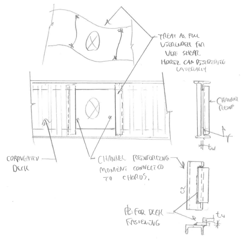

With respect to openings, I think that dold's solution should lean in to the deck being pretty worthless for that. Instead, make a full depth, vierendeel panel out of the opening and use the massive opening potential that would result as a deliberate selling feature. Since WT sections will tend to be over-stocky for K-series joist applications, I suspect that the chords could deal with this successfully.

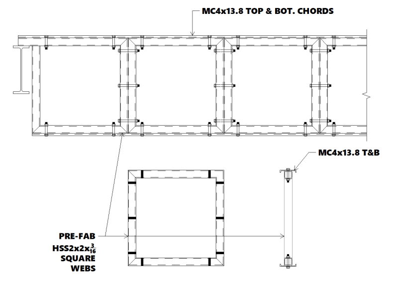

@canwesteng - I had the same exact idea with the rods and pipe before taking a hard left into the crazy WWF idea. One thought I had to workaround the protruding hardware problem is to put it inside the tube, and have access holes on the opposing tube walls. In the end I thought it was too cumbersome and probably not very stiff, but probably not impossible.
I'm thinking you could swap out the HSS with channels instead, and drop a cap on the channel to support the roof deck once everything is bolted together. Or maybe just leave it as is, and you stick a 2x4 on the top, cut around the bolt protrusions.

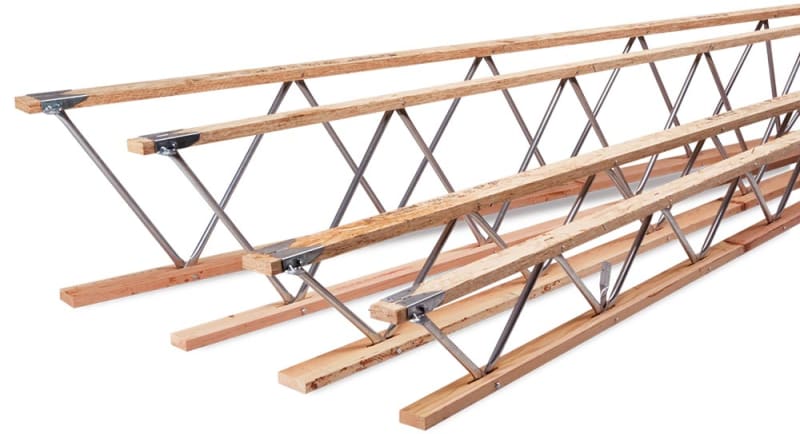

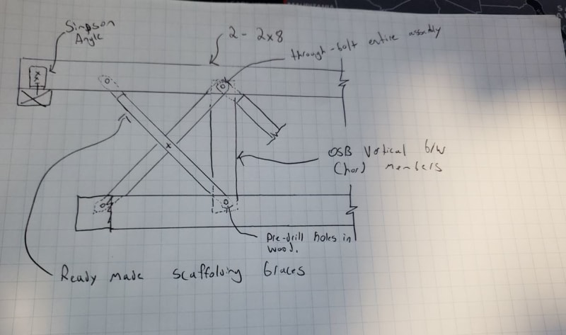

On more of the true DIY side how about a combination of wood chord members combined with pre-fabricated scaffolding braces? The braces already come paired and bent so could nicely be insert between chords. I think the smallest brace I can obtain readily works for a 2'x3'-6" tower so the brace would have an opening something like 20"x36". Note: not sure of extension of those plate pieces so edge distance may be a problem. Dont know.
....my hand drawing needs work

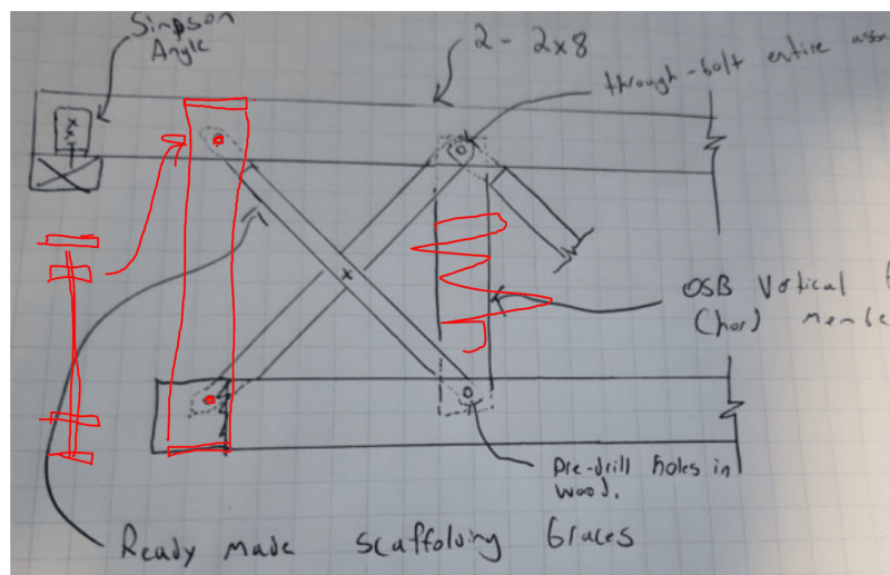

Given that the scaffolding pieces will possess significant compression capacity, I suspect that you could do away with the OSB verticals at all locations except, perhaps, at the ends of the web runs.
We can make that work. So long as the scaffolding pieces meet at a common bolt, the primary truss shear will spend no time at all within the chord members. As such, the bolts will also not deliver any shear perpendicular to the chord members. The one place where this will not be true is at the end of your web runs. There, you might introduce a hanger of sorts to "collect" the truss shear and deliver it to the far sides of the chords.
This approach is a big part of the "secret sauce" behind RedBuilt trusses which would never survive edge distance checks at the pins otherwise.

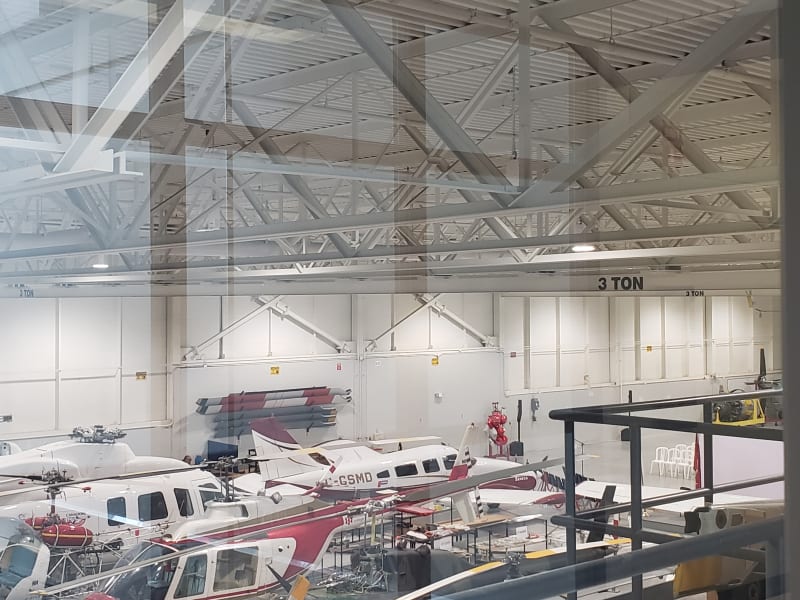

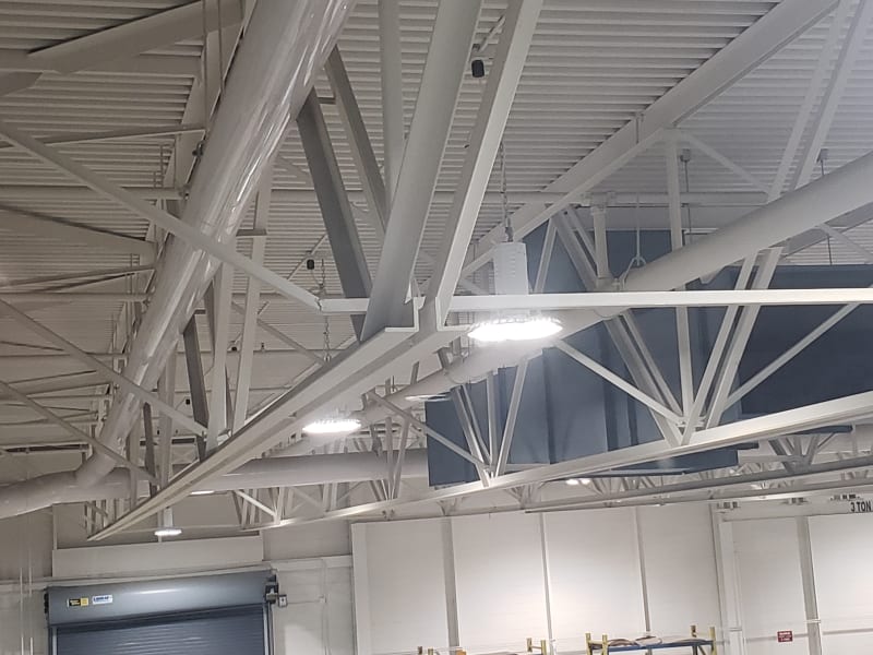

My program had convocation today and I actually saw some sexy joists / trusses (i've never been to this campus previously). In the spirit of this thread thought I'd share some of the photos! We were in the aviation hanger so also got to see the inside of a wing and yup, little mini-truss like fabrications. Pretty neat

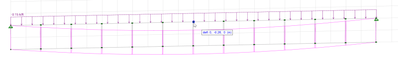

Hey everyone, sorry late for the party! Here's a cool concept I came up with today:
Tested this out in RISA, 0.25 deflection for 24 ft span. Not bad,
