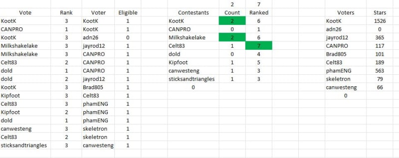

(Since a bunch of people are listing multiple votes, I'm assuming this is going to be a ranked choice/instant runoff type process?)
KootK said:
We're not doing ranked choice voting or anything fancy like that. I only listed my 2nd and 3rd choices for fun.
I'm only game if someone else tends to the tallying. You up for it?
Ha. I can read...I promise...
If we end up with a tie I'll jump in and do the ranked choice.

3) I'm not looking forward to having to scan through this to tally the votes. That sounds tedious. Should we do to the ranked choice voting? Is it fair to switch to that at the 11th hour? What if there is a tie?

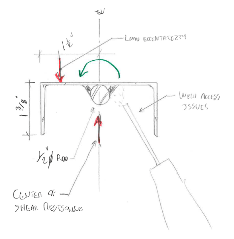

Things like using unqualified welds, not removing slag, etc. Pretty sure that would be a problem for any and all of these ideas.
I still harbor concern over the rod welding although, admittedly, my confidence in my understanding of this stuff is poor:
1) I've seen numerous problems with flare bevel welds at HSS corners. I've no idea if similar issues apply to rods / rebar. I do this all the time in my precast work but, there, the welds are being done under plant conditions by folks that know there craft fairly well.
2) I'd certainly trust the rod welding were it to be done in a plant environment and, preferably, using an automated process subject to a QC program and some validation testing. To me, this does not befit a situation where a contractor is is just slapping these things together on site with a general purpose welder doing the work.

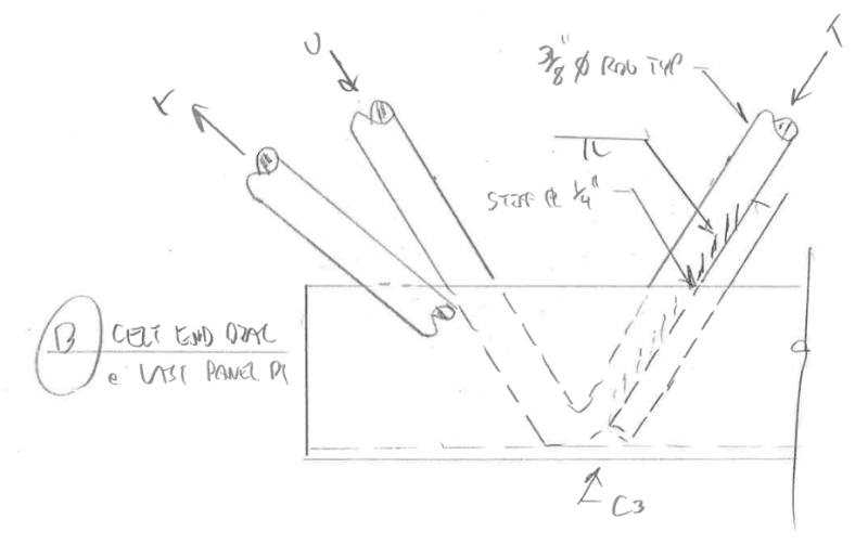

3) Below, I've sketched up a to scale version of this using a C3 which I assume would be the default choice. It appears to me that the weld access condition wouldn't be great which would tend to exacerbate any potential QC problems.
4) Load eccentricity will create a twist tendency that will tend to pry the weld apart. This same condition exists (successfully) when bent rods are used with hat channel chords. it doe not exist when bent rods are used with double angle chords as with the Robb joists which, clearly, had their own problems.
5) As a visceral, gut feel thing, I very much feel that it would be easier for to do a high quality fillet weld between two overlapping plate elements than it would be to do a reliable flare bevel rod weld. Am I really alone in that? Obviously, there would be a massive difference in expectations for joists assembled in a steel fabricators shop relative to joists fabricated on site or at a contractors yard.

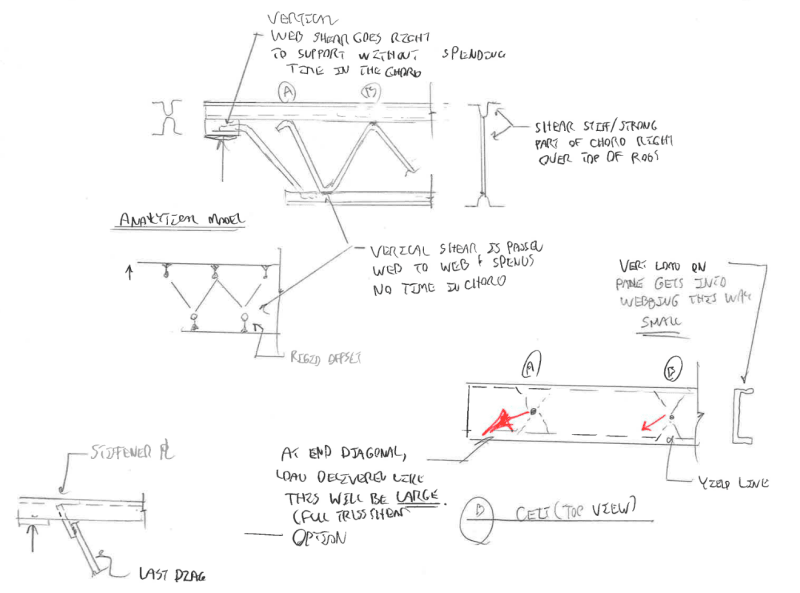

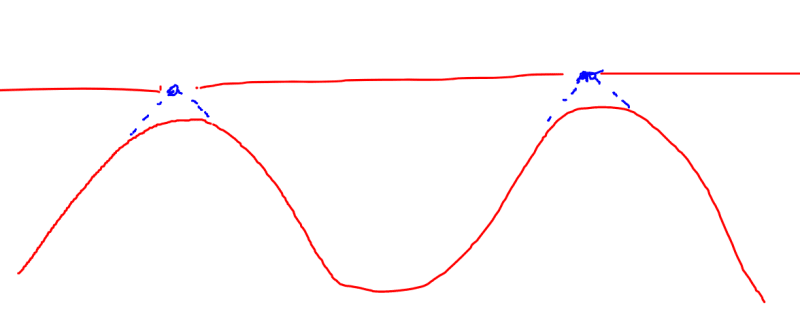

I have a particular interest in Celt's truss because, in many ways, it is similar to a scheme that is very common in my area and has led to a lot of reinforcement head scratching on my part. The systems that I see tend to have some common features that are not present in Celt's scheme:
1) The shear stiff / strong part of the chord is located right over top of the rod webs.
2) End diagonal detailing often delivers the truss vertical shear right to the support, bypassing the chords.
My intuition leads me to wonder if these choices are deliberate and taken to ensure that the vertical component of the web shear spends as little time within the chord as possible. And that, naturally, leads me to want to carefully study Celt's option to understand what the implications of not doing these things might be.
The issues that I've raised below, in the contexts of Celt's truss, are almost certainly resolvable by simply designing for them via YLM or modified detailing where required. I'm not saying otherwise. This is just me taking the opportunity to discuss some features of these kinds of trusses that I find interesting.
I can't much speak for the general quality of the field welding but I'm just working off the assumption that a qualified welder could do it.
Load eccentricity would be a real problem in my setup that would need special detailing.
I recognized dumping the end web shear right at the support with some of the rando existing trusses we get down here in the district, and was aiming for an elongated bend on the first web bar to minimize that eccentricity but it really should get into that seat area thinking about it more.
The vertical web shear hitting the "weak" channel web would need some more thought for sure, the magnitude of the load would also dictate what needs to happen here. I suspect at just some typical roof loading a YLM may check out.
Could get a bit more crazy with it and do the webbing in a helix such that the web bars would land inside the fillet between the flange and web of the channel.

@Celt: what do you think of these speculations on my part:
1) Bent rod systems work on the analytical model that I showed in my last post with the web joints eccentric from the chord centroid.
2) Part of the secret sauce of bent rod systems is that, as result of #1, the primary truss shear never spends any time in the chord except at the last diagonal shear dump if the diagonal doesn't go right to the support instead.
An interesting feature of your setup relative to the other versions that I'm familiar with is that your would halve pretty much the least amount of eccentricity betwen the web and chord centerlines of any of them. That is, of course, unless I'm completely out to lunch on the analytical model and it should really be like this. In that case, the webs would meet outside of your truss. Not that there's anything terribly wrong with that.
In all of my travels, I can't say that I've ever seen any guidance on how a bent rod webbing system ought to be treated analytically.
The rigid offset model was my quick assumption, it really probably is more like a curved bar node of a strut tie model. Need a sweet Brad805 model :).
"...pretty much the least amount of eccentricity between the web and chord centerlines of any of them..." this was a specific aim of my sketch.

Speaking of specific aims, I didn't understand what you were doing with the coupler until yesterday when you said this...
Celt83 said:
...and was aiming for an elongated bend on the first web bar to minimize that eccentricity but it really should get into that seat area thinking about it more.

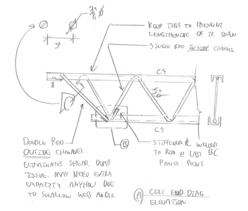

Originally, I thought that you were just using the couplers to splice together lengths of bent bar that were not the full length of the truss. I found that odd and clunky in terms of fitup. Now is see the magic. You did that so that you could customize the length of the last truss panel and bring the shear dump in close to the support.
Consider the alternative below having the following benefits:
1) Probably a simpler web splice.
2) The last TC panel length doesn't grow.
3) You eliminate the issue of shear dump into the channel web at the end.
4) You've doubled your web capacity at the last diagonal where the web angle will be shallower than normal and, thus, the demand higher than normal.

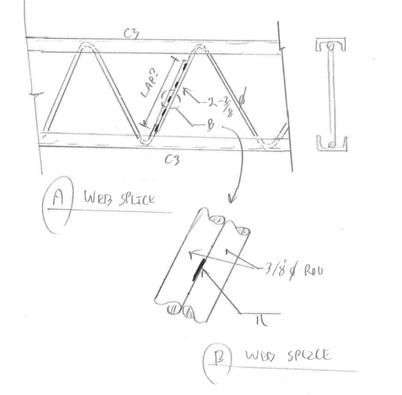

“ I found that odd and clunky in terms of fitup. Now is see the magic. You did that so that you could customize the length of the last truss panel and bring the shear dump in close to the support.”
Wish I thought of that in the original run. The couplers where an attempt to allow this thing to be broken up for field fab and shipping.
I'm making a thing: (It's no Kootware and it will probably break but it's alive!)
Damn it... presumed too much.
I feel as though you could get away with a web splice like this too. Yes, it does introduce some eccentricity. And no, I don't know how to prove that it's okay.

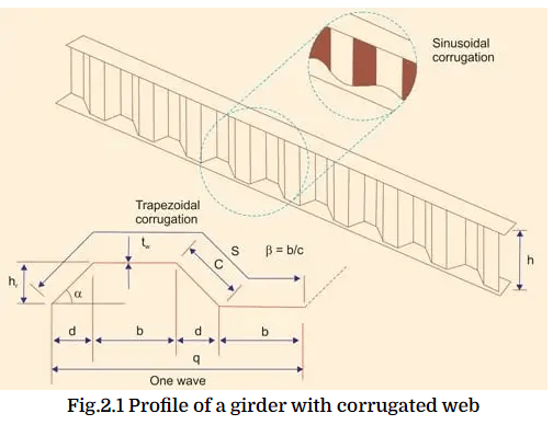

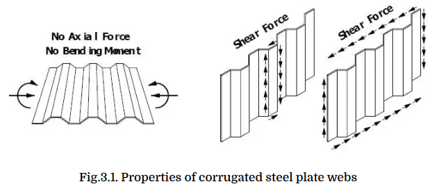

jayrod12 said:
dold's deck as web was my other one I feel if those were all intended to be bottom chord bearing, then it would be no different from I-joists in theory.
I agree, the root concept is mechanically sound. The corrugated web business already has history in the realm of steel bridge girders where it offers the following benefits:
1) With continuously welded boundaries, it's basically a pre-stiffened web as far as shear buckling etc go.
2) With flange connections on both sides of the web, you engage gobs of web flexural stiffness to torsionally tie the flanges to the twist of the global cross section.
My concerns with the CFM deck solution are centered around how that is different from #1 & #2 and what the associated implications of those differences may be.
