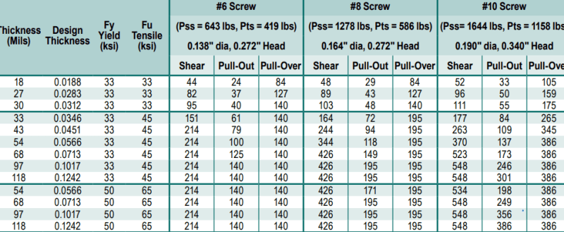

1) SCREW CONNECTION CAPACITY
milkshakelake said:
About getting maximum 8 screws into the connection: this will make it infeasible
Will it make it infeasible? The first graphic below leads me to believe that with 16 ga, 50 ksi material and 8-#10 screws, we could get about 4,300 lbs out of each web to chord connection. That would be plenty.

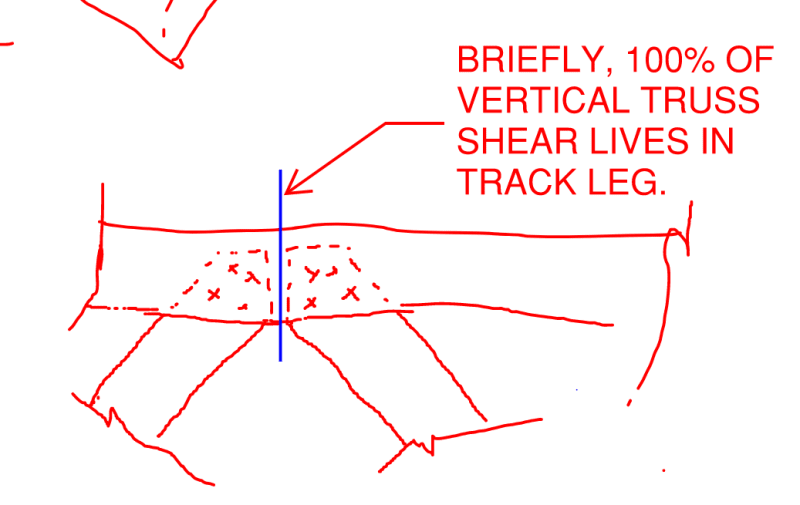

2) CHORD TRACK LEG SHEAR CAPACITY
The CFM setup has a feature that I initially considered likely to be problematic: see the second graphic below. For a short time, all of the truss vertical shear must live within the track leg. I originally thought that would be a deal breaker. I may be out to lunch with that however. If you do a shear yielding capacity check [0.9 x 0.6 x As x Fy), you get twice the required capacity. I suspect that there's also a shear buckling check that one could do that would likely be much more limiting. On the other hand, the presence of the connection itself does a fair bit to brace the track leg against that I would think. How to prove that rather than just assume it, I don't know short of testing.

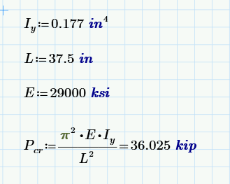

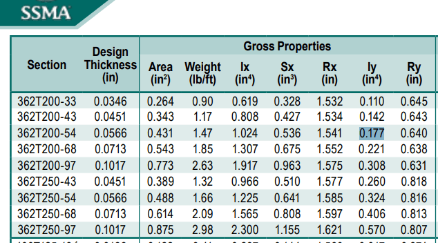

3) CHORD AXIAL CAPACITY
This is the one that I have the most trouble evaluating without a deep dive. Using a gross Ig rather than an effective one, the Euler buckling capacity again comes in well in excess of what I've estimated is required. See the last two graphics below.
This all strikes me as too good to be true but maybe I just don't have a good feel the capacity of CFM members.

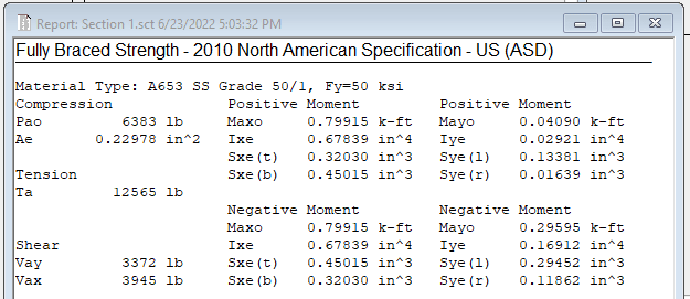

@KootK Regarding the screw capacity, that's pretty much in line with how I'd calculate it.
Regarding axial capacity, I did a quick run on a black box type program called CFS and got a compression capacity of 6.4 kips, much lower than yours.
Using heavier 12 GA track pushes the compression capacity up to 17.6 kips assuming fully braced. It's not actually fully braced, but I'd need to do a deep dive to get further than that...we can just say it's roughly 12 kips. 12 GA is still viable and screwable. 10 GA is where things get hairy.

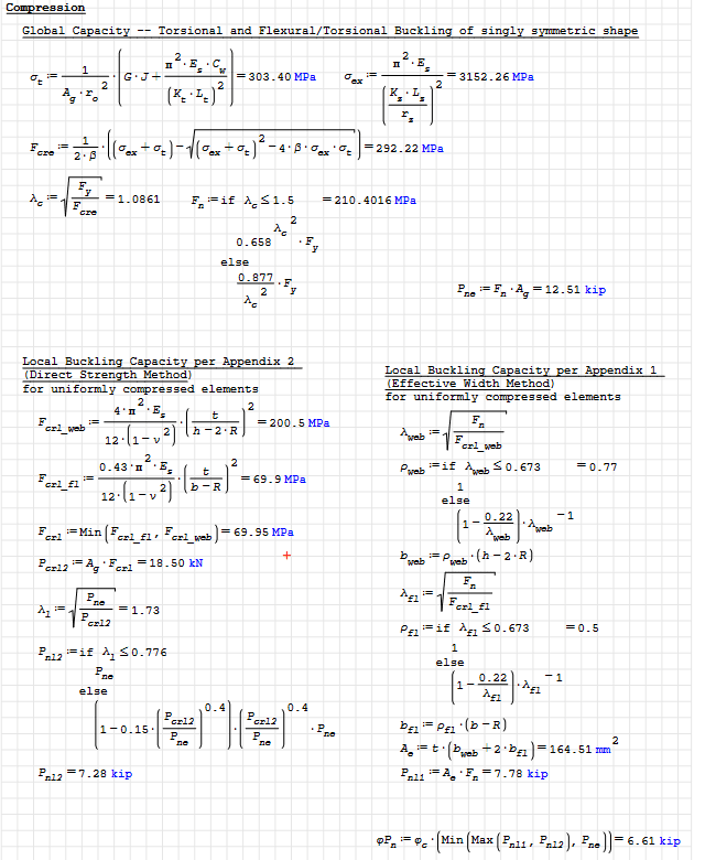

Sorry for the delay... I didn't have axial capacity in my sheet yet after all.
I also get about 6.6 kips capacity out of a 54mil track if the decking doesn't restrain chord twist (or 8.6 kips if it does). (My ignorance of the context shows -- which assumption would be typical?)
Going up to 12Ga, I get 16 kips unrestrained.
