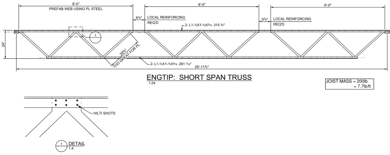

dold said:
Design fastening (PAFs) based on shear flow demand plus vertical/direct gravity demand? Heavier fastening towards the ends of the joist. Probably be best to have end diagonals to form a closed "megapanel".
Me thinks spot welds would be a more reliable fastening system with higher capacity likely.
The cold formed joist proposed by milkshakelake is great. The idea of cold formed trusses aren't new, just putting the same concept in a different application.
Using sheets of deck as your web is very clever and simple. I think I'd want some sort of testing to back up the design of this - no specific reason off the top of my head, just a gut feel.

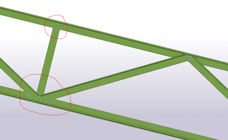

kipfoot, I love a good hand sketch...your last post with the angle cope is a great one. You could go with an unequal leg angle and reduce that eccentricity further, but that might put you into an odd-ball angle size that isn't readily available.
Koot said:
It seems to me that you'd need both a diagonal and a vertical at the end lest the truss itself kick a large diagonal point load into the decking. It's an interesting mechanical problem.
Concur. I can see a lot of (perhaps not-so-wasted) hours spent risa 3d'ing this thing. More as a thinking/visualization tool as opposed to a hard numbers tool in this case. And I bet some of the principles used in diaphragm design could be useful, but this is a much smaller component-level analysis so maybe not so much...
You and me both. And probably everyone else. Maybe the KootFund will be able to finance an ESR report.

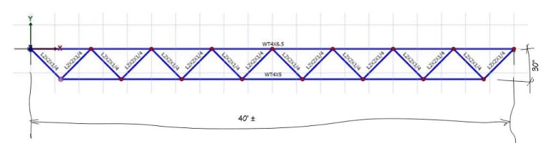

Brad805 said:
Notes:
1. Too heavy still.
2. Parts simple, and a jig would be easy to make.
3. Welds seem too light.
4. This is one of the lightest WT sections.
First, whatever system/software you're using is pretty dang cool. Also:
1. I think it's better suited to longer spans. I tried a 40' truss, 30" deep and it's around 15 lb/ft.
2. I'll take it.
3. If the webs are at a steeper angle, there's more linear inches for weld each side of the web, especially with a deeper WT
4. I like a WT4. I tried a WT4x6.5 top chord with a WT4x5 bottom chord. Equiv to a WT 2x6.5, but with more flange for welding.
Great discussion.

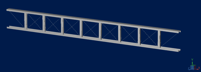

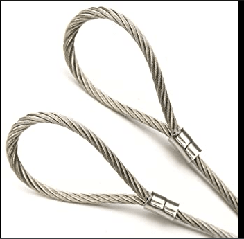

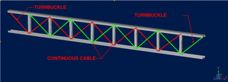

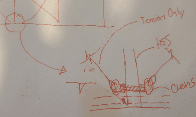

I'll throw one into the ring, tension only diagonals, maybe steel cables.
Top and bottom chords be a channel type shape like in Celt's example and the vertical member I was envisioning a vertical angle or HSS tube with some clevis type attachments for the cables.
S&T -
Hmm, two concerns to be mitigated with that one S&T -- I think you would end up fighting stretch in the cables (presumably new/unloaded) and in the connections (including the clevis passing through the wall of an HSS if you go that route).
Similar to what CanPro brought up wih bolted connections earlier, but I think on a bigger scale.
just call me Lo.
For the cable concept, I think you'd need some form of pretension to mitigate the issue identified by Lo. Maybe you could do the whole thing out of two separate continuous cables, each with a turnbuckle introduced at the end:
JoshPlum mentioned something about a collapsible joist for shipping. You could combine the ideas here - top/bottom chord pre-assembled with the verticals and the whole thing could fold down. Run the cables through the truss on site and tension it into its final shape.
I love these off the wall ideas...but to maybe keep this grounded a little bit, keep in mind that eventually it just becomes cheaper to pay for heavier framing and use a hot-rolled beam instead of a novel joist idea.
A couple super-quick, maaaaaybe not totally thought all the way through comments on the steel cable diagonal ideas:
1) You'd definitely want to pre-stretch the cable before rigging it into the truss (this should eliminate all the cable seating that produces so much relaxation in the cable).
2) From an analysis perspective, individual cables w/in each panel is MUCH easier. A continuous cable will have to have the same tension no matter where on the span it is.
3) I'm not creative enough for any good ideas re: how to make the continuous cable have the correct bend radius at the verts. Maybe you could fish a thimble through the pair of holes that you'll need in the HSS?

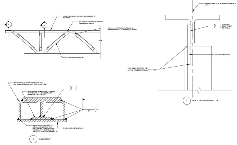

kipfoot, I agree the span in the example is too short for a WT chord design. I think field fabrication will be a very significant challenge. If there jig is not level or square you will end up with a bowed truss. Welders use a lot of clamps when everything is loose. I was trying to lower the part count and keep the parts simple. I pasted a view of a typical joint below. The model was done in Tekla. We have been using that since 2007, and that took about 1hr or so.

I humbly present to you The Jericho
EDIT*************************
The Jericho program has been scrapped. I was watching Charlie Wilsons War with my partner and couldn't enjoy the movie. All I could think about was how labor intensive my pre-fab is on this monster. I realized in trying to steer away from kipfoot's WTs I made it a worse version of KootK's. I will resubmit shortly (kinda like the 5 second rule)
Though I'll leave it up mostly as a historical curiosity but also because I think the bearing design is kinda sexy.

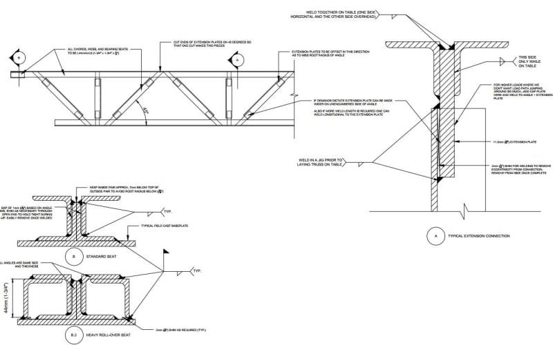

Reading note: Before you tell me that I've called up only fillet welds...when probably less than half are true fillets. I know but it was easy and I have to get on with my life lol!
Competition Note: I'll pony up an additional $50 USD for the cause. Under the condition that I may need to design / build a bridge overtop a repair area in an underground parking garage in the coming weeks and the dream team here must participate!
Resubmission attempt: Jericho Reborn
Pros
1 - All standard welds from easy to access locations on material that any fabricator would be familiar with
2 - There is so much room for slop since the fabricator can effectively put the webs anywhere along the length
3 - Truss assembly happens from one side only
4 - Painting is a breeze either shop or field
5 - Can be made from re-used material with plates made thicker to suit eccentricities involved
Cons
1 - Cutting the WT is more labour intensive than buying two angles. But you save on other aspects of the welding that are now super clean/easy.
2 - Heavy for small spans though a larger WT would probably take care of that
Link (note that this is the correct new version):

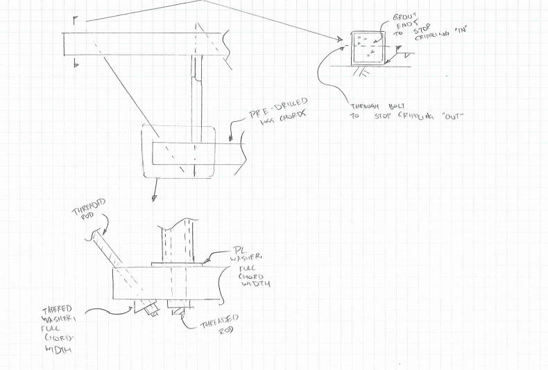

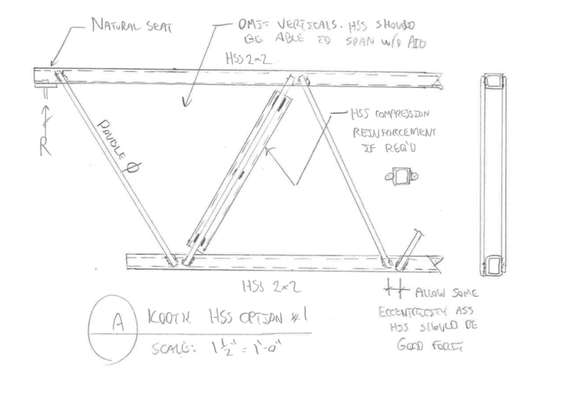

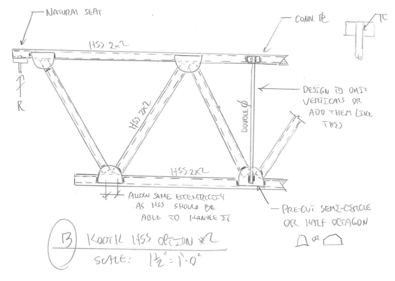

JoshPlumSE said:
My mind also keeps returning to the idea of using HSS tubes instead of WT's and Single angles and such. I know they're currently more expensive, but they also make really good trusses. Plus, architects and owners love the look. Maybe they'd be less prone to construction damage or erection accident.
Fundamentally, I feel that there must be at least one viable option for each type of steel cross section that provides the following:
1) Small scale section without post-processing.
2) Section provides flat surface for deck attachment.
So my mind keeps returning to some HSS option. I've proposed two options below.
PROS
- Natural seat can just be the tube itself. Add a bearing plate if bolting is desired.
- Tubes should be strong and stiff enough to span between primary panel points without intermediate verticals.
- Tubes should be strong and stiff enough to allow for some degree of panel point eccentricity.
CONS
- Heavy, particularly my second option.
- My first option troubles me with respect to the potential for unequal loads in the webs on either side of the truss.
- For the rod option, I don't love the idea of potential quality control problems with respect to the flare bevel welding.
FABRICATION PLAN
a) Set out the HSS.
b) Weld on the rods or gusset plates to on side.
c) Flip and weld the other side, CANPRO be damned.
END
If I were to order DIY OWSJ on Amazon:
1) I'd probably have to go with dold's corrugated thing because that's screws and I don't know how to weld in real life.
2) If I could weld, I feel that my option B below would probably be my most likely candidate for success.
Maybe optimize it with light gage HSS in the 12 - 16ga range and screwed connections.

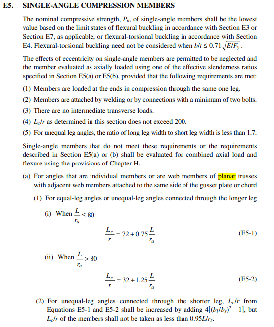

sbisteel said:
AISC disagrees, and E5.a in the specification actually calls for the webs to be connected to the same side.
Thanks for joining in the conversation and for drawing our attention to E5.a. I disagree with your interpretation however. I think that the correct interpretation is this:
1) Attach your webs to the same side of the chord if you want to be able to avail yourself of some design simplifications.
2) Attach your webs where you like if you explicitly design them for eccentricity sans design simplifications. The Full Monty as it were.
In the case of kipfoot's truss, I'm sure that we can all agree that:
a) The torsion generated across the thickness of the WT web would be minimal and;
b) The torsion from (a) would likely be easily rectified by the out of plane stiffness of any practically sized, incoming angle webs.

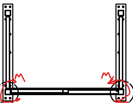

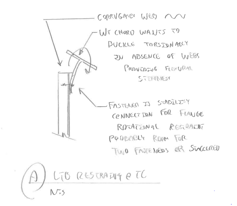

@dold: I have the concern show below for the corrugated scheme. In a normal truss with discrete webbing, the flexural stiffness of that webbing is relied upon to torsionally brace the flanges and keep their unbraced LTB length from being the entire length of the truss. For your scheme the corrugated sheet and its fasteners will have to do that same job in a distributed fashion. There is a load path available to provide this resistance, as shown below, but it's something that I feel warrants some degree of explicit attention and, ideally, testing.
KootK,
Is your buckling concern during fabrication? Erection? Installed and in service? I had assumed that we could assume a roof deck to brace the top chord out of plane buckling.
The only time I've depended on web members to prevent out of plane buckling on a truss' top chord is when designing a hand rail truss (local term, also known as a pony truss or half-through truss). Part of getting that to work, is that the web members generate a moment resistance at the bottom (see the snip below). For a roof truss, I'm not seeing how the bottom chord could possibly develop a resisting moment with the web members to brace the top chord.
