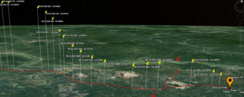

The real question - is that piece the cause or an effect? And will they find more parts?

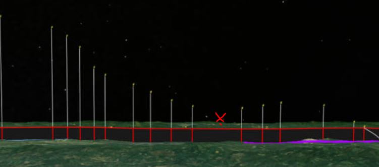

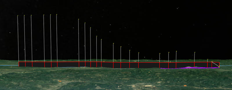

10 km is the lowest point in the flight path prior to the slight recovery. Still no indication though of whether structural issues caused the decent or just compounded the problem. It will make the search for distant broken pieces more intense.
The purple line represents 10km from impact. The red ground path is raised to the elevation of the last data point.
