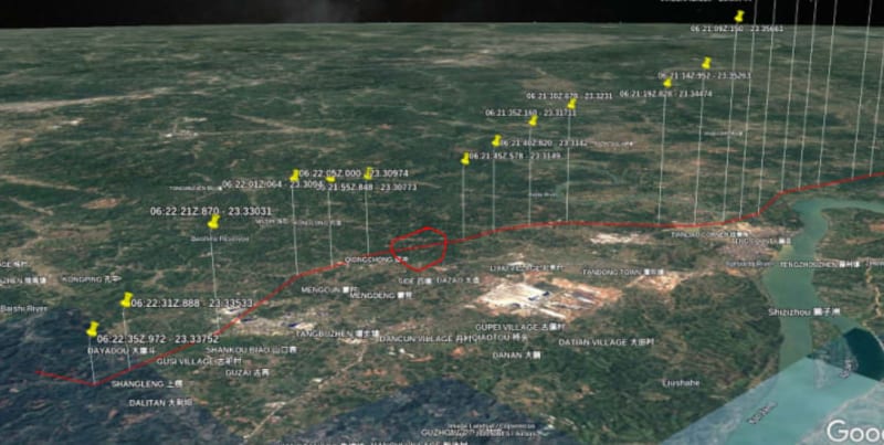

I thought the longitude and latitude were posted earlier; are these not correct? From the accuracy indicated it narrowed the space down to about a foot (not really realistic).
Since I couldn't read the whole article I am making a guess here.
The piece was found here ?
