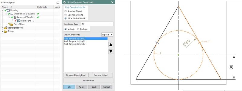

Hi everyone!
I was trying a thing: I made a 3D model of an extruded equilateral triangle, the circumscribed circle has a diameter of 12.7 mm (1/2 in).
I tried first drawing the same circle on another sketch and visualizing it on another layer, but it is showed as a solid continued entity, not a contruction entity. The second thing I want to try is to draw a construction circle on a sketch inside de drafting application, but I can't find a way to make the circle tangent to the three sides of the equilateral triangle.
How can I solve this drafting problem?

Hi -
I just tried a simple test....
1.create a Model part containing the triangle..
2.new drawing part and place the view of triangle..
3.new sketch belogning to the view...
4.geometric constraint tangent from the sketch circle to each leg in triangle...
lklo...
 https://files.engineering.com/getfile.aspx?folder=32b1aec6-0dbc-4f9d-8649-8c26891d7f07&file=circle_tabgent_to_triangle_based_on_Model_extrusion.JPG
The trick is that EITHER the circle OR the lines cannot be fully constrained. In other words, if you fully constrain the triangle, then ONLY constrain the circle to be tangent to the three sides. If you fully constrain the circle, than you cannot define the lengths of the sides of the triangle.

Thanks!
The solution given by lklo was the one I was looking for. :)
Hi again -
In NX10 - you should be able to constrain sketch in Drafting App - to Solid Lines from MODEL part...
I just tried this before - as per attached pic in previous mail...
MAKE SURE the sketch is inside the View...
