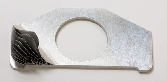

Oh yes, I've used laminated shims at times. But more often than not, the types of machines I designed, we'd send a 'bucket' of shims to the job site, made from scrape sheet metal, anything from 22 and 16 ga up to 1/8 and 3/16 inch.

Laminated shims are of benefit when the shim thickness gets much less than 0.002" individually Jim's under that size are very easy to damage with handling.
Those laminated shims are available in aluminum, which is what the OP wants.
Might even be able to water jet the finished shape from a stack of off the shelf shims.
