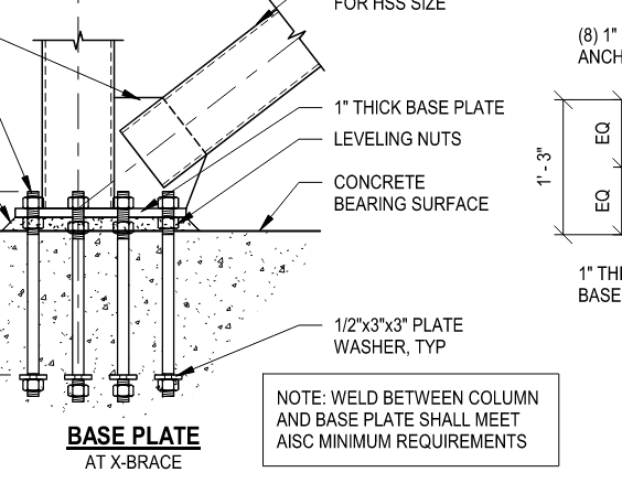

Probably beating a dead horse here but I searched and could not find a dumbed down version. I need a simple answer to the Note I see all the time on contract drawings for Column to Base Plate welds, IF the EOR even puts anything often it is just a note to use AISC Standard min. weld. Where do I find this again? Had an OLD pencil eng. onetime just told use as detailers to "Just use 5/16 Fillet for any column with a base plate 3/4" or thicker and 1/4" fillet for anything less. Looking for more up to date and simplified for a dumb detailer (myself) to understand.

This is what we get most of the time.
That's nuts. I just looked at a set of drawings from an EOR that I know produces good drawings. They point at these welds and put the size in the table with the base plate size.
The note on your screenshot refers to the minimum fillet weld size per the AISC Specification Table J2.4. The largest that could ever be is 5/16 in. That weld would provide a lot of strength even for uplift and shear, so it should be plenty the vast majority of the time.

For your screenshot, one new item is the weld strength directional increase [ kds = 1.0 + 0.5 sin(theta)^1.5 ] no longer applies for rectangular HSS.
AISC Table J2.4 Basically says to use 3/16 Fillet for HSS8x8x3/8 to 1 1/2" Base plate. Again, I'M NOT an Engineer just a Detailer but my gut says 3/16 won't cut it.

Because this is at a bracing connection, I'd recommend flagging it on your approval drawings and asking the EOR to confirm.
There is a good chance 3/16 in. is enough, but the presence of the brace makes it a lot less certain. Especially with that many anchor rods. That brace could have a large load in it. Usually the vertical component of the brace force is taken by the gusset-to-HSS column welds, which then gets transmitted to the base plate through the HSS-to-base plate welds. There's a chance this force could be large.

This line of thinking covers a lot of ground for gravity column base plates. It's probably evolved out of common fabrication-shop preferences. 1/4" fillet welds are often a shop-preferred baseline min weld size because they can be achieved via a single pass w/ various welding processes. Pretty similar situation with 5/16", but why waste the weld wire/electrodes if you don't have to on material 3/4" and thinner?
In East-coast delegated connection design, it's common for the EOR to design the welds btw the column and BP (and BP to shear lug), even at braced frames. It's always perfectly OK to verify this via RFI or email.

Jim Jr - check out the AISC code of standard practice, section 3.1.2. It lays out the 3 options for connection design. It sounds like this project falls under option 2. In that case, the EOR needs to provide a table with appropriate design information for you to pull from, or you need to be able to pull it from a design table in the AISC manual.
"Weld...shall meet AISC requirements" is meaningless. What requirements? That's their job to figure out. You could word your RFI like this: "EOR, please indicated AISC Steel Manual connection design table or figure to be used in selecting weld size." That way they can realize that there isn't one.
