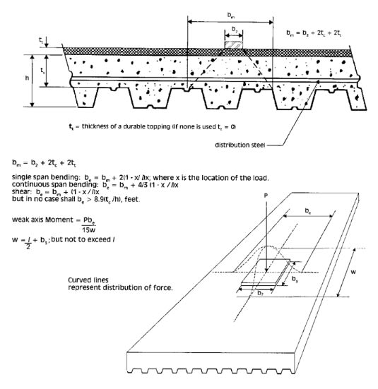

hello i am trying to analyze concentrated load on decking to beam force transfer
in particular concentrated load directly over beam
in a previous post someone referred to image below
for distribution of concentrated loads for deck slab design
Is it plausible to use the same for force distribution on the supporting beams?
Instead of image below
Perhaps this could be used (image below)
Reference for reaction calcs image below
Also could you refer to further calculation to incorporate the stiffness of the slab into spreading to adjacent supporting beams
in the scenario of concentrated load directly on top of the beam?

The intention was to mimic this procedure used to reduce the design bending moment for concentrated loads for slabs
considering 4inch support and 4inch thick slab
totally 12 inches

The narrow band is to conservatively capture the stress distribution suggested on the vendor's literature/drawing.

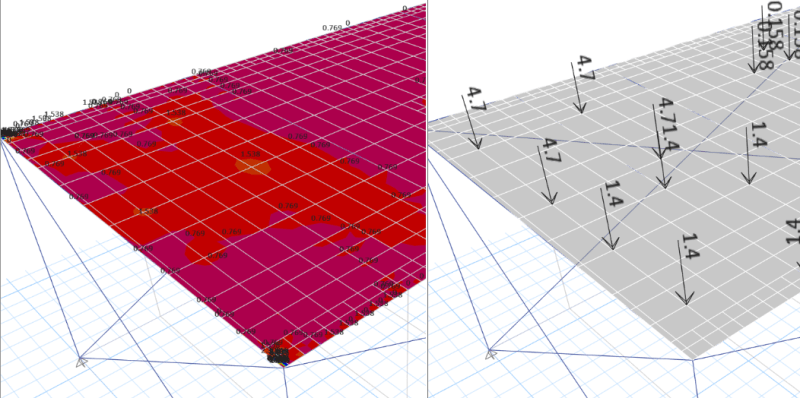

based on the fem model which i redid for the slab to cover entire bay
where in the load is distributed
The majority of slab is not overstressed
only the corners the stress values go up really high
this is NOT normal though right ?
Stress concentration, the corners are highly restrained.
Similar to the corners of floor openings, additional reinforcement/diagonal bars will alleviate the stress, and prevent diagonal cracks.
