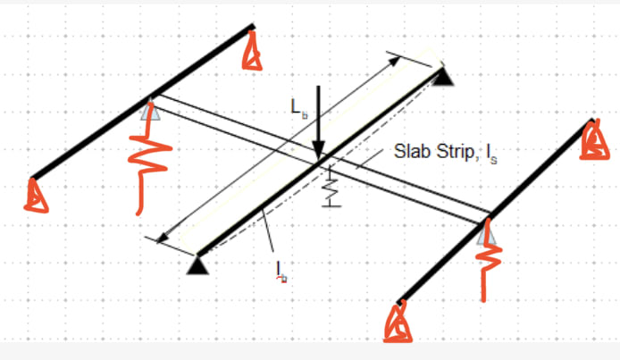

Also could you refer to further calculation to incorporate the stiffness of the slab into spreading to adjacent supporting beams
in the scenario of concentrated load directly on top of the beam?
for sure BA the 14 66 14 only represents the point load at the center of the beam
how would one find the stiffness of a beam at a particular point given multiple loadings?
i know super position would work for deflection but what is the procedure for stiffness
Pay attention to BA's comment. Somehow I started assume the concentrate load is on the midspan of the beam, thus, the deflection is, Δ = PL3/48EI, and K = 1/Δ. If it is located somewhere else on the beam, then you need to calculate the deflection, and the K will change. I hope you get the concept, and understand all the comments/call for cautions, rather than just working out for this particular case.
Wouldn’t this be a more realistic model, which I suspect will dramatically affect results..?
Also, would the slab not have to deform excessively to get the extent of sharing you’re looking for? As noted above, I’m not sure I’d be entirely comfortable looking for this degree of load share without shear studs. It would make a very interesting thesis!
How far out are you if you take the simple approach of load applied to one beam only?
Yes, K = P/Δ. But when calculating member/support stiffness, we apply an unit force, that is P = 1 to get the corresponding deflection. Don't confuse this unit force with the actual applied force, the applied force is used on the model after you have provided the stiffness parameter, "K". Sorry, if I have confused you.

I think however including pin supports at midspan of the edge beams in the model will naturally take load incorrectly away from the mid beam.
I’d still like to know how far out we are if we go with a simple PL/4 on the mid beam?
Yes. I agree with your thought, that we can assume the slab strip is supported by 3 springs.
IRE THANKS!

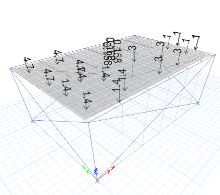

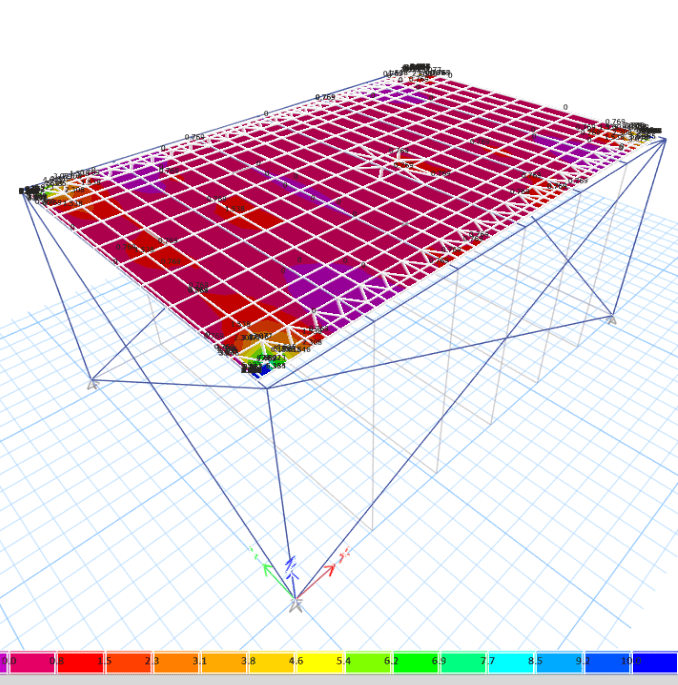

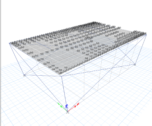

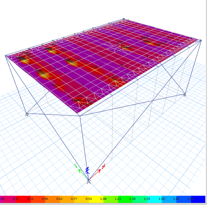

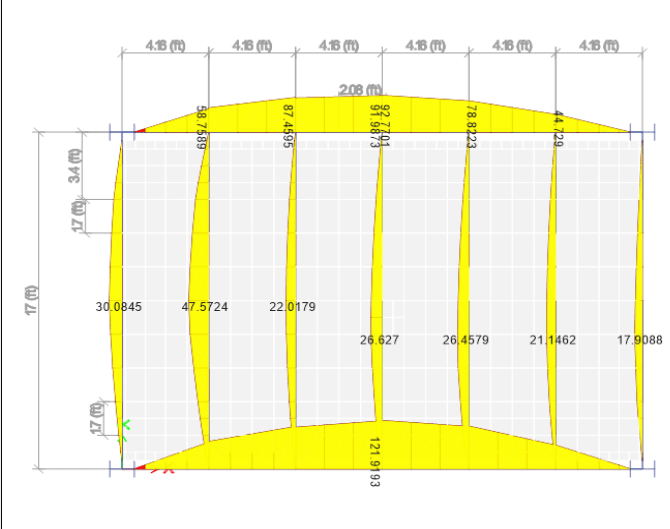

here is an illustration of what im getting at
DL + these below
MODEL WITH 4" THICK SLAB DISTRIBUTION FROM STIFFNESS
BM DIAGRAM FOR SLAB ( SCALE 0 - 10 KIPFT )
BM DIAGRAM FOR BEAMS
MODEL WITH 4" THICK SLAB NO DISTRIBUTION
BM DIAGRAM FOR SLAB ( SCALE 0 - 2 KIPFT )
The capacity for the secondary beams = 40kipft
with stiffness slab model second beam from left stays below 40
albeit the model is generating some high moments in the slab at the corner
second model has lower moments in slab
but the second beam from the left is over 40
was hoping distribution would stop this
corrected
bm for slab for 2nd model below

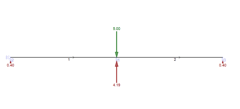

btw the model for 0.25 stiffness modifier for the slab with stiffness 48EI/L3 for 3 supporting beams
in the event of midspan
That is slab section taken as 12inches wide ( 4inch support + 2 slab thickness ) and 4 inch thick
E value modified by 0.25 to simulate 0.25 stiffness modifier as suggested by ACI for crack section
Yield these results
So the load distribution is 8 84 8
total reduction of 16pc @ MID SPAN OF BEAMS
for scenario
load distribution would reduce moving between midspan and either support
There is no question that the slab can play a role in load sharing when a point load occurs directly over a beam. It is simply not the kind of action that engineers like to rely on. In the life of the building, loads can change in magnitude as can their position on the floor.
Having said that, I am not clear on the reason for selecting 12 inches as the width of slab chosen. If load sharing is to be considered, it seems to me that the effective width of slab is much more than 12", perhaps more like 36", 48" or even more as the steel beam will easily spread the point load over a larger width of slab. And if steel deck is composite and continuous, the moment of inertia of the slab should include the full section, including projections below the 4" slab.
If the magnitude and position of all suspended loads was known with 100% certainty, I would agree with this procedure but, unfortunately, this just isn't the case.
