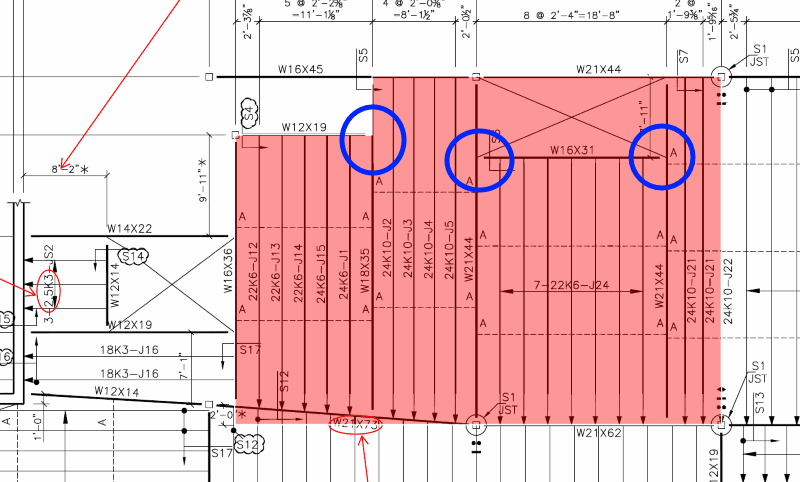

I am being asked to visit a project that was completed about 5 years ago. I designed the project. The owner called me today after getting my name from the architect. They said that late last week they heard a loud “bang” on the second floor “followed by what sounded like ice cracking. They are now concerned about the second floor of the building.
The existing structure is a single-story building with an interior mezzanine. A portion of the mezzanine is used for storage and the remaining portion of the mezzanine is used for general office. Construction is a 3” concrete slab on 9/16” form deck with open-web steel joists designed to be spaced at 2’-6” o.c. (this area actually ended up with open web joists at 2’-4” o.c.). The joists are supported by a system of WF steel beam and steel columns.
The owner provided me with a sketch of where they say the mezzanine has cracked (it’s terrible). From this sketch the cracks appear to be happening at the 1/3 points of the joists. Also according to the sketch the cracks are not in a distinct pattern (parallel to joists, perpendicular to joists and diagonal to joists).
It seems kind of odd that this would happen 4-5 years later. Does anyone have any insight to what may be happening before I make my trip to the site?

Specifically, suggest looking at the areas of the floor I've circled in blue. Possible discontinuities in joist defection. Also, for the same all along the W18 & @ W21 beams on those column lines.
[idea]
I am thinking an overload but that should be localized to the overloaded area. I get the impression from your original post the cracks are all over the storage area.
Secondly, maybe the cracks are not related to the noise they heard? I would suggest trying to establish a timeline of when the cracks were observed, hearing the noises and load changes on the floor.
I see a mix of 22" and 24" joists - might be worthwhile to verify they were all placed correctly.

Can't misplace the joists because they come fabricated to length. If they put them in the wrong spot then they won't fit.
There are a couple of beams on the plan which seem to stop in midair, a W18x35 and a W16x45. Hopefully, that is not the case.
SteelPE - I see now I jumped the gun - I did not notice the skewed beam at the bottom of the joists.

What’s happening at the top of the image where section mark S5 is? The w16x45 appears to stop?
The W16x45 continues over to the column. What you are seeing are the joist shop drawings which gives the as-built joist spacing.
I think KootK's theory is plausible. If the area had historically been lightly loaded, the slab could have been spanning from girder to girder and bypassing the less stiff joists without a problem. Then along comes a heavy load and suddenly the slab cracks (big bang, cracks parallel to joists) and the load is now applied to the joists instead of spanning over them. So now the joists are deflecting under the live and and the slab cracks some more to conform to the new deflected shape of the joists (the ice breaking sound, cracks across joists at 1/3 points).

So I made my visit to the site today. I spent about 3 hours onsite. I spent about 1/3 of that time doing a quick walk through and talking to the owners. I spent the other 2/3 looking at the floors and documenting just about everything I could.
The underside of the floor looks really good. I measured 3 separate joists. Two side by side where they heard the loud noise and another under the area where they keep their files. I measured from the distance from the bottom chord to the floor at each end and in the middle (I understand this isn’t fully accurate, but it’s the best I am going to do). 2 of the 3 joists appear to be flat all the way across, one joist I measured as being down 3/8” in the middle. SJI has the camber for these joists as being 3/8” so we are looking at a max ¾” deflection under total load. This equates to a total load of about 100 psf….. which is less than the 175 psf the floor was designed for.
I next looked at the cracks in the storage area. They varied from 0.025” to 0.04” in width. They basically mirrored the WF beam supports on the underside of slab. There were other cracks in the slab that ran perpendicular to the joists (roughly every 7’-0” o.c.) with a few cracks that just went off in random directions. Most of the wider cracks didn’t look new and the smaller cracks it was hard to tell.
Loading in the storage area was pretty light, if I had to guess (before running numbers) I would have placed a load of 20-30 psf on the slab.
Finally, we finished at the room they used for file storage (that was outside of where we had designated for allowable storage). Here they had 1’-8” wide x 3’-6” long 5 drawer high file cabinets. I couldn’t specifically measure the weight of the cabinets, but they did have bankers boxes filled with papers shoved against the wall. I estimated that there were 3 boxes per drawer. I measured 4 bankers boxes at once 3 separate times coming up with a weight of 32.5#/box. With this I estimated that their cabinets weighted about 550#.... this equals 94 psf…. However the cabinets were laid out in rows perpendicular to the joists….. in the end, I estimated the load in the room to be approximately 50 psf.
So from what I can tell, I have no clue on what was causing their issues. I saw nothing on the loading side and no evidence of damage do the building (no stuck doors, no cracked drywall…..even where the drywall was cut around the bottom chord of the joist at midspan of the joist…. There was no damage to the drywall). So I have no clue what they heard.
