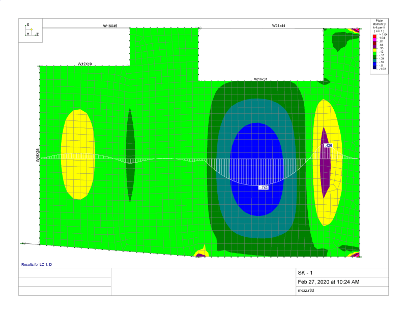

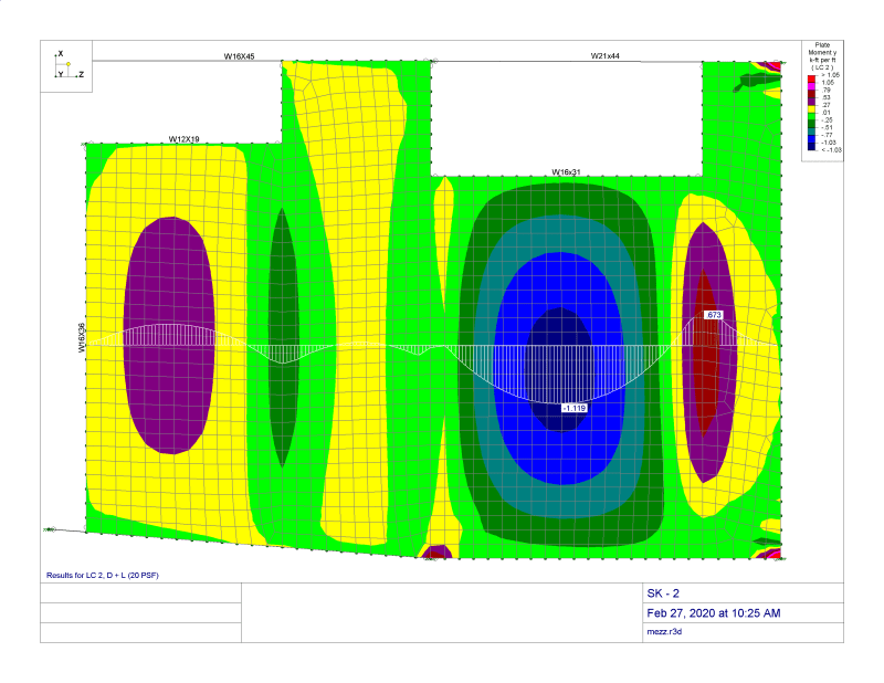

Say the slab is 3" NWC f'c = 4000 psi. Modulus of rupture can be estimated as fr =5(4000)1/2 = 316 psi. Section modulus = (12")(3")2/6 = 18 in3/ft. Estimated cracking moment Mcr = frS = 5.688 in-kip/ft = 0.474 ft-kip/ft.
I did a quick RISA model with the joists omitted and ran a self-weight only case and a 20 psf live load case. The results show that it's within the realm of possibility that the slab could span between girders elastically up to a certain amount of load.
Attached the RISA file if anyone else wants to mess around with it. You could also model virtual joists based on the load-dependent moment of inertia of each bar joist and see what kind of load distribution you get.

I understand what you are saying. Add in the fact that the system is probably stronger than what you even show. In order for the span to span between girders deflection must happen. During the initial concrete pour the deck can't span between the girders to the slab ends up bearing on the joists. As the slab is loaded the system will deflect increasing the load in the floor joists. At this point, the slab is trying to force continuity between the joists and the girders..... until cracking occurs and then the joist end up taking the full load.
I think this is a possible scenario in a world where shrinkage cracks do not occur. Some of the observed cracks were old so I don't necessarily think this is a possible scenario.

I guess I was being too conservative with the slab taking it's own self-weight in the analysis. That stress would already be locked into the deck and joists. So the live load only stress in the slab would be much less than what I show above. So yes the structure would be starting in an initial deformed shape, but the slab could still span across once the concrete cures and resist any superimposed loads in that fashion.
Shrinkage cracks are almost a certainty since there are a few re-entrant corners (and I'm assuming no control joints). Maybe even the weld washers cause enough restraint to induce shrinkage cracking. But this whole thought experiment is based on the premise that there was some type of sudden cracking event that the workers described. So if we accept that actually happened, then I think shrinkage cracking would be secondary and maybe explain some of the older hairline cracks.
Even if this unintended spanning theory turned out to be what happened, it doesn't mean the structure has a design problem or performed poorly. I wouldn't consider a little load redistribution to be a structural failure. It is pretty fun sometimes to noodle on theories on concepts online here, especially when it's not my project. I tend to learn a lot that way and who knows, maybe it will pay my bills someday.

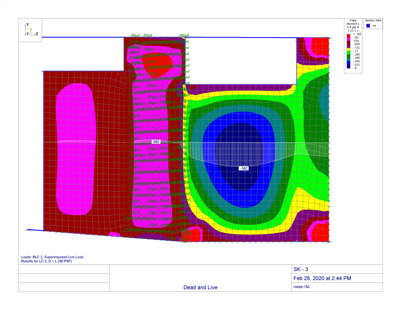

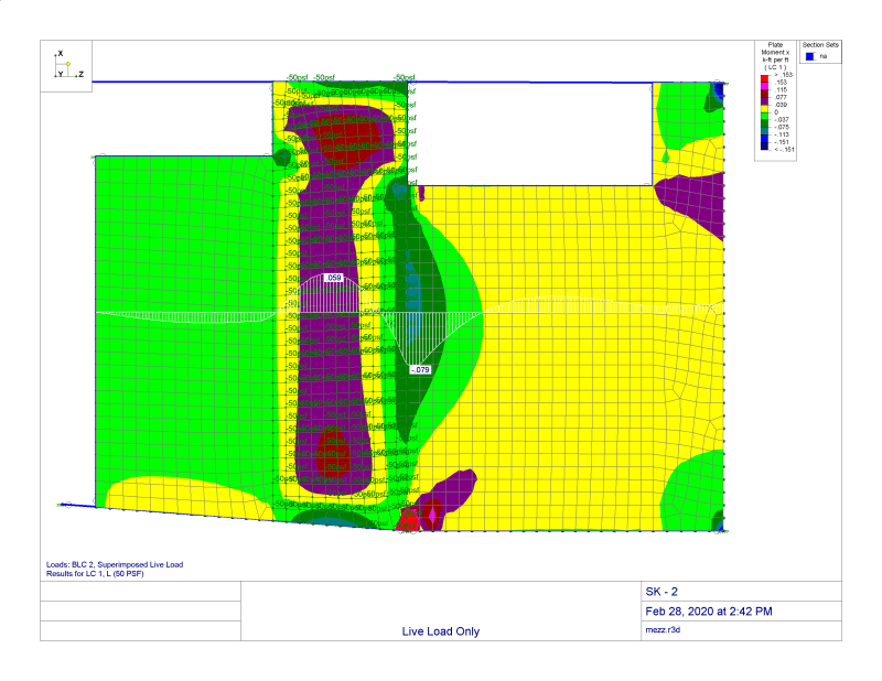

Can you check unbalanced load condition, with a limited area loaded with the maximum file weight (50 psf, or 90 psf), and the adjacent area without any load in addition to slab self weight. Can be interesting to see the effect due to positive span moment.
While the theory of shrinkage crack is plausible, I still think there are some other possibilities that causing the randomly orientate cracks, especially given considerations to the method of construction - wet concrete on form deck that less likely to lose water than concrete on other type of formworks, or on subgrade; and the construction of mezzanine floor usually occurs after the building envelop is up, thus the temperature effect is less a problem. So I suggest to evaluate unbalanced load conditions (using actual load conditions - heavy storage load locally, no live load nearby) to check the effect of potential moment reversal. Not necessary happening, but worth to look into.
retired13 - is this what you were looking for? I also ran a case with superimposed live load only if we were to assume all the dead load stress was taken by the decking and framing.

Thank you very much for going extra mile to verify my concern, although the result wasn't as anticipated. So the localized storage has very limited effect on the slab.

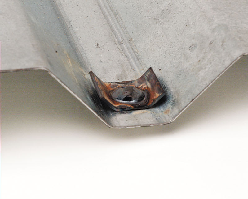

3) In my head I see the loss of composite action via an "un-peeling" of the deck being a good candidate for the ice cracking noise observed by the tenants. You know, if they're not full of crap to begin with.

I have no idea what sound a slab unpeeling from a deck would sound like, but I can believe that a nominal amount of composite action can develop then fail after a certain point. The weld washers could act as little baby shear connectors that could perhaps locally crush/crack the slab at a certain load level. Or maybe the washers would fracture off the weld first, releasing the composite action. For such a simple structure, the serviceability aspects are pretty interesting and complex.

A high pitch popping sound, when an area of steel deck separated from the slab in a sudden manner, and breaking of the concrete, I guess.
Delaminating decking seems a reasonable suggestion for an ice cracking noise.
