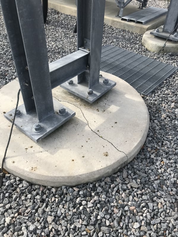

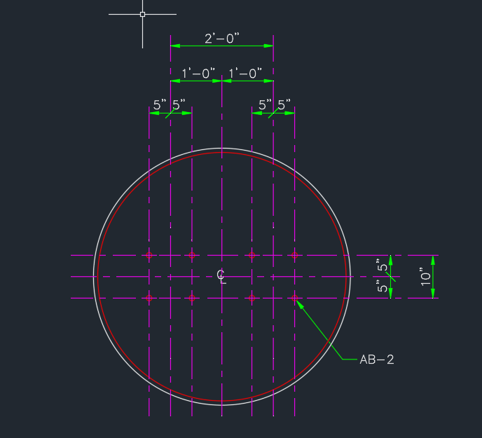

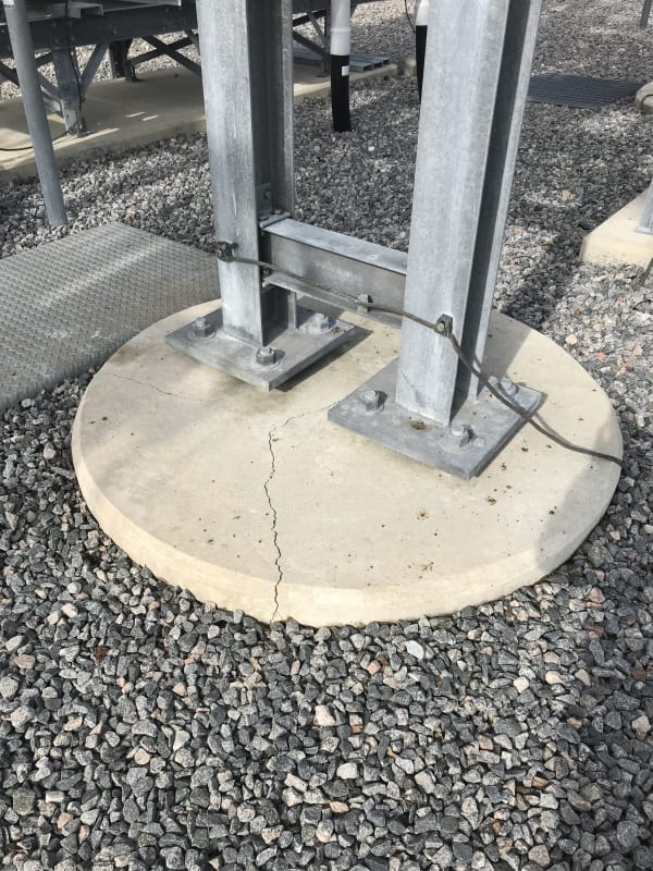

What can cause this type of cracking? My first guess is lack of adequate shear reinforcement or some eccentric loading based on the anchor bolt/column configuration. The piers were constructed in 2009 and designed by someone else. Piers are 5'-0" in diameter with #4 ties at 12" O.C. vertical reinforcement is (8) #7 rebar equally spaced.
Also, have no concrete pour data, break reports, foundation specifications, or soil data available.
Another possibility to consider is that the two posts have experienced forces in different magnitude. Depending on the arrangement on top, one post might have seen larger load than the other, that created overload locally. Note that the posts each stands on its own base plate, at times they can act independently, especially under lateral load/movement conditions.

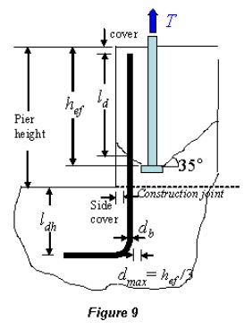

Could this be some sort of anchorage failure?
Maybe the vertical 18 #8's are not fully developed at the top of the pier where the anchors pass their tension to the pier?
I'm not sure what a crack pattern from that type of failure would look like though.

Could you please provide us the picture of the superstructure and "Just if you have" the reactions at most critical pier/damaged the most (widest cracks) pier?
Have you measured the width of cracks?
Also, may I ask what part of US are you located (I assume by the unit of dimensions provided you are in US)? Any sever weather condition?

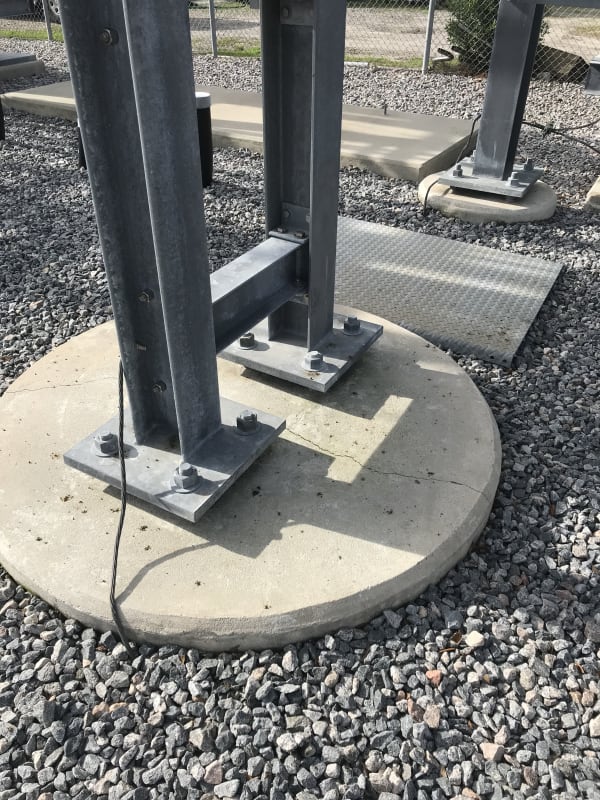

And in one of the pictures I see a grating by the pier!!! Whats that grating for?

Definitely a thermal/restraint issue. Similar to the problems with low railings on guardrails. I’d remove the cross beam and inject the cracks.

My guess is the concrete cracked before the bolted connections slipped. Crack pattern looks like an anchor group shear breakout cone, in two directions simultaneously.
We don't really know the answers to that, retired13. But your query raises another possibility, that the cracks could have occurred during erection of the frames due the base plates being forced onto the anchor bolts. But you would have to wonder why no one asked about the cracking for 10 years.

To answer a couple of questions:
[ul]
[li]I am working on getting more pictures of the steel structure above.[/li]
[li]Haven't been to the site to measure the width of the cracks yet.[/li]
[li]The grating by the pier is for a person to stand on for operating some electrical equipment.[/li]
[li]The site is located in the outer banks of North Carolina.[/li]
[li]These issues seem to go ignored for a while because mostly electrical engineers manage the sites and they don't raise concern until it's fairly obvious.[/li]
[li]The steel was erected in 2009 and not sure when the cracks started developing.[/li]
[li]The anchor bolts are 1.25" in diameter with 2'-0" embedment with a 6" projection for a total length of 2'-6".[/li]
[/ul]

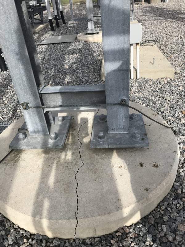

Another thought - the holes for the anchors in the base plates are undersized, anchor placement is slightly off, and the contractor just jammed the supports onto the anchorage. If the bolt holes are db + 1/16" like for structural steel, you'd expect the anchor groups to possibly be 1/8" off in plan, and you could build some restraint there.
Either way, for a repair, epoxy the cracks and try and release the restrain if possible.

I would also concur with KootK that water freezing in the crack could have expanded the original thermal crack widths. I believe they’ve had periods of sustained freezing weather in OBX in recent years.
I thought about concrete shrinkage as well. Perhaps if they used two anchor template plates that were rigidly connected. But I think the crack pattern would look different if they were shrinkage-induced.

To acer49: I suggest to do a little digging on one of the pier to exam the extend of crack below. It may provide more useful information.

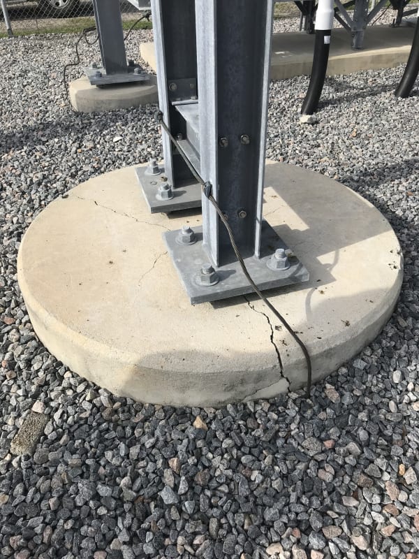

Is it possible that they were installed slightly off and the contractor used some sort of device to spread the columns apart to fit the bottom beam in?
Time has played an effect with the width of the cracks. Narrow at first, but any debris which falls in will prevent the crack from closing...repeat a lot of times.
Is the short beam near the base acting like a fulcrum? Do the columns both move together, or can one drift different than the other? The columns appear battered to me.
Also, do you know if your hoops are lapped correctly?
