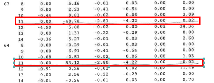

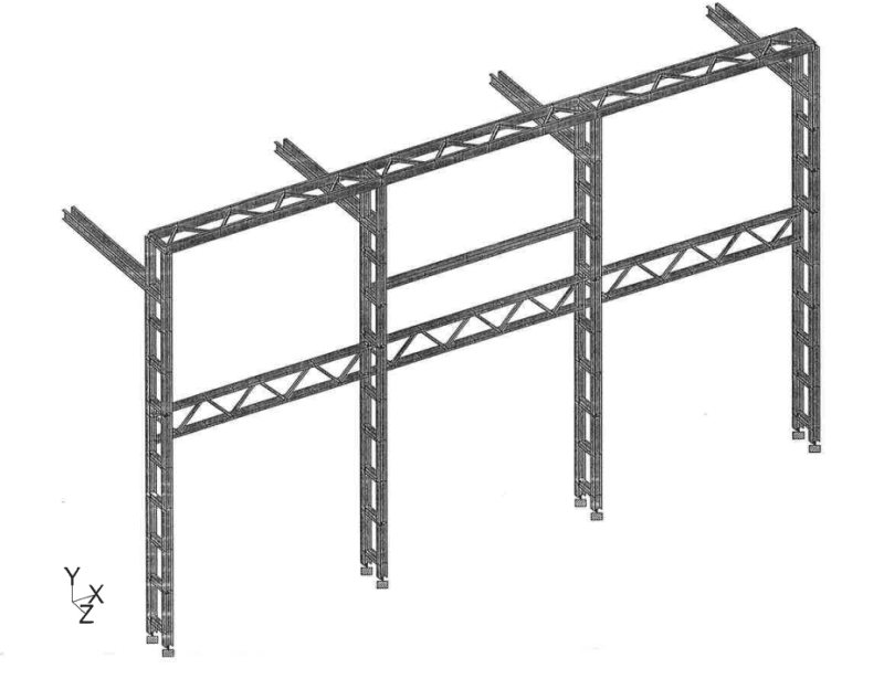

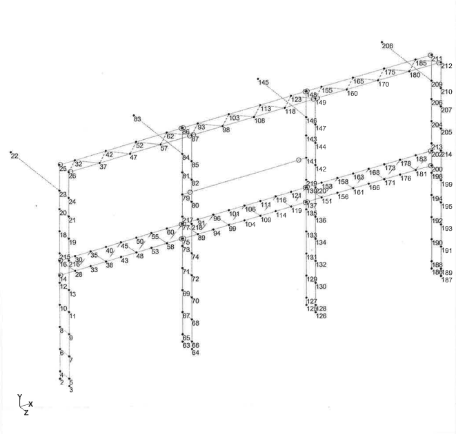

Here is the 3D model of the structure and still waiting on site photos. Also, here are the reactions Nodes 63 and 64 would be the (2) columns on the the (1) pier foundation.

The huge Mz in LC12 is intriguing. Do you know what is the load case?
Extreme Wind in the X direction is LC12.
The headers for the reactions in this order: Joint, LC, FX, FY, RZ, MOM-X, MOM-Y, MOM-Z
Jt 63 has a negative Fy (-48.78) while Jt 64 has a positive Fy (53.12) What is causing a couple of that magnitude about the X? At the same time, the MXs are identical.

The wind load in the Z direction and there are concentrated loads in the Z direction as well. This is some sort of cantilevered steel structure.
Can you label jt63 & jt64 on the 3D model? I guess each is at the base of column in the built-up structure. If so, the large +Fy/-Fy make sense. Please verify, thanks.
