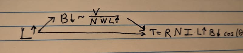

I'm posting a figure to try to outline the relationships/variables that I see as relevant, because maybe it explains my point better than all my rambling words.
There are three variables (L, B, T). L is considered an independent variable (input). B and T have equations. Arrows are drawn to show where one variable affects the equation of other variables.
Of course the important part of the figure is there are 2 different arrows leaving L, one of them goes to change B but the other goes directly to T. So there are two ways that L affects T, but I think you are only considering one of them.

B has units of Tesla = volt*sec / m^2
B x I has units of (volt*sec / m^2) *A = (A*volt)*sec/m^2 = (watt*sec)/m^2 = Joule/m^2 = N-m / m^2 = N/m
Newton/m... that sounds like force per length.
(And indeed that's what we already knew since F = qVx B = I L x B, so F / L = I x B.... so I x B gives force per length. Yup.)
If I had a loop I might be interested in the torque. So I'd multiply by the radius.
R*F / L = T / L = R * I B
The units are now newton-meter per meter. Torque per length on a loop. Sounds kind of like what Bill was talking about.
I wonder how we would convert FROM torque per length TO torque. Multiply by length maybe? Apparently you don't think so. I'll be interested to see how you make the units work out when you answer the question of how to quantitatively estimate torque.
To recap I am waiting for one or both of the following:
[ul]
[li]1. What equation would you propose to use for torque instead of the equation that I provided?[/li]
[li]2. If you had to quantitatively estimate torque developed by a given motor given B and I, tell me how you would do it, including what other parameters would you need. (Are you really sure you don't need L?)[/li]
[li]3. EDIT - BONUS QUESTION. Let's say I have 2 loops carrying the same current in the same field, each one similar to this. The only difference between the two loops is that one is 1m long and the other is 10m long. Does the 10m loop experience the same torque as the 1m loop? (PS - if you are looking for R and L within the link I just posted earlier in this bullet, they are hidden in area A = 2 R L)[/li]
[/ul]
