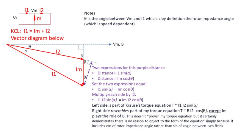

Attached is a vector diagram which proves that I1 I2 sin (alpha) = IM I2 cos (theta)
WHERE
[ul]
[li]alpha is angle between I1 and I2[/li]
[li]theta is angle of the rotor impedance (which is the angle between Vm voltage and I2 current).[/li]
[/ul]
Left side is part of Krause’s torque equation T ~ I1 I2 sin(α)
Right side resembles part of my torque equation T ~ B I2 cos(θ), except Im plays the role of B.
This doesn’t fully “prove” my torque equation is the same as Krause's, but it certainly demonstrates there is no reason to object to the form of my equation simply because it includes cos of rotor impedance angle theta rather than sin of angle between two fields alpha. The fact that B is not present in the result is expected given the circuit used (B is not a vector within this circuit although we know its angle matches Vm). To use the results of the vector diagram to generate full proof that my torque equation represents the same thing as Krause's torque equation would require careful examination of the other constants used in the full equations... I suspect that can be done but I don't foresee myself spending the time to attempt that. So I will leave it there (*)
I would also note the left side does have an intuitive appeal as alignment of magnets, while the right side would have intuitive appeal as Lorentz force which acts at radius R to produce torque if we substitute B for Im.
Going back to my earlier post 21 Mar 23 20:46 using vector cross product I now think it was correct in certain respects and incorrect in certain respects:
[ul]
[li]It was correct to easily demonstrate I1 I2 sin (α) = Im I2 sin(β) where α is I1 I2 angle and β is Im I2 angle (this is exactly the same as the conclusion of the vector diagram noting that β and θ are complimentary and therefore sinβ =cosθ... but we had reached that conclusion with a few simple cross products rather than all that complicated vector diagram and trig!). That in itself is an interesting transformation and explains some of the variability in which variables appear in textbook torque equations (some have I1 and I2 and some have Im and I2). [/li]
[li]It was not correct to conclude that alpha was related to theta by a pi/2 factor. Theta does carry similar information as alpha in terms of the angle whose sin is needed to compute torque from two current (or field) quantities, but the selection of currents is different and the angles don't have the simple pi/2 relationship that I suggested.[/li]
[/ul]
(*) Why am I leaving it there? I don't believe my torque equation requires proof from the vector equation since my torque equation was already proven by direct comparison to Liwschitz Garik textbook with copy of relevant page attached to my post 21 Mar 23 02:34 (if anyone wants me to walk through an algebraic proof that they're the same, let me know). Also the logic for the equation was clearly shown in an earlier linked paper posted 7 Mar 23 14:21. Being intimately familiar with that paper I firmly believe it's a proof, and it's really simple to understand if you accept the use of Lorentz for this purpose, but you might have to invest some more time to understand why that is an appropriate approach given that the conductors are shielded from airgap flux by the slots, and the force acts primarily on the core.... there are many different proofs of this given in the paper and also excerpts from many texts in the back of the paper which attest that using the force on conductor equation along with Bgap gives the correct result. The paper also includes calculations on an example motor which matched the hp rating pretty closely (based on FLA adjusted for number of parallel circuits, nameplate speed, and the other equation variables B, N, L, R). If anyone has data for a motor they want to try it out on, feel free to post motor details and we can try it out on your motor.

electricpete said:
The one I call the Krause equation is T ~ I1 I2 sin(alpha). It roughly corresponds to the interpretation as 2 electromagnets with an angle alpha between them. It can apply to many types of machines (including induction motors) with suitable choice of fields or currents.
One thing to add, per the vector diagram above we have 3 different expressions that are equivalent:
[ul]
[li]T ~ I1 I2 sin(alpha) = Im I2 sin(beta) = Im I2 cos(theta)[/li]
[li]...where alpha and beta are angle between the two currents in their respective expressions... and theta is the speed-dependent rotor impedance angle[/li]
[/ul]
electricpete said:
… as you increase the load the endpoints of the vectors I1 and I2 on my diagram will move mostly to the right and slightly down but the vertical distance between the endpoints would decrease slightly... so if anything the angle alpha might get a bit smaller as the load increases. Of course we do have a maximum torque on the torque speed curve attributable to impedance magnitudes and angles that both vary with speed, but it’s not tied to the angle alpha reaching 90.
It's interesting that the angle alpha decreases with increasing load. At first glance that seems counterintuitive if you're visualizing something like two permanent magnets. But of course we have something more like two electromagnets whose strength can increase, so the angle is not the whole picture.
So I wanted to do a sanity check to see if this decreasing angle plausibly explains a test case. The test case I looked at is neglibly small leakage reactances. It's not necessarily realistic but it's easier to analyse to see if the results make sense. In particular I wanted to see if the model predicts that at high load the current will approach a linear relationship with torque. With the negligble leakage reactances then the endpoints of I1 and I2 are moving purely horizontal to the right and the angle alpha clearly gets smaller. So does T~I1 I2 sin(alpha) become linear with current? We know alpha is decreasing but I1 and I2 are BOTH increasing, so at high load torque approaches something like alpha * I1 * I2, so the coefficient of I1 is alpha times I2 where alpha is decreasing and I2 is increasing. Is that approaching linear (constant coefficient of I1)? I have no idea....
...BUT if I simply look at the equivalent form T ~ Im I2 sin(beta) in the same scenario (low leakage reactance, increasing load, the endpoints of I1 and I2 vectors move straight to the right), we see beta approaches 90, sin(beta) approaches 1, we know Im is relatively constant (low leakage reactance) so it's easy to see with this version of the formula that this model predicts torque will approach a linear relationship with I2 at high loads. And since I2 approaches I1 at high loads, we also conclude linear relationship of torque vs I1 at high loads (as expected).
So in my mind, the equations do what I expect them to do in this test case (which is not necessarily representative of a real motor). And it's handy to have multiple forms of the equation.
(I probably could have concluded that the angle alpha between rotor and stator current goes down with increasing load by noting that any difference in angle is attributable to magnetizing current in the stator branch, whose contribution diminishes relative to load current as we increase the load current, but I wanted to explore the use of these torque expressions)

For anyone paying attention to my vector diagram, I think I need to revisit the polarities of my variables. I made a choice to label I2 polarity such that I1=I2+Im. But there is another choice to label the polarity of I2 going left towards the Vm node, such that I1 + I2 = Im. It would change the diagram quite a bit.
At any rate for this thread I want to caution anyone to be careful relying on my diagram. I'm reasonably sure that a revised vector diagram would still support the same conclusion that T ~ I1 I2 sin(alpha) = Im I2 cos theta (it can't be a coincidence that my diagram supported that). That was the main thing I was trying to do with the vector diagram.
