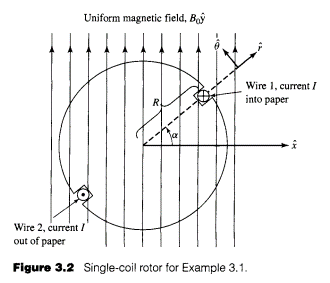

This link shows Example 3.1 from the textbook "Electric Machinery" by Fitzgerald which solves torque associated with a single coil rotor (as shown in Figure 3.2) below:
For context, someone has uploaded the entire Chapter 3 of the same textbook here
The last line of the solution of Example 3.1 from Fitzgerald's Electric Machinery gives the following:
His torque equation is:
T = -2 I Bo R L sin (alpha)
Let's compare to my torque equation
T = B I cos(theta) R N L Kdp
What do they have in common:

[li]Fitzgerald uses angle alpha to represent instantaneous angle between the loop and the field. I use theta to represent the spatial angle between the fundamental current wave and the fundamental flux wave. Due to the defined labeling of the angle alpha, it represents 90-theta. sin(90-theta) = cos(theta). This factor plays the same role.[/li]
[li]The N in my equation takes the place of the 2 in Fitzgerald's equation. In my earlier linked attachment, I defined N as total number of conductors in the slot section. For Fitzgerald's loop, N=2.[/li]
[li]Fitzgerald's equation does not include Kdp. It is not needed since Kdp=1 in his geometry where there is only one coil with full span for a 2-pole configuration. [/li]
[li]Fitzgerald's sign has a minus sign to indicates a polarity of torque. My equation does not assert any torque polarity.[/li]
[/ul]
As you can see they are basically the same equation. Including the factor L for length.
