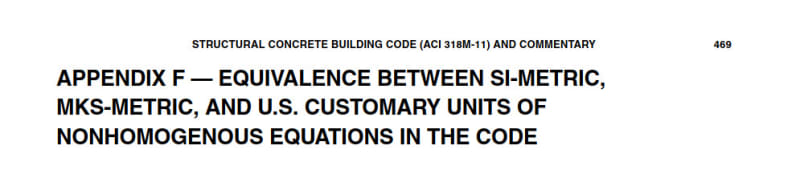

I have this formula from ACI 318-02 for the basic concrete breakout strength Nb = k*(fc^0.5)*(hef^1.5). I am thinking how this formula will led to a result in unit of force (kip)?
This question arises when I tried to use this formula as a reference to double check the concrete breakout strength using the standard in my region which is in English units and the 'timing' of converting the units leads to different results!
For example, say if I have k=24, fc=25MPa and hef=100mm, if I put these values into the formula without converting to metric ones then I will have the result of 120kN (which is 26.98 kips).
However, if I convert the units of fc and hef to psi and inch and then put it in the formula then the result will be 11.2879 which is 50.2kN. Can anyone explain which way is the correct one and why? I am confused...
You should get a metric version of ACI318!
In the 2018M version, the k factor is shown as 24 or 17 for imperial units and 10 or 7 for SI/Metric. Presumably it is because the formula is not dimensionally correct, with (N/mm2^0.5)*(mm^1.5) not resulting in KN or kips!
your formula is located in Appendix D parag D.5.2.2 and the explanation probably in Appendix F
Thank you guys. I was looking at the old ACI 318 where no si-metric units appendix was included.

If you are switching between imperial and metric, make sure the equation is right (the non-dimensional coefficients will change) and apply conversion to each unit, not just the result.
Dik - your example gives the same wrong result as quoted in the OP.
If you want to use the k from the imperial code with metric input you need to assign the correct units to the k factor, or use the k appropriate to your input units, i.e. use the metric version of the code and make sure your input is in the same units as used in the code formula; stress in MPa and length in mm with results in N.

That's the point; the k value does have weird units, so if you don't use the units assumed in the code you will get the wrong answer.
As stated in the OP, using k= 24 with N and mm input gives 120 kN, but with kip and inch input you get 11.29 kip = 50.2 kN.
