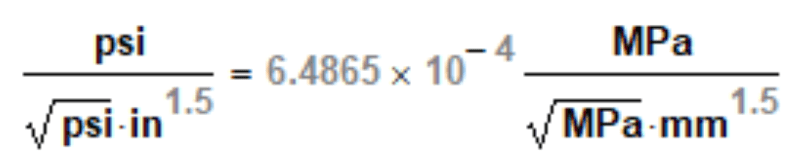

This is what I get for the conversion

I just had this discussion with a young engineer the other day.
I believe this is the simple and robust way to handle equations with implicit/inconsistent units when using MathCAD/SMath. Rather than stripping out and reintroducing units, address the inconsistent/implicit units at the source.
(more in-depth explanation attached)

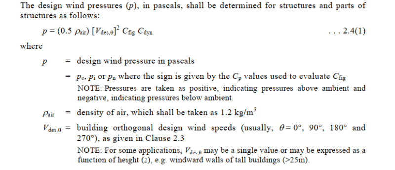

IMO Ideally formula should be invariate with the choice of units. Coefficients should either be unitless or the units CLEARLY highlighted.
EG a random excerpt from 4100.
You are free to use whatever units you want and the answer doesn't change.
Even some equations where the units don't seem to line up do if you dig hard enough. Here they spoon feed you the units but it is actually a unit agnostic formula too.
