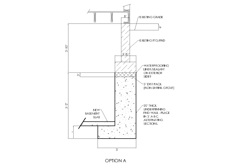

Hello everyone, question here on converting a 3' tall residential crawl space into an 8' tall basement. Prior to making this post I have read through every thread I could find on this site about underpinning multiple times. Please consider the drawing below showing the dimensions of the crawl space that is to be converted to a basement. At my old firm we would spec out something similar to the detail below. However, after reading through old posts it seems that this detail is not favored by many of the engineers here. It seems that the standard recommendation is to underpin the existing wall/ftg with a new wall that matches the width of the existing footing (in my case, that would be 20" thick). My concern, which has been brought up by others previously, is what about the "hinge" between the existing footing and the new wall? I've seen some of you say that if there is enough dead load on the existing wall then it will provide the overturning/sliding resistance needed so that we don't need to worry about the hinge. I've also seen some of you say that the new wall needs to be quite thick (30" or more) to prevent the overturning/sliding.
Well in my case I have an entire 31'-4" length of wall that runs parallel to the framing so it won't have any dead load from above providing resistance. Also, the existing footing is only 20" wide. PEinc in particular has said that doweling rebar into the bottom of the existing footing is not a good practice. Even if doweling was acceptable, wouldn't the dowels need to extend 18" at least up into the existing footing and wall? Seems impossible that that could be done correctly.
To summarize: Does lack of any dead load preclude underpinning? If I underpin, what about the hinge? If I design an l-shaped cantilever retaining wall with load from the existing footing, what is the problem with doing that? I don't have a soils report. I appreciate your thoughts and comments.
I missed that link, thanks for sharing. Not sure that method is really used here, interesting to see though.
If doing that in short sections then yea, option A could be a goer. Still have the issue of the mid height hinge but that's a case-by-case review of soil height and existing footing construction, definitely a solvable issue

What's missing from your A that is related to my comments on B/C is some method of at a minimum ensuring full bearing...
So something more like this...
Ok, so waterproofing on Option A?? Membrane on the inside of the basement that goes down to a drain in front of the extended toe? Membrane on the exterior (which would require digging around the outside of the home)?

Like I said, search for Blind Side Waterproofing. You'll still have to be a bit creative and consider all the various paths that water could take since it'll be broken up a bit...or you do the piers, a layer of blind side waterproofing, and then another wall inside. But I'd work with the architect on that.
Ah, I was thinking the blindside waterproofing would work with Option B and C, but not Option A. With Option A I'd think the waterproofing would have to extend up the exterior side of the existing footing and wall, which would require excavating the exterior face of the wall - which would eliminate the need for blind side waterproofing.
Pull too hard on that string and your whole sweater is going to unravel.
You need waterproofing behind your new wall, so if you're eliminating blind side water proofing that means you're excavating inside the crawl space to remain to apply the waterproofing to the backside of the underpinning. That excavation will need to be sloped back for safety and carried to the ends of the walls. What does that do to the perpendicular walls? You'll have to underpin those and do the same thing. Eventually you'll be left with the whole building up in the air while you try to build a new foundation. (Not a terrible idea - I've done several of that type of project, though the goal was elevating the house and not putting in a basement.)

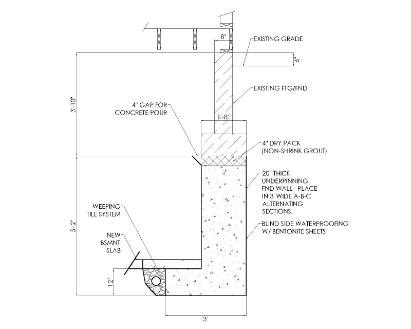

Thanks everyone for the input, pictures, sketches, etc. I've learned a lot from this thread, and I hope some of you have as well. And I also hope it will help future engineers many years down the road. I know I've learned a ton of stuff from threads nearly 20 years old!
I wanted to post an updated detail and note a few things I'm still thinking about:
- I've run some numbers on the underpinning wall and it appears that I will need a 3' wide "footing" at the bottom as shown for soil bearing and overturning. Thinking the wall and "footing" can be a monopour?
- With this 3' wide footing the numbers seem to say that I don't need any reinforcement in the wall. Am I ok to ignore the minimum reinforcement requirements from ACI?
- I've shown a 4" gap at the top of the wall where the forms will need to be angled out to provide a "slot" for the concrete to pour into. Many underpinning details show the edge of the existing ftg being cut off to allow for a slot to pour into. I don't feel good about doing that since I think doing so would create eccentric loading on the existing footing from the existing wall.
- I've shown a note for a weeping tile system that is to be installed at the toe of the wall. I have noted a blind side waterproofing system at the back of the pit. Hoping these two systems combined will provide adequate waterproofing.
- I'm discovering that having negligible dead load coming down from above is a definite drawback with underpinning design.
Some thoughts from me
- 100% you put steel in this, even if just for shrinkage sake.
Shrinkage cracks in the wall mean your waterproofing is at risk of compromise. Plus they will be unsightly.
Even ignoring that, I would not want to leave steel out a basement wall just to save a few bucks...consequence of failure vs cost incurred now vs cost to repair later ya know
- Will they do a separate wall + footing then slab pour, or is it better to do a slab + starter bar pour then do the wall separately?
This is probably a contractor question more than anything
If they do slab + starter pour then you eliminate the potential weaknesses in the unconnected slab to footing junctions and give your footing much more capacity and redundancy
I'm going to be honest that I don't like this detail though
Given your soil line is above the dry pack line, the success of your wall seems to be largely dependent on your contractor's grouting ability when filling that 4" gap
I know there are shitty 4" stone walls etc etc that show that things can hold up even when the only structural systems evident are thoughts and prayers
But we aren't designing those, we are designing robust systems that are supposed to have guarantees of success (or near enough to)
I don't like relying so much on that grout pack - it seems like a failure plane or conduit for water that has zero redundancy if workmanship isn't good enough, if materials fail naturally over time, or if unexpected forces come into play
There should be reliable steel and concrete forming your load paths and waterproofing

Apache1, underpinning piers are relatively massive and, therefore, usually are not reinforced due to very low compressive and bending tensile stresses. Also, the bending tensile stresses get reduced by at least the DL of the building and weight of underpinning concrete. Remember, unreinforced concrete underpinning should be stronger than a poorly mortared and always unreinforced, rubble stone wall of the same size. However, you do need to check your belled-out toe for any required reinforcing steel. You don't want it to break off if it is longer than it is thick.
@PEinc, is this really an underpinning pier, or is it a basement wall that has a secondary function to support an existing foundation beam above? To me they are distinct things but perhaps they are the same in your lingo?
