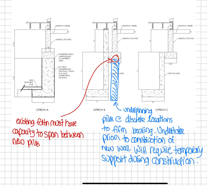

Appreciate all the responses. I've got three options here that have been proposed that we're considering. Obviously not a finished product but I think they give the general idea of what's been discussed.
As bookowski mentioned, I don't think we're going to look at using tiebacks on this project as it is a small residential job. We'd like to find a solution that doesn't require tiebacks.
Option A - Along the lines of what PEinc proposed. To get the overturning strength needed I've extended the toe of the new wall into the basement. le99 suggested waterproofing on the outside.
Option B - Suggested by Greenalleycat. In my mind this solves the waterproofing issue. The 3' toe at the bottom resists the overturning.
Option C - My original suggestion, and an idea that I've seen in other threads. This option is unacceptable to many engineers, but I haven't really seen an explanation for why.
LittleInch's suggestion sounds to me like a combo of Option A and Option B. Provide an underpinning wall (without the toe extension) and then put in a new full height wall next to the underpinning.
None of these options will require doweling into the existing footing since the toe extensions at the bottom provide the overturning/sliding resistance needed. PEinc seems like the resident underpinning expert here so I lean toward Option A. Option C would be least expensive. Option B seems unnecessary if Option C works.

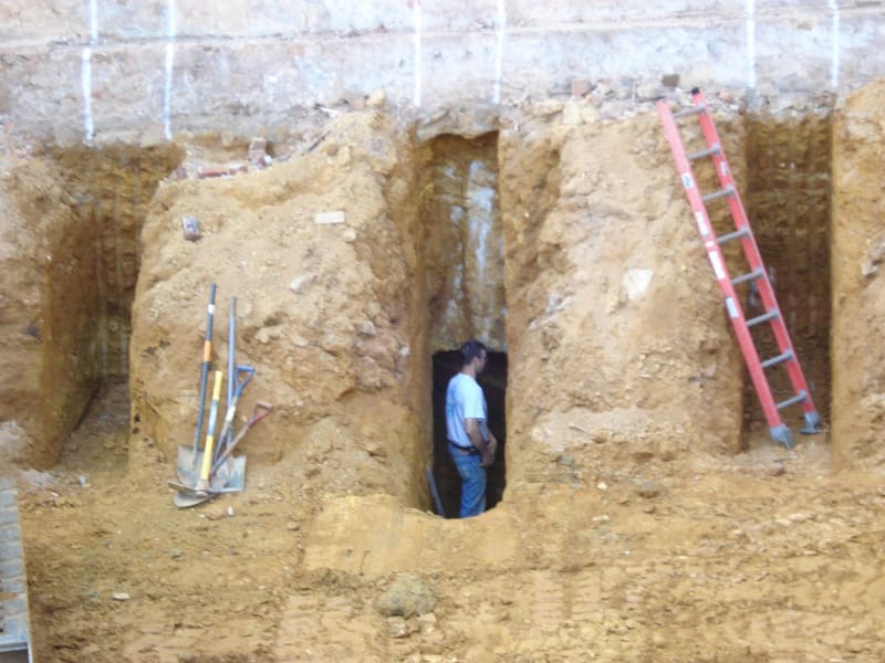

Apache1, I would not do Options B and C. The floor joists are parallel with the wall and are not sufficiently bracing the foundation wall. In addition, you would need to build these L-shaped retaining walls, which are NOT underpinning, in short sections so that you don't collapse the wall as mentioned in the following response from bookowski. Even if you could build the L-shaped sectional wall, you should calculate how much deflection or rotation the new wall will undergo. Rotation, deflection, and settlement mean building damages. Also consider the safety and legality of building short, deep, L-shaped, wall sections in unshored pits.
They were lucky that the soil was very stiff. However, the City and OSHA shut down the project because of the underpinning. The underpinning contractor claimed to have done an extensive number of underpinning projects. I told him he is a very lucky guy.
HOW NOT TO EXCAVATE FOR UNDERPINNING

My 2 cents on why I wouldn't do B or C. To me the biggest component of underpinning is execution. You are removing loaded soil below a footing (and I consider immediately adjacent to be under). It's a situation ripe for bad outcomes. How would you execute B or C with confidence - some soil will be lost, are they going to grout back into those voids? Even if you can get them to be careful and replace lost material it's now been unloaded. To get reloaded something needs to move. Doing this over and over around your perimeter seems like a crap shoot. I'm sure it has been done but it'd give me nightmares. I'm typically seeing underpinning on old crappy masonry buildings, maybe on a house under renovation you've got a little more stomach for some movement.
What's missing from your A that is related to my comments on B/C is some method of at a minimum ensuring full bearing, or better yet some preload. I typically see at a minimum rammed drypack in the gap between the u/pinning (stopped a few inches short) and the footing, more often I see wedges driven and then drypack, on some jobs/engineers I see jacking in pockets at every so many pins. You are handing off the load from one spot to another, you want to do that with as little movement as possible.
I have been advocating to do preliminary underpinning at discrete locations first, taking the loads down to below the depth of the new foundation
This ensures no surcharge of the house on the new wall and gives you reasonable confidence in the house foundation support during construction
Some lateral propping would probably be required but at least you don't have to worry about the whole footing caving in when the soil falls out
I don't really see how you build the continuous wall under the existing footing...pour the foundation first with starts out then try stick some temporary props under the foundation while your pour the wall?
The issue I see with Option B & C is that the existing footing will be imposing lateral surcharge pressure on the exterior of the new wall. That just exacerbates the overturning force on the new wall.

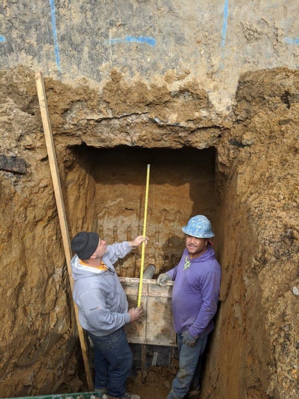

Greenalleycat - it's usually done in short segments about 4 feet wide. Click the "see page 5 link" in my post above - it's a good primer on underpinning for architects and discussing the more common methods used.
