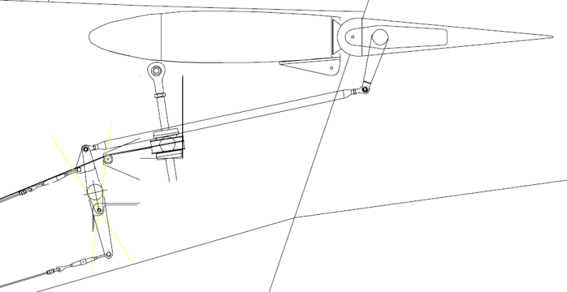

Could anyone help me with a material strenght calculation of this operating horn from crashed plane? 10
RedSnake
Nov 7, 2020
11,846
SE
Picture elevator to the left and stabilizer to the right.
The red cirkel is a tourque tube on the rudder and have a diameter of 38 mm and the thickness is 1 mm.

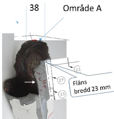

The operating horn was a welded box design using steel sheet AISI 4130 in condition N thickness is 1 mm welded against the tourque tube.
On the uperside and sides (3/4 of the circumference) has 30% of the normal materiels strenght(severe lack of fusion).
The last 1/4 can be brittle or have been sheared.

No, what I want to know is, how to calculate the strength between the lever and the tourqe tube and what force it is exposed to if the elevetor is against the mechanical max stop upwards and the force on the elevator 5.7 g.
To see if the strength reaches the expected value.
Or how much force on the elevator that is required to tear off the lever in the attachment to the tourque tube?

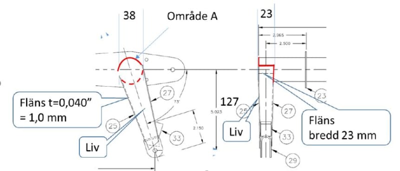

The red areas is the weld.
Picture of the brake.
The weld between the red marks has fusion of 10-50% and the cirkular weld on top is as bad.

the problem is that the elevator moves and the force moment creating the torque is L=1/2rhoV2Cl Just giving a g force of 5.7g doesn't give enough info to get the torque.
Which is why there is Maximum manoeuvring speed limitation given above that speed if you use full deflection of the controls things will start plastically bend and fail ultimately fail.

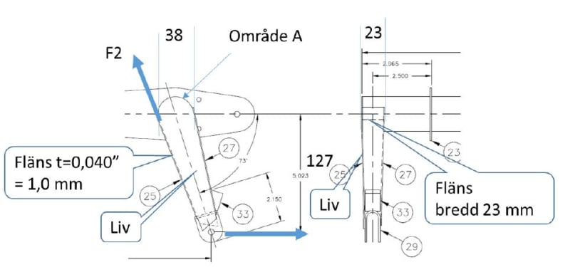

The only calculation I have seen is
The lever can be seen as a box beam with flanges and life. As the flanges converge towards the point of attack of the force, the transverse forces become largely non-existent. Which means that the function of life is mainly to prevent cracking of the printed flange. There were no traces of buckling on the lever, so the welding error that was located in the connection between flange and life becomes insignificant.
Flange cross section = 23x 1 = 23 mm2
Yield strength 4130 = 50 daN / mm2
Flange breaking load (F2) = 23x50 = 1 150daN
Moment = 1150x38 = 43 700 daNmm
F1 = 43 700/127 = 344daN
Gear ratio for the steering wheel approximately 5: 1
Steering wheel power = 344/5 = 68.8 daN for breakage
(Assuming that the entire steering wheel power goes only to the right elevetor.
In addition, material is added in area A
The lever has thus had good strength despite the welding error.
So if you push the steering wheel forward pitch down by 60 kg you would break the lever.!?!
I might add that I do not understand why he put F2 vertically upwards. According to those who did the material investigation, the crack began at a 90-degree angle from the drawn F2 (the wite arrow in picture abow), the area he thinks is uninteresting.
