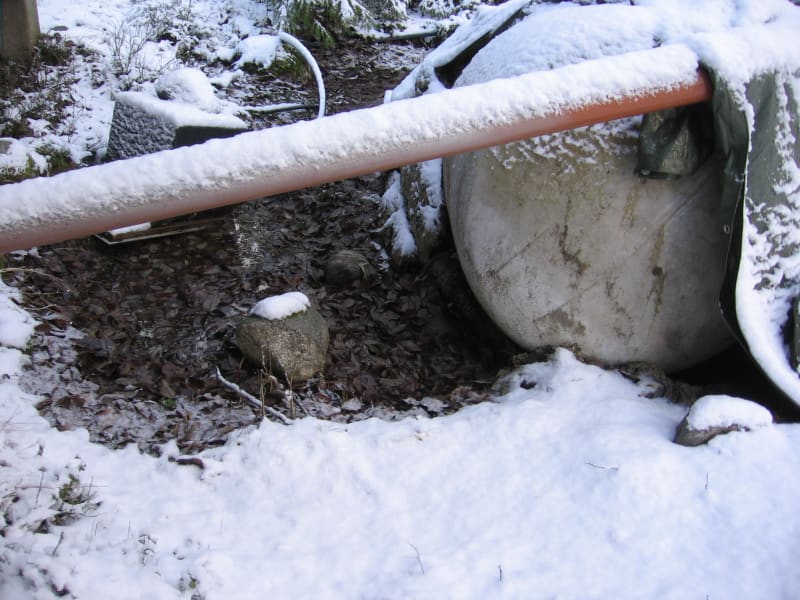

My summer cottage is exactly what it sounds like a cottage for the summer ..
No water on in the winter and no insulation ..
And now I also have problems with the sepsis tank!
I got it emptied some time ago, you have to do it every 3 years according to law and then the remnants of hurricane Zeta came in here and it rained and blew so much that the tank has moved out of the ground :-(

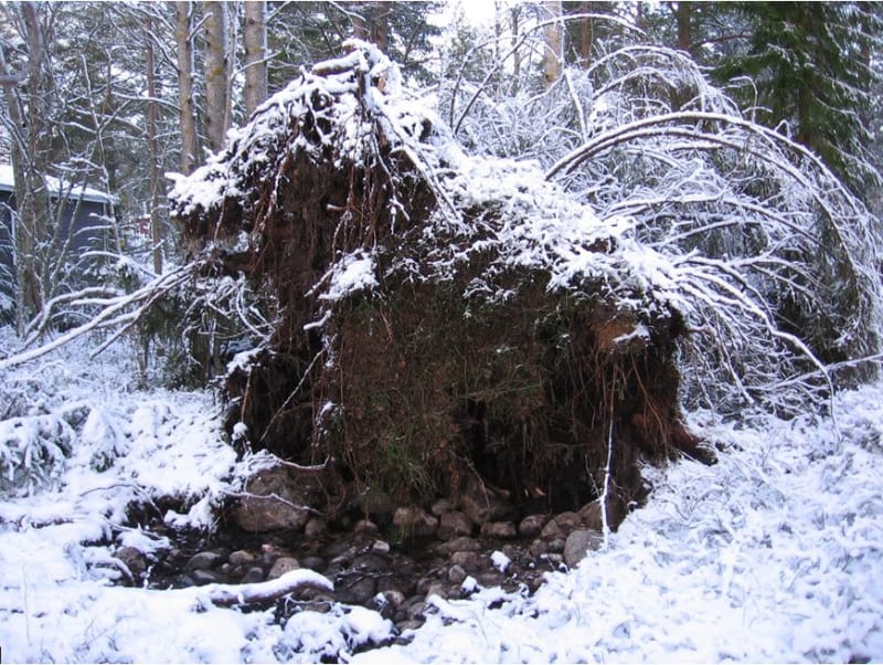

And four spruces have fallen over but the cottages survived ...
So now I have more work out there this spring ..
