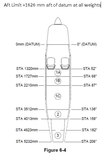

If the Forward Limit is +1219 mm aft of datum at 1089 kg or less

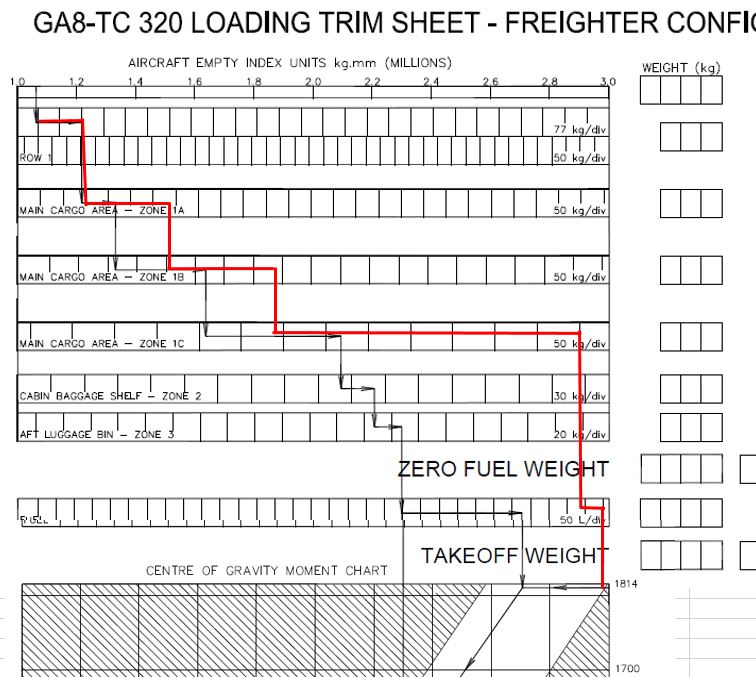

and I look at the chart from the manual it would not be possible to fly the plane with only the pilot if the person did not weigh at least 160 kg?!?!?
And the chart starts at around 1059 mm and adds 160 kg up to ca 1219 mm.
And in SHK's yellow graph they have started with about + 80 kg in 1219 mm I guess it is the pilot.
And have the planes basic weight was 1051.7 kg anything to do with it?
Please explain, I do not understand :-(

I have before but the problem is that the chart only goes to 1814 kg and the plane can be loaded 1905 kg ?!
And I could not figur out how SHK made there balance sheet.. they tried to explain but when you compair the 2 it's just confusing.
If they hade presented it as a seesaw, it would have been easy :)
I probably did not understand because there is no stated counterweight.
Okej pilot less den 160 kg
1A 2x90 kg, 2A 2x90 kg , 3A 4x90 kg , 60 L fuel
Correct or ???
I don't get this ??
Forward Limit +1219 mm aft of datum at 1089 kg or less
+1448 mm aft of datum at 1905 kg
Variation is linear between 1089 kg and 1905 kg.
Aft Limit +1626 mm aft of datum at all weights
The plane was made for 1905 kg but the chart only goes to 1814 kg (a not rebuilt plane)

The planes basic weight 1051.7 kg was the actual weight measured by SHK.
They calculated the weight to 1905 kg when the plane went down.
Which means that for total weight you have 853.3 kg left for people and fuel.

One problem is that there is no proper mass and balance chart for skydiving.
This is from the report.
The Accident Investigation Board has consulted the type certificate holder's documents C99-52-01 and C16-99-42 which were used to demonstrate compliance with the requirements of EASA document SC-O23-div-01. With regard to the requirements for an examination of mass and mass center change during and after take-off, these are met according to the type certificate holder's documentation by video demonstration of a flight test and operational experience of the aircraft.
During the flight test, five jumpers, with a total weight of 500 kg, gathered at the door and carried out a coordinated jump of 8,000 feet. At the time, there were two pilots on board with a total weight of 186 kg. The speed at the exit was 80 knots. It was noted that the aircraft was controllable and that there were no problems with handling the aircraft. However, some balance sheet calculations have not been reported.
In this example 1905-1051,7 = 853,3.. 853,3- 686 = 167,3 kg for fuel, of course, the weight distribution is different here.

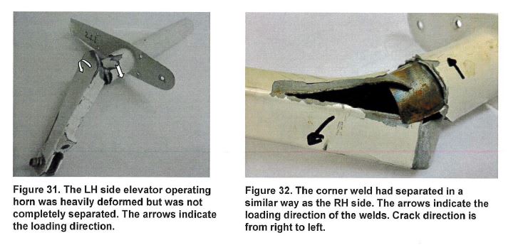

I received the full metal survey report today.
On the left elevator, the push rod had come off.
I know the left side elevator broke off last, so it has nothing to do with the cause but I think the right side should have withstood more.
/ Anna
4.3.6 Examination of the Elevator operating horn LH side
The LH elevator operating horn had failed but was not completely separated. Longitudinal
cracks followed the corner weld fusion zone. The weld quality of the operating horn is
sim ilar to that of the RH operating horn and does not fulfil normal weld quality
requirements. The lack of fusion has guided the crack path along the corner weld.
4.4 Examination of the broken Elevator Eye Bolt
The eye balt push rod connected to the LH elevator horn was braken as can be seen in fig 33.The push rod showed a sharp 23° bend 135 mm from the fractured eye balt.
The fracture showed an overload fracture starting in the bottom of the threads at the
location of same damaged threads. The starting area and the fracture direction are marked in Figure 35.
It looks like a lateral material tearing failure mode. Not in a design load plane.

The bolt on the U swivel is from what can tell is 6mmm. The rod is about 1.2 X it's failure limit. The box section arm.. many times more than that. And a I think I have screwed up the calcs amount of weld between box and tube it's so little.
The welding I fully agree is a tertiary factor which should be mentioned in the report.
Btw that's what I expected to see for the rod failure. It's unfortunately a normal failure mode
