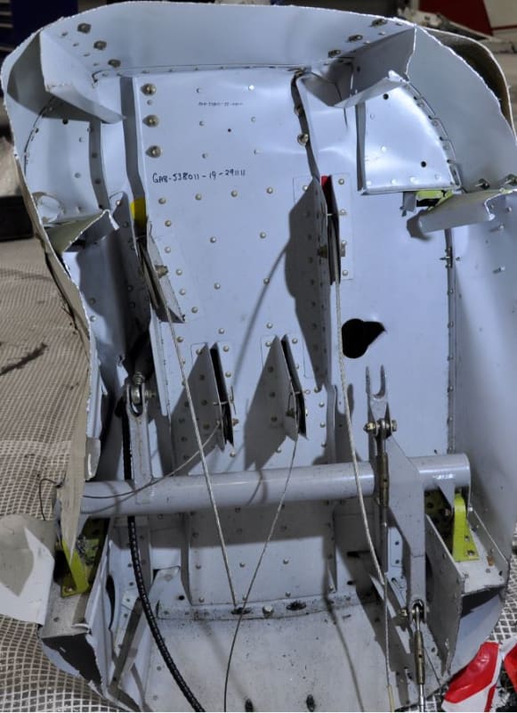

Could anyone help me with a material strenght calculation of this operating horn from crashed plane? 10
RedSnake
Nov 7, 2020
11,768
SE
Picture elevator to the left and stabilizer to the right.
The red cirkel is a tourque tube on the rudder and have a diameter of 38 mm and the thickness is 1 mm.
The operating horn was a welded box design using steel sheet AISI 4130 in condition N thickness is 1 mm welded against the tourque tube.
On the uperside and sides (3/4 of the circumference) has 30% of the normal materiels strenght(severe lack of fusion).
The last 1/4 can be brittle or have been sheared.
The red triangle is the mechanical stop maximum up.
The relationship between hinge, tourquetube and elevetor edge ca..
0 --------1 --------------------7
Can this construction hold for 5,7 G ???

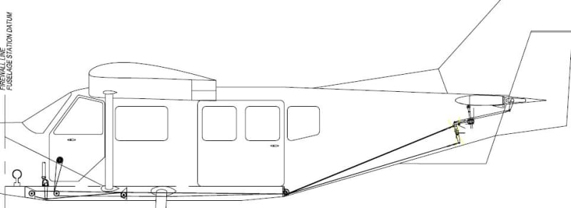

Sorry I have just found a picture of the tail of one of them and you are correct the trimming system does not use a trim tab to adjust the elevator trim.. It must have some tensioning system on the pitch control runs which holds a tension on the cable which is not the best to be honest but is legal. The piper tomahawk had a similar tension system and it doesn't allow you to fly the plane if you have elevator control issues. Which could be another point of failure to be honest. If the CoG goes rearwards and the tension mechanism releases then a fully out of trim aircraft is dumped on the pilot. Maybe point of failure is a bit strong maybe loaded above its operating limits would be better causing it to release which would give a nasty change in control weight. You might not be able to see that it had occurred either depending on the system design and the clutch mechanism applying the tension.
Alistair,
The manual attached might make more sense to you than me, but I think the elevator control cable is just tightened with a turn buckle.
This does appear to be a pretty "basic" airplane alright.
The stab is able to to be trimmed for sure and on the AIB report was found 90% in the nose down position.
I suppose the question is if the elevator horn started to fail on one side and you ended up with different elevator pitch, is that enough to cause a spin or stall before the pilot could catch it by use of the ailerones?

ok its a screw jack doing the trim so no clutches to release when you least expect it. I used to hate when the PA30 tomahawk used to do that.

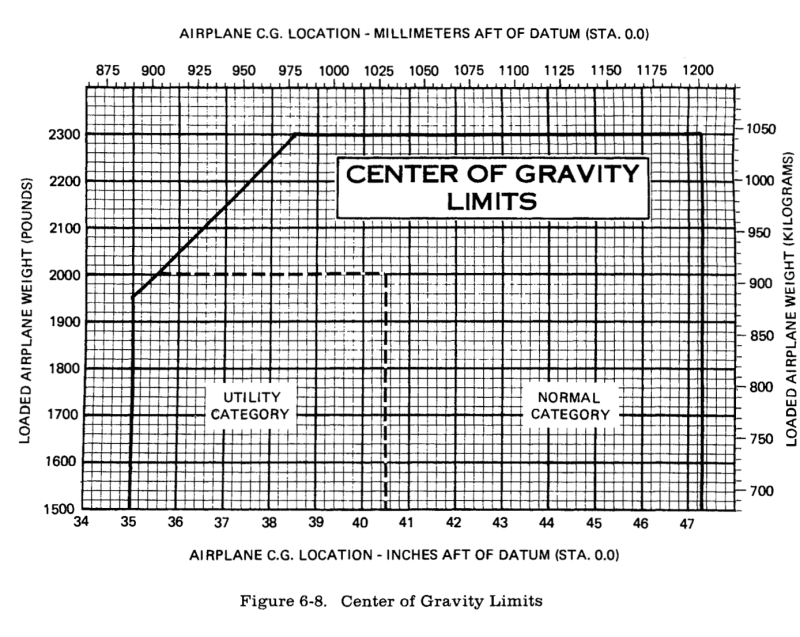

Could you find the Pilot operating handbook as well? that should have the CoG flight envelope in it s we can see how twitchy/limited it was with loading.
90% nose down is quiet an extreme trim setting not much left to play with. You can also get elevator stall which although possible is extremely rare. I have only every had it once on a piper Seminole while doing my initial twin rating. Its usually only a factor in high T tail aircraft which don't get the prop wash going over the elevator.
That side of loss of control is impossible to know without a data recorder. I agree that the lever arm had lateral forces on it when it failed, the action which caused those forces, your guess is as good as mine.
Yes please download it.
Then i will work out how much weight movement is required to take it out of the CoG envelope.

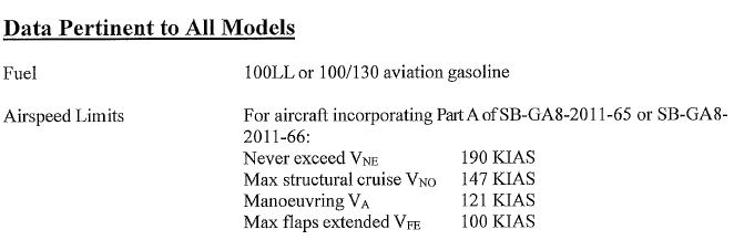

About the Airworthiness directives..
The lever for the elevator are not included in the airworthiness directives and there is no mention of any controll of rust.
In 4-10-00 airframe limitations in the service manual mm_ga8.
There might be a amendments not inkluded in the service manual I don't have.
From the type certificat VA503

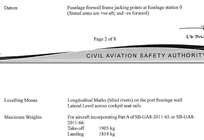

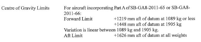

Did they give you the mass and balance/performance sections of the flight manual?
I have the complete manual GA-FlightManual-08(b) POH but I'm not sure it's correct, as the planet has been re typed in Australia after it came to Europe and this has not been noticed by the EASA.
It is very messy with all the documentation. :-(
The planes basic weight was 1051.7 kg

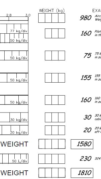

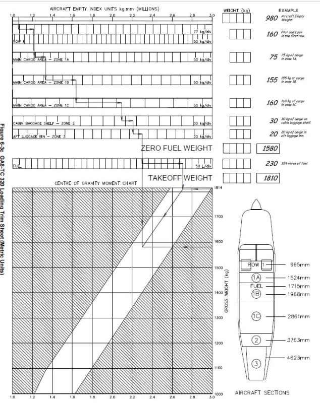

there is usually a graph which looks something like this in the mass and balance section with also a description on how to calculate the COG which is dependant where they have set the datum.
If you could upload the POH that would be great.

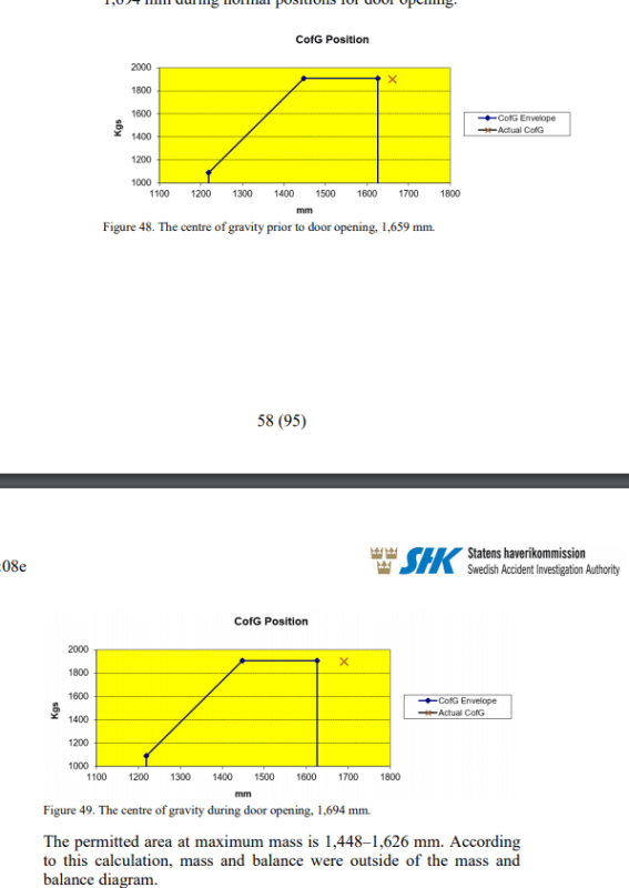

The accident report noted this as the C of G.
That's I suspect the best case situation
I don't have a printer and that load sheet is easy done with a pair of compasses.
first print of few sheets and run various load cases.
First one is with two people in the front and 6 at 1715 arm and 77kg for each pax. I suspect it will come in at what the SHK have published.
Then run it again with a more realistic weight for each pax of 90 kg with jump gear on.
Next case keep two in the front,3 at 1715mm arm and have 2 at 2861mm and 1 at 3763mm so thats the jumpmaster with his bum on the baggage rack at the back and a tandem going out the door.
Now have one in the front go from 965mm arm to 1715mm arm while the load master is sorting out the tandem and doing a buddy check.
The SHK can't put in writing what I have suggested because there is no proof that's what occurred. Even their current chart is extensively outside the envelope.
Although that said they did go a couple of levels up and actually weigh an aircraft with real parachutists onboard.
