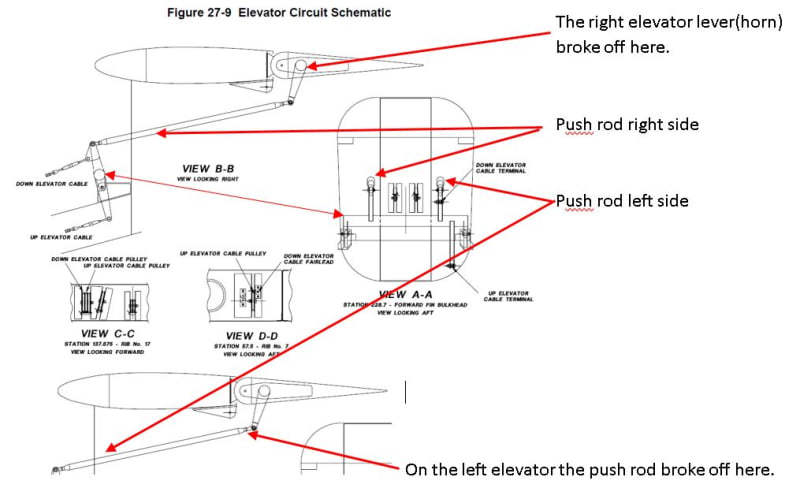

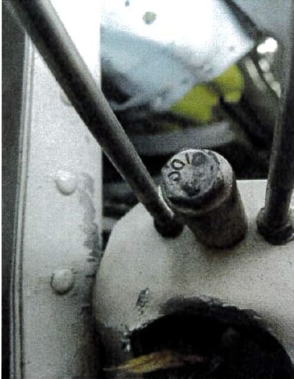

Could anyone help me with a material strenght calculation of this operating horn from crashed plane? 10
RedSnake
Nov 7, 2020
11,786
SE
Picture elevator to the left and stabilizer to the right.
The red cirkel is a tourque tube on the rudder and have a diameter of 38 mm and the thickness is 1 mm.
The operating horn was a welded box design using steel sheet AISI 4130 in condition N thickness is 1 mm welded against the tourque tube.
On the uperside and sides (3/4 of the circumference) has 30% of the normal materiels strenght(severe lack of fusion).
The last 1/4 can be brittle or have been sheared.
The red triangle is the mechanical stop maximum up.
The relationship between hinge, tourquetube and elevetor edge ca..
0 --------1 --------------------7
Can this construction hold for 5,7 G ???

The control gearing is X5 so don't divided.
Not that it makes much difference. That control load is more than a bit optimistic in this situation. A young guy will easily pull or press 50 kg X that by 1.5 when adrenaline kicks in. 35 kg is the book figure you are correct. And will be what the design cord will presume. It's not realistic though.

As said, the left stabilizer was broken off last, so it is not really significant, but on the right side, the bolt was okay.
About the min max stop.
The elevator movement is limited by adjustable stop screw heads for both LH and RH
side. These stop screws meet the elevator horn. Examination of this screw heads confirm severe hammering on the top side. The RH side stop screw show more extensive
damages compared to the LH side, see Figure 38 and 39.
The wear damages on the stop screws an increased extent on the RH side.

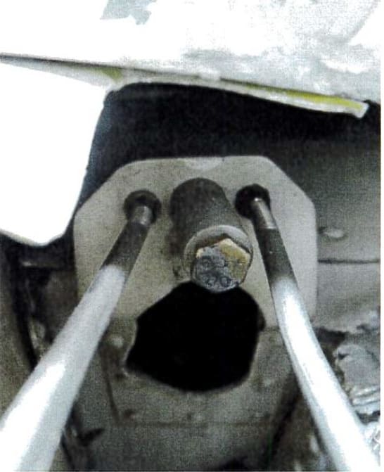

Summation as far.
Left elevator:
Push rod bent 23 degrees.
Eyebolt fractured.
Severe hammering on Min stopp screw head.
Horn/lever broken but not completely off.
Right elevator:
Push rod Okay.
Eyebolt Okay.
No one mentioning of any injuries to any of them.
Even more severe hammering on Min stopp screw head.
Horn/lever broken off.
From metal report.
According to Gippsland Aeronautic Manual (p51-2) all welded steel tube structure is
deemed to be primary structure. The welding acceptance criteria for this part are however
not known.
