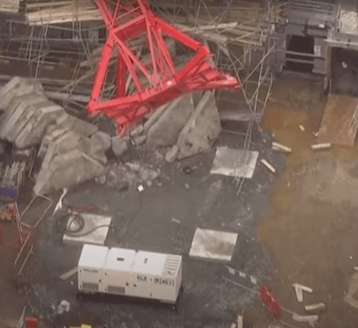

Are the big triangular concrete pieces near the base of the crane part of the building, or some sort of counterweight scheme I'm not familiar with?
Looks like it thrashed that row house pretty good.
Also looks like one of the 4 concrete pads is missing, but I also don't see how the crane was anchored to the pads, since it doesn't appear to be any damage to the remaining pads.
TTFN (ta ta for now)

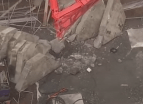

The triangle pieces of concrete are definitely the counterweights. Looks like concrete weights stack on each side of the crane on the outrigger frames - the shape of (2) concrete pieces put together looks like it closely matches the shape of the crane base.
Looks like the crane fell at 45deg to the (4) crane legs/outriggers - the counter would be least effective in this orientation.
The fact there is a massive crane already there is quite suspicious - looks like it might have been being dismantled.
Looks to me like it went over backwards, with the boom landing upside-down, assuming the counterweights lying between the tower and building should have been opposite the boom before anything went wrong.

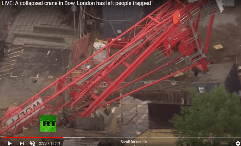

Watching the video some more, at about the 2:34 mark, I see what looks like more concrete counterweights on the ground beneath the boom. This is all on the other side of the building from where the tower base is. Anybody have some insight on this?
That was my first though when I watched the video, "Jim you did install the hold down bolts right?", "um I thought you did it"...

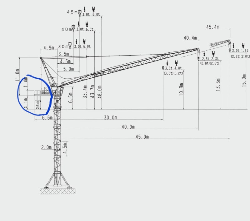

But it does look like one of those gravity only deals, reliant on the weight of those counterweight blocks at the base for stability which are stacked on the base frame. Foundations are only their for levelling and distributing bearing loads. There is no holddown bolts or anything to the foundations typically.
Likely the jib counterweights located in the crane assembly.
These look like the counterweights. No idea what the other concrete blocks were, but look like facades for the roof to create a roof line.
