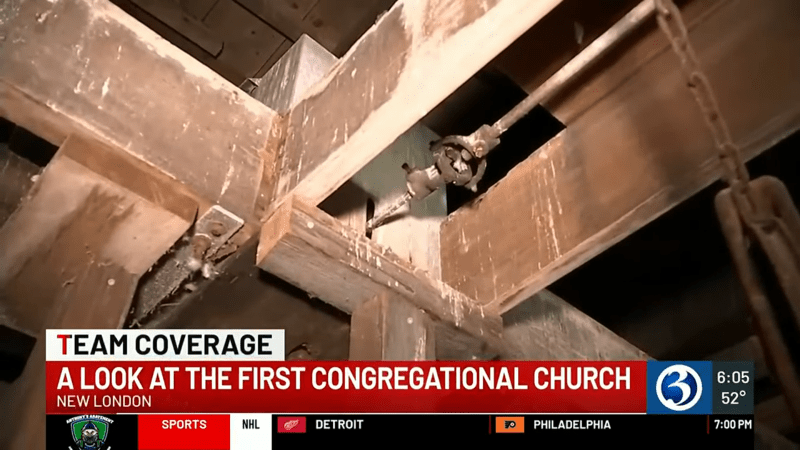

So maybe those rods finally failed, or someone decided to remove one because it was "in the way" or just there were not enough of them to hold the stonework together.

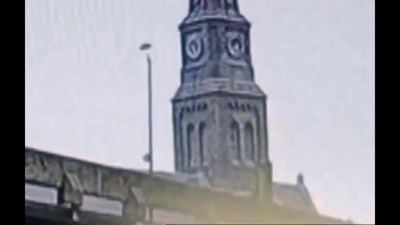

I've occasionally encountered 'dryrot' conditions at the intersection of the steeple and the roof.
Inside the clock tower - WFSB 3

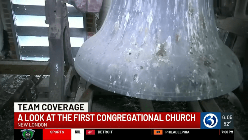

And the bell, which can't be too heavy, or not. At any rate, these things don't randomly fall down too often.
The Isaac Middle School behind the church has geometry students looking at previous days of video from their security camera and they have already noticed that the lean angle of the steeple increased 2 degrees just from Jan 15 until the day of the collapse. They plan to turn over their analysis to the city next week.

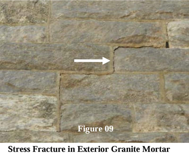

From 2011 inspection by structural engineers: The exterior tower wall, originally constructed as a two-wythe cavity wall, was grouted solid during the most recent renovations in the mid-nineties. Prior to this renovation, the same tower wall was reinforced from the inside with steel tie rods to prevent the walls from parting.
These corrective actions appear effective, as by all visible accounts, the tower is structurally sound.
The remaining granite walls appear to be sound as well, with the only area of concern being a small stress fracture running through the mortar joints in the northeastern wall (Figure 09). Fractures like this can occur from slight movement in the wall caused by settlement, spalling, or impact. This fracture is more cosmetic than anything and should be remediated by repointing the mortar joint.

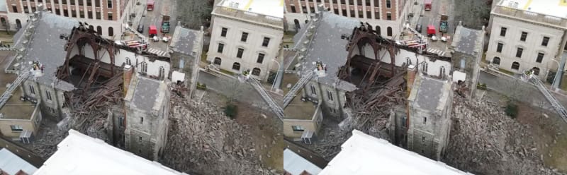

Though the upper portion of the tower leaned north as the lower portion gave way, using the main sanctuary roof line as a guide, it appears the upper tower initially came straight down.

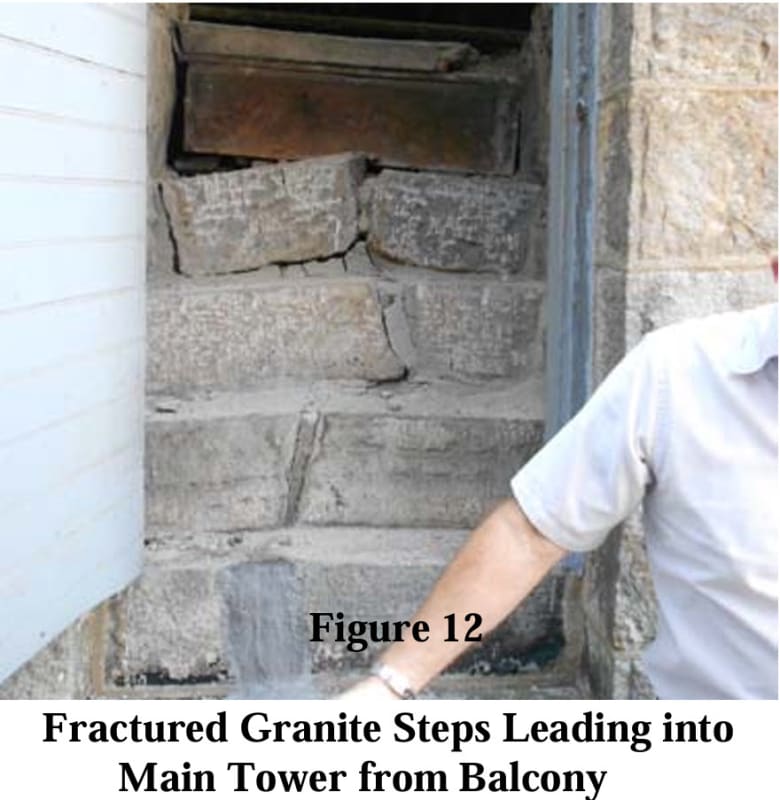

Fractured Granite Steps
This is about as clear an indication of a masonry arch failure (between the tower and sancturary) as I would expect. Search for "Pointed arch failure" for a number of graphics and papers on common failure modes.

Jeff, do you have a copy or a link to it as I've never seen it, only heard about it and those cracked step photos look very interesting.
To be fair to the surveyors / engineers, it does look like something only started moving in the last few weeks / months to be visible to the naked eye.

Catastrophic collapse rarely happens without some sort of warning, the issue is whether that warning was acted upon and whether it was reasonable for someone to act on it. I'm beginning to wonder if one of those tie rods which look fairly weedy and not many of them just gave way / snapped and hence the things literally holding the building together failed and initiated the collapse due to some sort of settlement. Or if they failed and then the building started moving.
For fun, 3D arrangement from drone footage.
