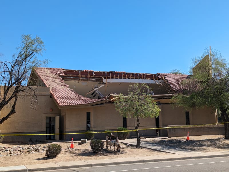

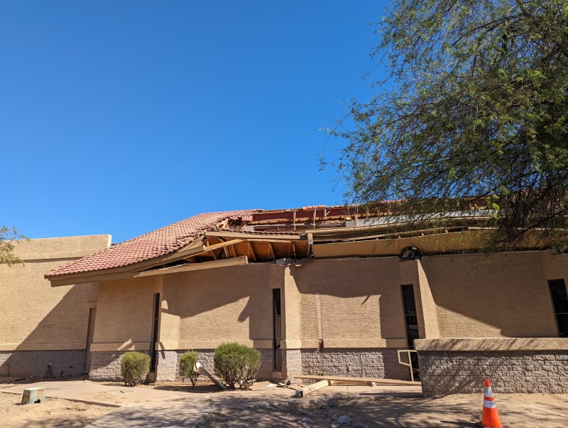

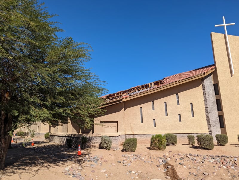

This happened in my neighborhood. Came upon it just after it occurred. Fire alarm was activated and could hear sprinklers pouring water.
Appears the building was unoccupied. I'd seen no recent construction there.
Map Link
The trusses seemed to have some kind of plywood reinforcing gusset at the ends supported at the ridge. Not sure I've seen that before.

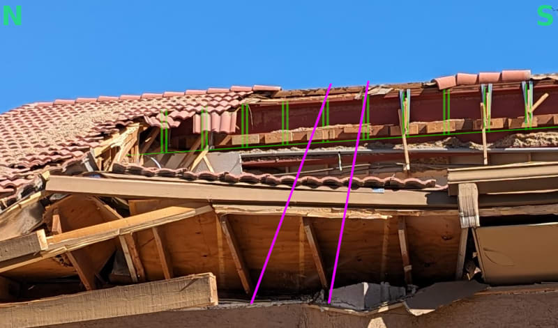

My guess is that the plywood is a filler for the truss hanger while also doubling as a support connection for the box framing around the beam. It is not well connected to the truss so gusset isn't likely. It seems peculiar but solutions are sometimes just that. The vertical for the box framing looks like a 2x6 with a notch at the bottom for the longitudinal 2x4's.
A simple pin connected truss diagram demonstrates the highest compression loaded member extending from the lower support. If inference can be made that as a result node one has the highest propensity for deflection, this model would align with the failure mode of the church trusses where the the eave extensions are pushed opposite the top chord deflection by leverage of the support connection.
I would even venture a suggestion that the two trusses indicated below are the two sinners that set off this calamity given the similarity of the eave deflection and damages at the roof line. It would be interesting to see some drone footage of how the roof landed.
The plywood could be a filler, but that would mean the incorrect size was used for the hangers. It might make some sense if it was a reinforcement gusset added after initiate construction. I’ve just never seen that for a new construction detail.
Incorrect size is true and I wouldn't know why, but that's what it looks like.
I used plywood strips to level the battens so everything was flat for the roof sheet to go on.
I am certainly no expert on rafter roofs and it may be due to lack of skill but there is always some low spots you need to raise to give an even final surface.
I presume these truss roofs are the same.
They might also be something to do with the mounting of the ridge cap so it can't slip sideways.

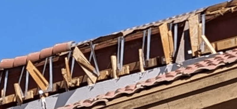

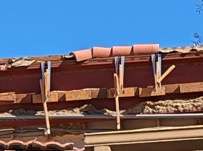

Those look like TJI hangers to me (Simpson ITS Hanger). The smallest width seat available is 1.81" for light duty I-Joists with 1.75" flanges. So using a piece of .25" ply as filler wouldn't surprise me - Simpson allows it on other hangers if designed by an engineer or architect.
The hanger doesn't look to be the problem, though. After all, remnants of the truss are still attached to the hangers.
There is one section where all the hangers are gone, but yea I wouldn't necessarily think that having a thin filler would be a big issue. I have just never seen that before.
So there is...
As long as it's fastened correctly to the truss, I agree it wouldn't be a problem. Also difficult to tell if the hangers failed because the hanger failed, or if it was ripped down when the roof fell.
I wonder, though, if by putting that filler in and fastening it if they altered the truss too much and created a pseudo fixed-end condition?
The plywood filler is at mid-depth of the steel ridge beam. Top of wood rafter was probably at the edge of the top flange. The filler is giving something for the bottom to attach to or just bear against.
The plywood filler is between the side of the truss and the hanger, i.e. the hangar pocket is too wide. The vertical truss element fitting in the hangar is edgewise standard dimensional lumber, so 1.5" thick. The plywood looks to be full height of the truss so it provides solid fill between the hanger and truss.
The mat'l behind the truss, filling in the beam web space, looks to be three layers of dimensional lumber, i.e. 4.5" thick.
One oddity I pointed to earlier is a recess cut into one of the backing blocks. It might be a flag to a bigger issue at that location.
Here is a zoomed in look at those gussets. I agree that the connection failures could easily be a symptom of the collapse rather than the initial failure point. I think it looks more like global truss failure occurred first and the hangers got twisted and ripped off.
What are those three layers of something the hangers seem to be dependent on? Stacked plates on top of the steel beam? They don't look to be in good shape.

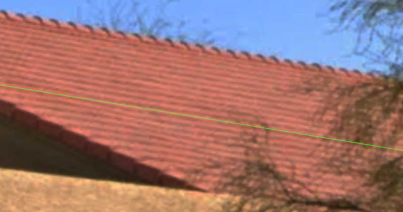

From Google Street View, March 2022, the roof is visibly sagging at the north end.
I don't see roof cavity ventilation, though it may be incorporated in gable features. No ventilation that I can see in the eaves either.
(Edited to change "south end" to "north end")

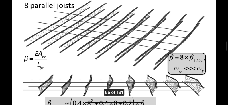

Buckling was mentioned earlier in the thread and I think there is some evidence of that. The first photo marked up by Sym P. le shows a truss on the left side possibly in a buckled mode shape. Many of the hangers appear to have the same twist/skew angle as well. I took this snip from an SJI presentation, but it illustrates the global buckling mechanism pretty well.

You know - the second and third photos in my OP were taken within minutes of the collapse. Before police or fire arrived due to alarm. And there were already those cones out there. Wonder if there was some evidence of impending failure.
The first pic was taken later and you can see the caution tape there.
