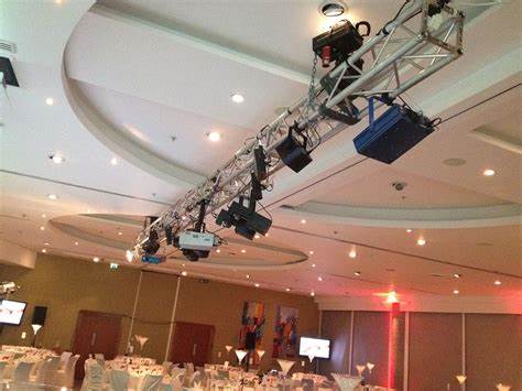

hokie have you seen these legacy lighting rigs?
They can weigh over a ton. quite often just hung on two suspension points.
Personally I would design just for them at the starting point then the rest of the roof round them.
If they were added in post design and build they are an accident waiting to happen as they may get a tick for 3 lanterns but then get progressively added too as pastors change and the history of them is lost.
I am wondering what the trigger was for the buckling. Something added recently or an environment change
No, I have no idea what you are talking about, and don't see it from the pictures.
The legacy lanterns can be 30-40kg each. And if they have motor movement try doubling it.
They are made out of tubing.
I doubt this one will be a ton but it could be 200-300kg hung off a couple of cables.

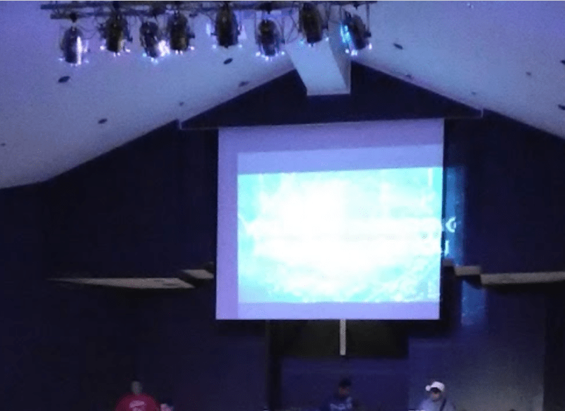

This is the lighting structure inside.
Nothing else springs to mind... The screen looks like a drop down screen.
Unless they put up a new LED screen?
Unlikely on the public report.
I'm still not totally understanding the framing here. There's a change in slope in the ceiling, but not the roof. So these aren't fully parallel chord trusses. (ETA I'm not sure this line is correct - think eyes playing tricks)
And the broken pieces that are now poking up at the outside bearing wall look more like joists than the remnants of a top chord extension. That hardly seems like enough depth to make truss work for that span.
Could there be another beam at that slope change? Doesn't seem likely.
I really don't know.
Maybe I'll see if I can get some more pics.
azcats - looks like there's a MASSIVE steel ridge beam up there.

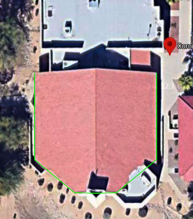

The 45 deg carve out on the building footprint feeds the illusion of a change in roof slope with interior photos.

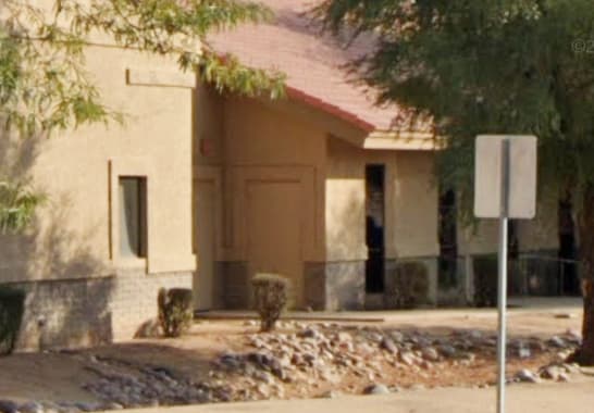

Eave detail from dated Google Street View

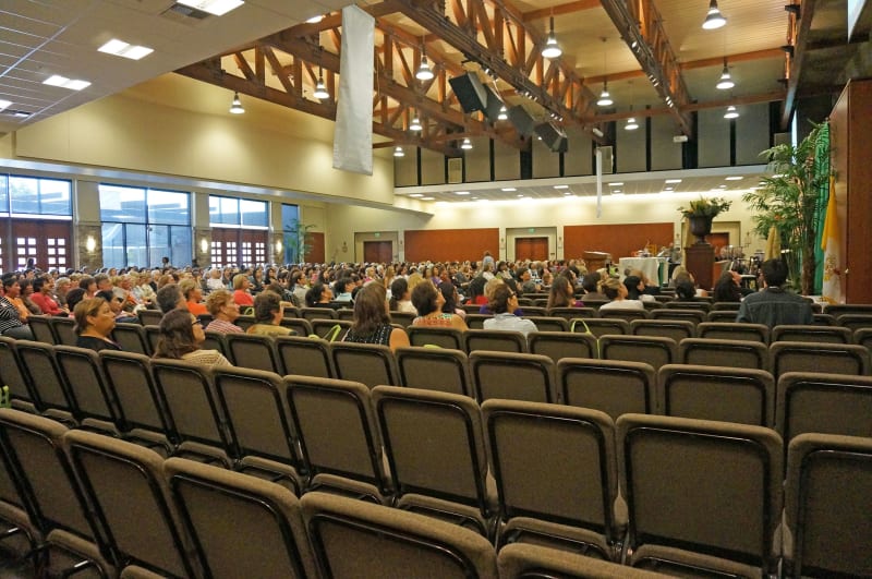

Our church also has a tile roof:
December 2009 (Sony A100, 10-24mm)
But look at the roof beams:
October 2014 (Sony NEX-3N, 16-50mm)
Yes - this is what was fooling me.
phamENG - I thought I was seeing a ceiling slope change about halfway down.
