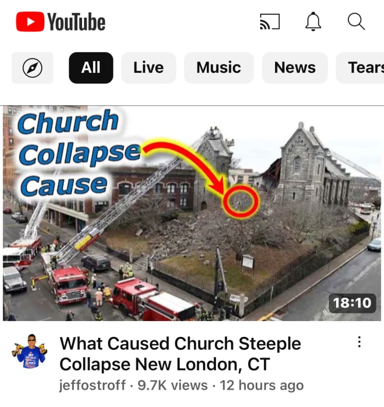

Thanks ALK, and looking closer with Google Maps, we can see anticipated displacement in the adjacent northwest buttress, particularly the arched window. Also significant deformation in the east nave roof framing.
Two images of west buttress from Google Maps.
East roof line - Google Maps

https://www.facebook.com/NorwichCTRadio[/URL]]Pictured is the Engaging Heaven Chruch ... Steven Govoni who is the president of High Tide Capitol--a development company from the state of Maine--which is currently restoring several nearby properties in the city of New London, to which, the Manwaring building next door to the church was one of them--He said, he saw several stress cracks in the large granite blocks on the State Street side of the building earlier that morning. He said there were also pieces of granite from the blocks laying on the ground. He said they were standing in front of the building observing the architecture of the building.

Two comments I've seen posted on one of the New London facebook pages (New London Strong) - I have no idea of the accuracy:
State pier construction shook downtown for awhile driving piers to bedrock in the river
The architect warned in 1851 that the steeple was unstable and should be rebuilt
The other New London facebook group is Whale Tales Two, there's a lot of discussion there, too.
[URL unfurl="true" said:
https://news.yahoo.com/opinion-first-congregational-church-steeple-013700467.html[/URL]]In the letter, the architect of the church, Lepold Eidlitz, wrote gravely that the only sure remedy was to "take down the whole of the steeple and tower and have it rebuilt by a more competent and reliable person than your general contractor."
Shoddy work from day one in 1851. "Hamden-based architecture and engineering firm Silver Petrucelli & Associates" have egg on their face after giving a clean bill of health in 2010. The building changed hands in 2015.
