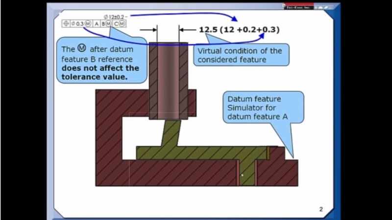

Assume considered feature is produced at dia 12.2, tilted within dia 0.3. since the feature is tilted 0.3, feature produced location is assumed 60.
Hence the related actual mating envelop is 12.34.
Refer attachment.
V.C is dia 12.5. Now this feature is approved with datum RMB.
But the video shows, datum shift required. How?

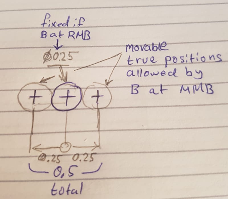

The total "traverse" distance is 0.5. This is for the specific condition where RAME of datum feature B is 35.5, so that the calculation is MMB-RAME=36-35.5=0.5.
Edit - the correct image is in the attachment
Ok. So the datum shift will allow the tolerance zone to move (without affecting the location dimension) within datum shift allowance.

Sa-Ro,
From some reason I could not edit my previous post to attach the correct image. There was a mistake in the one I initially posted too. Here is the correct image. Hope this helps you to visualize datum shift.
Thank you. I am well understood the datum shift from your image.

Sa-Ro said:
Then what is the necessity to move the tolerance zone as datum shift?
To allow the part displace relative to the datum reference frame just as it displaces during assembly with the mating part when there is available clearance for some movement. As a result, additional allowance is available as features can dislocate (as a single feature or as an entire pattern with all its features simultaneously) from their fixed (at RMB) true position(s). I showed the displacement of the part relative to the DRF as mobility of the tolerance zone because maybe this may help to understand it in the context of inspection without a fixture as you asked, when the part is not actually moved anywhere physically.
Also, notice the terminology: for datum features the M modifier is MMB, overriding RMB (for "considered" features the modifier means MMC overriding RFS).
OK. Now I am getting more clarity.
The tolerance zone can shift as much as datum shift is available which means the location dimension can vary.
"location dimension can vary."
Only in comparison to RMB. The tolerance for location around true position does not enlarge. The true position itself can "shift" relative to the part, or another way to way to look at it is the part can shift relative to the theoretical datums.

I'm not sure I understood your calculation of VC=12.34.
Anyway, the point of the video was that the considered feature was produced somewhat tilted or dislocated or both in a way that it doesn't fit in its virtual condition sleeve gage located exactly at 60 from datum B as shown here:
However because datum feature B was produced with its related AME smaller than the MMB gage, it allowed the part to move the amount of available datum shift relative to the datum axis to fit within the gage. But that doesn't mean the tolerance for the location of the considered feature got any larger because of the MMB modifier. If datum feature B was produced at a RAME size equal to the MMB (12.3 as in your sketch), datum shift would not be available and the part wouldn't pass in that condition.
Edit: to explain in other words why datum shift doesn't allow "bonus" or additional tolerance: you can't enlarge the 12.5 V.C. sleeve gage just because datum B's RAME was produced less than 12.3.
I am not sure about Tec-ease video.
Because the feature is tilted within dia 0.3 and located at 60. VC of that feature is Dia 12.5.
I have drawn a sketch to tilt the feature to find out the RAME - extenal (12.34).
Hence 12.34 can be easily pass thru 12.5 with RMB - feature approved.
But they showed, part will not pass thru with RMB.
The part was designed such that the datum B at MMB, feature at MMC, TP at dia 0.3 will pass thru the VC of 12.5.
My doubt was started from this video only.
