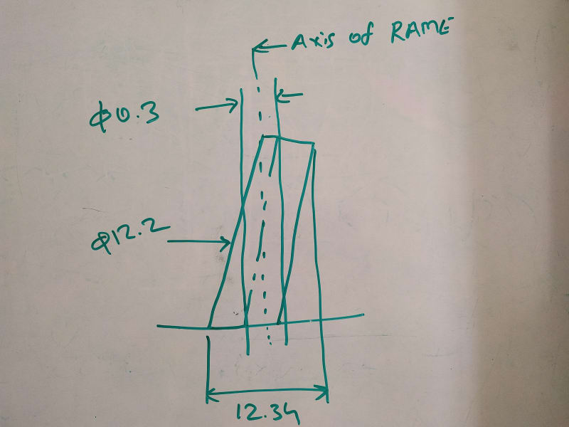

Hi
Refer my attachment.
What is use of datum shift?
Everyone defining, we can adjust the datum feature during inspection to make the corresponding feature approved.
My doubt:
To ensure the coaxiality of dia 10, the gauge ID will be V.C of 10.2.
As long as the dia 10 feature manufactured within dia 0.1 position tolerance, is there any use with datum shift?
(or)
If the feature is out of tolerance and by utilizing this datum shift we can make this feature approved?

Sa-Ro,
I'm afraid your calculation of the RAME of the considered cylinder is incorrect. A cylinder of 12.2 UAME size with the axis tilted within 0.3 but no location error will produce a RAME of roughly 12.2+0(location)+0.3(tilting)=12.5. Actually a bit more than 12.5 but for a feature of reasonable height, the approximation is good enough. I think Don didn't say in the video how much the axis of the actual feature shown is tilted or how much that feature is dislocated but suppose its UAME size is 12.2 as you say and its tilting + dislocation is within 0.35 relative to the true position at RMB. The RAME size in that condition is roughly 12.2+0.35=12.55, so it doesn't fit the hole at the gage. The RAME size of datum feature B could be produced as 12.25 or less, allowing the required shift. Would the Tec-Ease video make sense to you in that scenario?
This how I calculated RAME from CAD drawing
The way it's measured seems correct, but the result seems odd. I will check it on my CAD tomorrow.

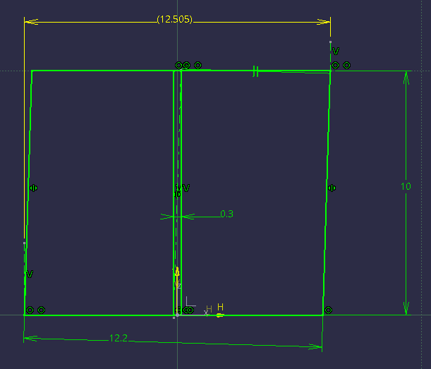

Sa-Ro,
Take a look at the image below.
The RAME size resulting from 0.3 inclination is slightly larger than 12.5. The shorter the cylinder the larger the envelope, because a shorter the 0.3 diameter tolerance zone the larger the inclination angle. For features taller than 20 mm I got 12.501 mm RAME envelope, consistently.

pmarc, see below
UAME=LMC=11.8
RAME size is as expected by the usual calculation. For features taller than 19 mm the RAME size is consistently 12.101.

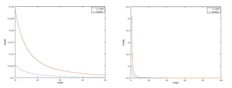

Also note your second figure you have evaluated the feature at LMC, since this feature is specified with MMC position you would have 12.2-11.8=0.4 of bonus tolerance available - your total allowable orientation error being 0.7 instead of 0.3 which results in a RAME of 12.529 for a feature of height 10 for the resolved geometry interpretation.
The curves for both the MMC and LMC cases are below.
