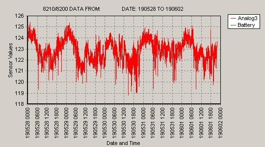

It's been plugged into the wall in my house for over a week. Here's some of the data. Nothing very interesting. The voltage obviously peaks overnight, usually going up to 124 volts. It's also much more steady overnight. You can see that I turn on the coffeemaker and toaster at about 6:15 AM, and supper starts cooking between 6 and 7 PM.
Sorry, all this proves is that I am pretty dull. The point is to use it at Pierre's house, and in multiple points in his system.
