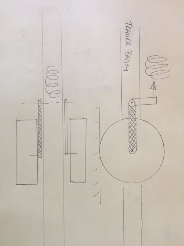

Well thanks for the comments.
Here is a "sketch" to show the principle. The member I'm concerned about is shown "hatched".
The sketch shows just one side of the trailer.
Weight is not too big a concern for me in this situation.
If I can get an appropriate calculation, I can play with 2 or 3 "g" and see the effect on arm.
I'm thinking A36 plate as it is readily available and easily fabricated.

The trailing arm, which I have shown hatched, pivots about the point identified by your arrow.
This link will be a "bellcrank,transferring the load to the spring which lies in the horizontal plain.
My concern is defining the necessary section of the trailing arm, to withstand the twisting moment from the wheel / stub axle. My aim is to make the trailing arm as "thin" as practical, to keep the overall width to a minimum. The trailing arm will be a rectangular section.
There will be a crosslink between the two bellcranks to transfer the total load to the spring; "F" in your sketch.
Hopefully clear ?
Bob

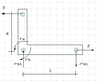

Does this look like and make sense? If so, you shall check bearing of the pin hole, tension on the net section, shear on the gross section, and flexural stress (δ = M*y/I ± F/A). Note F can be in reverse direction, then the horizontal arm is in compression, you have to check plate buckling stress.
Note that you shall provide fillet at the inside corner to avoid stress concentration; and shall provide a beefy safety factor as dynamic force and fatigue are involved.

You've got the concept, schematic.
I certainly will need to consider the bearing surface for the pivot, and also the filler between the vertical and horizontal arms, no problem.
However my concern is trying to establish the stress in the horizontal member "L" in your sketch, due to torque effect from the stub axle.
As stated earlier, static load about 4,000 lbs on the wheel.
Centerline wheel to centerline of trailing arm "L" = approx 7 inches.
The section of "L" would be a rectangle. I'm not understanding how I calculate the stress in this member due to twisting moment of the wheel.

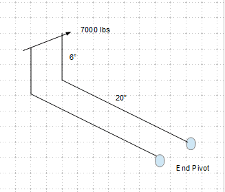

Thanks Retired for trying to get it clear !
Think of it as a simple member, 20" long. This member lies in "X" direction.
One end is supported on a pivot, with support on both ends of the pivot.
The other end has a lever, firmly attached, that sticks out 6", in the "Y" direction.
At the end of this lever is a force, 7,000 lbs static, in the "Z" direction.
The effect of this force is to try to twist the member, resisted by the pivot.
I'm trying to calculate the torsional stress in this member, as a function of the force, distance of force from neutral axis of member, length of member, cross section of the member, be it a solid, rectangle, square or round tube. With an appropriate formula, I can consider various sections for the member, and calculate the stress.
I will have to include some dynamic loading, and also the bending load in the member. I'm starting to think tube maybe my best solution, be it round, square or rectangular section.
Thank you
Bob
I am with you up to this point. But confused on "One end is supported on a pivot (as shown), with support on both ends (where and how?) of the pivot". What kind of restraints the support provides? For true torsion situation, wouldn't it be T = F*e, and δ = Tr/Ip. Round bar is better fit to resist torsion, but how about the thickness constraint?
