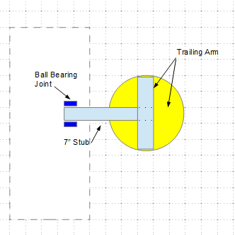

The reason for solid bar is two fold - 1) the gain is not much, but still save space where fraction of tenth of inch counts, and 2) did you check torsional stress combined with shear, V = F*FOS = 7000^2 = 14000 #.
This is what I have imaged. BTW, you can draw using "OpenOffice" drawing module (free), and copy to the clip board by "Shift+window key+s", then paste to the image box (with pic of camera) of this forum by "Ctrl+v".

I'm OK with an extra 1/2" section width, thanks.
No I did not check torsional stress combined with shear.

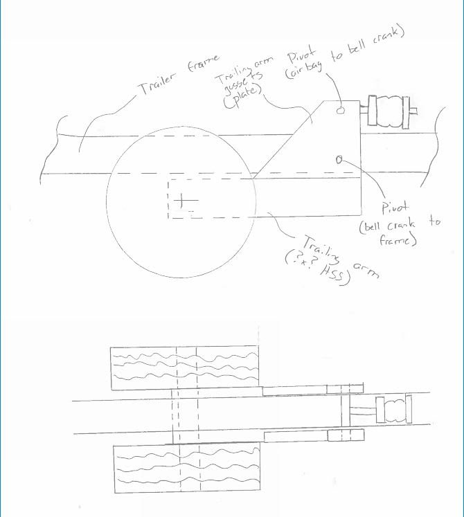

What you really need is to come up with a detail that links the pairs of wheels together across the frame member. This would cancel out your bending moment- your stub axles or thru axle will need to be substantial, and the bending moment in the trailing arm will also be substantial, but your trailing arm bushings/bearings/linkage will see zero torsion and will be much easier to make strong and reliable.
Here's a very simple arrangement. With some clever packaging you could 'hang' the frame under the wheel centerline, although that flips your bag 180 degrees and puts it underneath the frame, which has complications. Much depends on how low you need the trailer to drop, and how much time you're willing to spend designing.
The quick sketch below shows this arrangement lowered all the way down- the size of the wheel/tire and the section used for the trailing arm will have a direct impact on your lowered height. Remember that you can't lower the axle centerline unless you plan to air down the tires for loading/unloading, and even if you do that you won't gain much. So if you design all this out, member sizes have a huge effect on functionality.

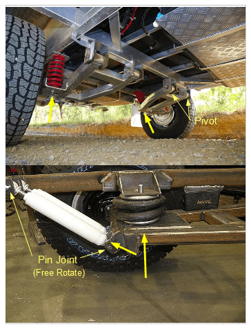

This is my understanding. For properly designed towing frame, the trailing arm resists the applied force only, provides all pivot points are rotation free.

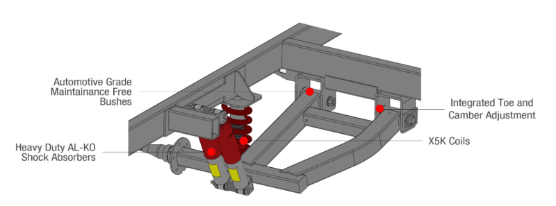

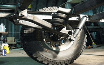

If you take a look at the images and links that I posted you will see some similar designs. One of them with dual tires rated at 6,000 lb each, using some form of trailing arm solution as I'm looking at. Due the fact they are using duals, the center of the load is further from the trailing arm, than I'm considering, but also they have twice the loads, because of the duals.

I need to keep the boat as low as possible due to bridge clearance. I will use detachable cross members, maybe 4" square, not defined yet. I would like to achieve 8" ground clearance beneath the cross members. For simplicity in designing the cross members, this puts the bottom of the trailer frame at 12" from the road, in the travel state. I could then lower the trailer up to 8", depending how I attach the cross members, for loading.
It would be difficult to link the trailing arms below the frame to achieve this. Maybe they could be linked above the frame ? Tires are 32" diameter, so 16" center height.
Because of these issues and looking at the other designs above, I'm thinking of wheels on the outside of the frame only.

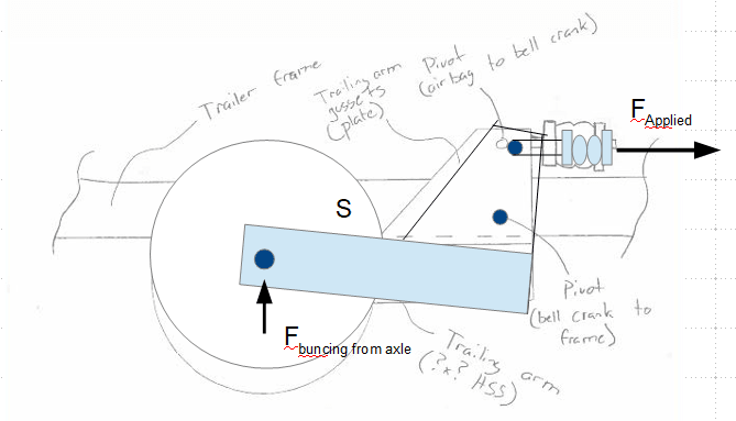

If my sketch above is ever close to the central topic, for loads depict, I don't see torsion but bending - from the stand up trapezoidal plate to the trailing arm. However, for side swing (lateral) load case, torsion is possible. Again, I don't know anything about automotive design, just straight talk on simple mechanics for the given setups. Hope more automotive/mechanical engineers can join the discuss, and provide meaningful insights.
Torsion is generated because the load applied to the trailing arm (the lower and left most of the two forces in your diagram) is eccentric- it isn't applied along the centerline of the trailing arm. It's out of plane towards the viewer of your diagram.

The trailer manufacturer linked above has some fairly revealing pictures of their suspension on the site if you dig around.
Link
That trailer is listed as having a 10" x 10" frame, and the trailing arms appear to me to be very close to the same size; perhaps 10x10 or 10x8. Also take note of the thickness and length of the gussets and mounts which support the pivot pins. Everything mounted to that trailer is beefy.

The view of this one is clearer.
Another similar but much stiffer design. As the concept is getting clear, I suggest to open a new thread on the automotive forum, from which you shall get plenty of to the point advices. Good luck.
