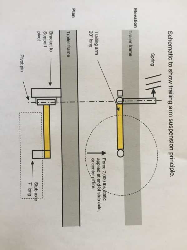

I'm designing / building a trailer using a trailing arm suspension system. My problem is to design the arm to accommodate the torsional stress involved.
The wheel / tire is 32" diameter, 10" wide.
Static load of 4,000 lbs per tire.
The stub axle(inc brakes) will be attached to an arm approx 20" long from axle center to pivot point.
This arm will be a "bell crank" transferring suspension loads to an air bellows suspension.
My problem is to specify the section of the arm to resist the torsion loads.
I want the arm to be as thin as practical to minimize the overall width of the system.

My concern is with the trailing arm, referred to as the "member" in post at time 17:01.
Hopefully the schematic I've just uploaded will be clear.
I'm concerned with the arm shown yellow in the sketch.
Not to scale, no bracing included etc. For the purpose of this discussion I'm just concerned with thr "yellow arm".

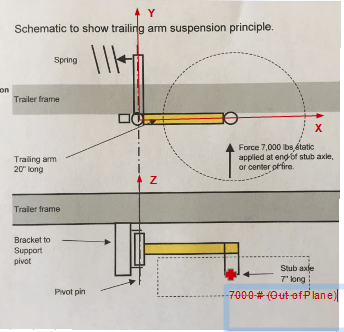

If this is correct, the short stub subjects to a bending moment of 7 kips* 7" = 49 kips-in. Then, this bending becomes torsion on the trailing (yellow) arm, assuming the brake pad is capable of restrict the rotation of the pivot. I don't think this assumption is correct though.
Retired,
I don't think the rotation of the pivot or brake pads is the issue. The spring will resist the rotation of the arm around the pivot point.
The torsion in the trailing arm, yellow member is the issue.
The forces calculated is for the both of the bending on the 7" stub, and torsion on the 20" yellow arm.

So after a bit of toying with ideas, I went to the formula for round hollow bar.
I put in the following variables: I'm in the US, so Imperial units
Load 7,000 lbs x 2 for shock = 14,000 @ 7" radius = 8,200 ft-lbs
Tube outer radius 1.5", inner 1" (3" tube, 2" bore).
Shaft length 20"
Mod of rigidity 11.24 (Mod elasticity 29,000 ksi, poisson ratio 0.29, 1045 med carbon steel)
Results:
3" tube, 2" bore, 1/2" wall:
Max shear stress 23,200 psi
Angle twist 1.6 degrees.
Clearly a very stout member.
3" tube, 2.5" bore, 1/4" wall:
Max shear stress 36,000 psi
Angle twist 2.4 degrees.
3.5' tube, 3.0" bore, 1/4" wall:
Max shear stress 25,000 psi
Angle twist 1.5 degrees.
3.5' tube, 2.75" bore, 3/8" wall:
Max shear stress 19,000 psi
Angle twist 1.1 degrees.
This is exactly what I was looking for - Thank you.

If you look at the numbers I posted above I included a factor of 2 on the load to accommodate some shock, I'm currently including a factor of 3.
Re solid bar - once again I played with the results from the calculator "LittleInch" steered me to.
I had selected a tube 3.5" OD with 0.375" wall thickness, as this gives acceptable results.
To get similar results for solid bar, I need to be about 3" dia.
Don't gain much in section width, but add a lot of weight.
It's interesting to note that 4" OD, 0.25" wall gives about the same result.
I need to add a bending component, but I don't think it will be much. If it is significant, I can "triangulate" the lever to apply force more directly to the spring.
