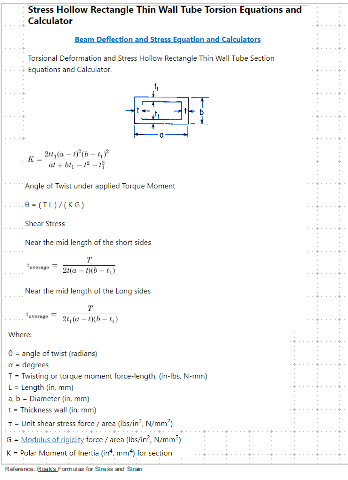

The link works for me. Maybe there is a problem with your browser. Anyway, here is the formulas. Also try this link.

So, working on your suggestions, and some calculations Retired has steered me towards, here is my thinking:
6 tires, 3 each side on outside of trailer.
Capacity of 5,000 lb per tire.
Trailing arm length = 14.5"
Small bending stress, as triangulated directly to spring.
Length of stub axle = 12" - will hopefully be able to shorten.
Trailing arm square tube: 4" x 4" x 3/8"
Torsional Stress calculation = T/((2t).(a-t).(b-t1))
T = 5,000 lb-ft
t (t1) = 0.375"
a (b) = 4"
g force = 8, so T = 40,000 lb-ft
Stress = 48,700 psi.
I don't know how to calculate the twist in a square tube, but the same load applied to 4" dia x 3/8" round tube gives 2.1 degrees. ( and a stress of 67,000 psi) so I should be perhaps 1.5 degree.
This is a massive structure, but I have considered 8 g.
If I go to 5/16" wall tube, and 6.5g, then my stress stays at about 44,000 psi.
Is my logic sound, please ?

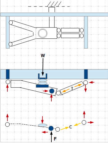

The sketch below is force diagrams for one of the design. There are two cases considered, 1) static weight, and 2) impact due to tire bouncing upward. For road drive, case 1 and 2 are to be superimposed. Force to trailing arm-tire connection should be calculated using the net force at point "A", with the linkage as a cantilever beam. The diagrams need to be blessed by an experienced design engineer, and you might need his/her help as the calculations are quite involved
Legend: Black Arrow - Applied Load, Red Arrow - Joint Reactions, Yellow - Cylinder Internal Force

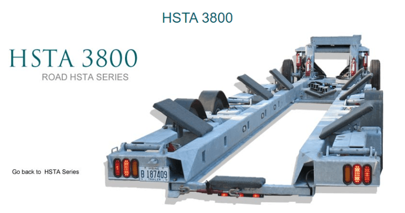

I've greatly enjoyed this post, but looking back through it all I'm really wondering if you've bitten off more than you can chew.
From the above you are apparently trying to create a road transporting boat trailer capable of shifting (your?) boat which weighs around 12 tonnes and is 42 feet long, 13 feet wide and 12 feet high.
This is not like building a boat trailer to tow behind your car as I think you're discovering. The forces are huge and if it goes wrong you could loose a wheel, have your boat turn over and cause a large crash. If it's your boat then fine, but the insurance won't be paying out when they find out you made it in your back yard.
The second main issue I think you really need to give some intense thought to is whether you really need as oposed to would like, this whole lift up and down business on the suspension and more to the point do you really need to lower the frame below the centre of your wheel. This is really quite hard to do and if you can keep the frame above the centre of the wheel at all times then it would get a LOT easier. If you look at the examples above I think you'll find they all work on the principle of the stub axle being below the line of the frame.
When you look at the example you posted from hostar marine which is less than your capacity - it is a beast of a trailer. There is a good reason why they will cost a lot of money. Mainly because they don't want to get sued if the trailer falls a part in use.
So I wish you luck and would love to see more information, but hope you sit back for a minute and decide if this is real or just a fantasy to build it and actually use it on the public highway. In a boat yard - No problem. On the Road - I struggle to see it happening.

If you look at all the other examples and what people have drawn, everyone of the trailing leg type designs are some sort of wishbone which you need to avoid huge moments at the joint between the single trailing rod / bar/ tube and the pivot tube. This needs space.
I can't see the details on the trailer picture above, but looks like it might be a sideways wishbone to me.
Rather than this complex armand pivot arrangement I think you'd be much better off with the air spring acting directly over the stub axle connection onto the trailing arm. Removes large amounts of stress, moments, gusett plates etc and all your arm is then doing is keeping the wheel in position and transmitting braking forces.
Think you need a trip to a boat yard or three and do a bit of peering about under some trailers....
