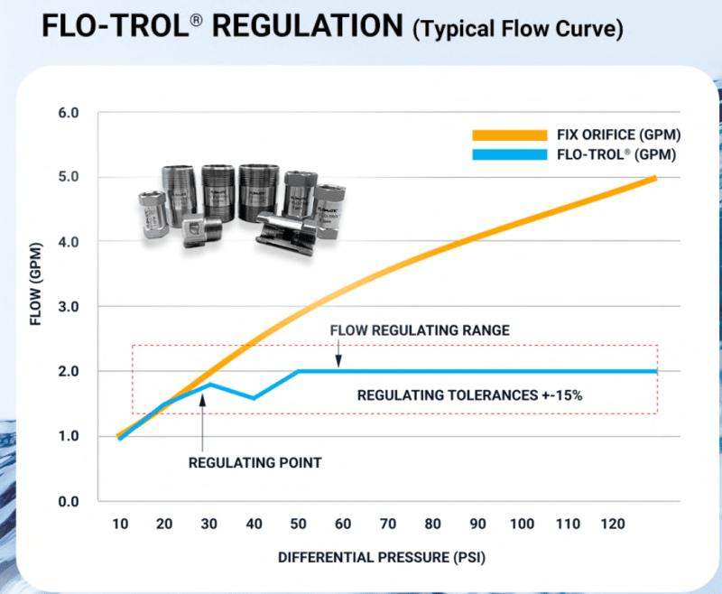

After the UV reactor, I have a 240 GPM flow restrictor valve that is intended to prevent the UV system from exceeding its design flow rate. This restrictor valve could have 15-20 PSI drop when running at its full flow rate.

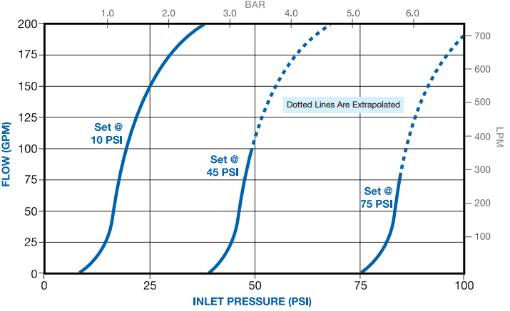

After the filters, the loop then goes to a backpressure regulating valve that is set to maintain around 170 GPM of tank return flow when the loop is idle, to achieve 1 tank turnover per hour.
The backpressure regulating valve is set to 10 PSI, and it will maintain around 30 PSI at design flow. If the loop pressure drops because other processes are drawing from it, the backpressure valve will close and create a "dead leg" at the end - to prevent this, the backpressure valve also has a 10 GPM flow restrictor in parallel to ensure some amount of minimum flow is still achieved.

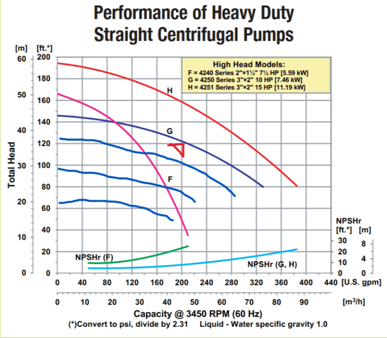

The pump curves and a sketch would be helpful. My first thought is to control pump speed with lead lag configuration and flow meter for the 170 gpm minimum flow setpoint. Any usage upstream will be seen and the pumps can adjust accordingly. Are there any actual pressure requirements for the process equipment in the loop? If not, then the pressure can vary, and you are only concerned with flow at that point.

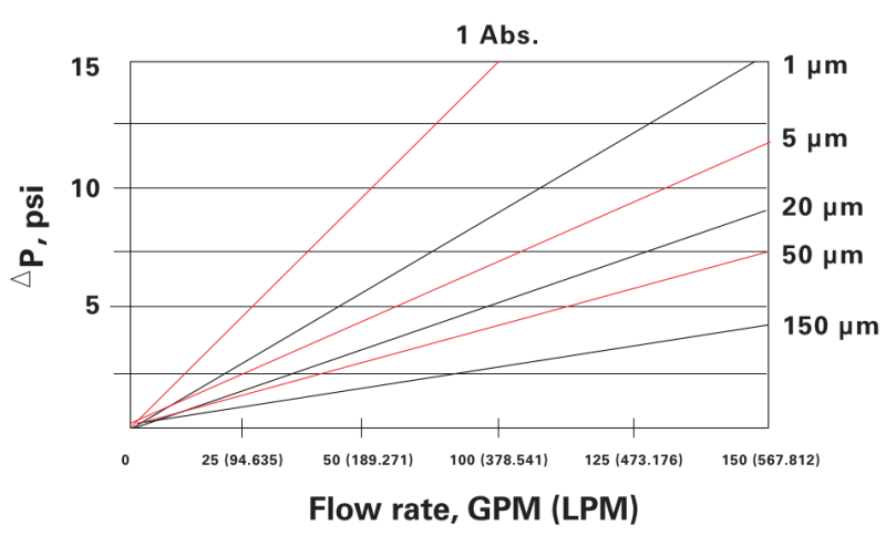

b)There is also the variable pressure drop across the filters as they gradually fill up with sediment. So shouldnt the backpressure PCV be upstream of the filters ?
I will try to get a sketch drawn up. I do have a minimum pressure requirement for one piece of the process equipment, but I can coordinate that with the tank fill operations so that I don't go too low.
Pump curve is line "G" here:

a)If the backpressure control valve is set to maintain a backpressure of 30psig, then why do you say "The backpressure regulating valve is set to 10 PSI,.."?
I am estimating this based on the curve that the valve has, since it is not linear. The specific valve is a Plast-O-Matic RVTX device, and the curve is here:
That is a good point that I did not consider. That will change my piping layout for sure.

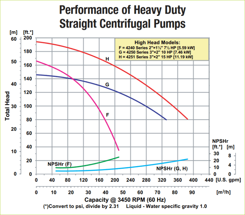

So the two pumps are for redundancy, not running in parallel? Based on the curve, only one is needed in service if 240gpm is the max flow rate of the system.
Correct, I want to have a "hot spare" and will probably alternate them every week or so. However, my flow restrictor setup is actually a pair of Flomatic CDK120 valves in parallel, and these might not pass the full 240 GPM until the delta across them is extremely high, according to a curve I found for them. Something like 30 PSI. So I might need the second pump to achieve the loop pressure I'm targeting under full flow conditions. Unfortunately, I can't find the exact curve for my valves, only their "typical curve":

2A - The flowmatic valves control on constant flow and hence the DP across them is merely a function of the pressure available , but you are correct, they need about 30 psi to get close to their rated flow, at which point flow stays the same, but the DP goes up. They are simple and small, but you could easily replace them with a proper control valve which could have a much lower DP when fully open if that flow was under 240 gpm. The 120gpm is the biggest one, but why are you fixed on using these? They are good for some services, but not for your use.
I could use some help specifying better valves for this purpose. I had been talking to Flomatic but their pilot operated valves are only available with epoxy coated cast iron and they couldn't guarantee that the wetted surface would always be compatible with my water to prevent degradation over time. So they offered the passive valves as an alternative.

3) That back pressure valve you're using is nothing of the kind. It's a pressure relief valve set at 10 psi and your 30 psi / 170 gpm is the max it will flow through so I don't think it will last long and your flow is not being controlled to 170. Think about what you need here. Is it a back pressure of 30 psi and then when it goes lower the valve closes or do you want 170 gpm regardless? If you just want 30 pis and whatever flow is spare then use a proper back pressure control valve, not a relief valve that you're squirting water through at a far higher flow than it is designed for.
The manufacturer claims that it is rated for continuous flow up to 200 GPM, but I do understand where you are coming from and an alternative would be good to look into. I'm not completely cost-constrained, but $5k for a valve like this isn't something I can approve on my own and will cause some pushback.

OP,
Based on the pump curve you provided, I am guessing you did not actually have a vendor size your pumps. You may not need new pumps and an impeller swap may get you where you need to be if changes are required. Since you are using a VFD for speed control, I would expect to see a pump curve such as below, show the effects of rpm/flow and pressure. You should consider efficiency as well. Most pump vendors should be able to provide a much more application specific sizing. (Sry for the sloppy edit but I think it conveys the point)
I suspect you have enough pipe losses to keep your pump from exceeding 240gpm and even if you don't, you can set a max rpm to keep the pump from exceeding the max flow. If you have a process user that can run the pump past the required flow rate, consider restricting the flow of that user. Have you done the actually hydraulic calcs to determine your pipe losses? If not, start there.

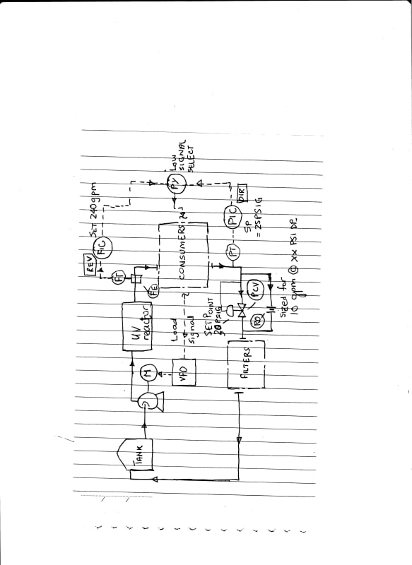

Think you can do without that 240gpm restrictor which burns a lot of pressure. The scheme I have in mind to load the VFD for the pumps is as follows:
a) Install a flow element and FT downstream of pumps or downstream of UV steriliser. Configure a reverse acting hi set FIC with this - setpoint 240gpm - this will be the override controller to provide the load signal to VFD
b) Retain the current plan to sense pressure just upstream of backpressure regulator and configure a direct acting PIC with this - normal setpoint 25psi - this will load the pump VFD most of the time
c) Configure in your control system an auto signal select to select the FIC output when it reaches SP of 240gpm, thus cutting off the PIC output from going to VFD
See diagram attached. This scheme enables you to operate the pump at the min required supply header without losing developed pressure, so it saves on power. If you dont have PLC, you can just as well configure all this with equivalent pneumatics devices, all mounted locally.
