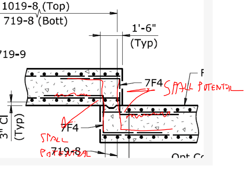

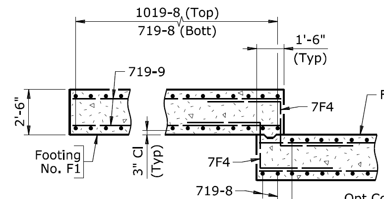

An interesting discussion. Just to add a little more fodder for discussion (though it seems there is plenty already), my arrangement for the footing steps in a rather large retaining wall looked like this:
Oi... it seems that this will be the thread where I alienate the few remaining friends that I have left.
I don't like z-bars that don't make it to the far face of the members into which they are embedded. As shown, the bars would create spalling potential that would render the bars pretty useless in tension. And, at the end of the day, why bother installing a bar if you can't pull on the damn thing?
No worries about alienating me. I greatly respect your insights, and I agree with you. I completely overlooked that potential failure mechanism.
Lucky for me, the contractor opted for a different type of wall, and had a consultant design it. The footing I showed was for a post-tensioned wall utilizing precast double T sections for the stem. The contractor proposed (and we ultimately accepted) an all CIP wall. It's a monster - up to 30' high and 900' long, with an upper tier MSE wall up to 15' high above it.
Beat me to the punch it seems, that's the first thing I noticed too.
One warning for those who are trying to maintain capacity through the top face and vertical face of the step, it is "capacity" you need to maintain, not area of steel.
- If the throat thickness is larger than the slab depth either side, the area of steel can reduce to maintain moment capacity.
- if it is prestressed, then it is a completely different calculation. If the PT is not continuous, the Area of steel required will need to take the full moment, while in the slab the PT will be contributing. Even if the PT can be continuous, unless it is a very long step transition effectively making it a sloping slab rather than a step, the PT will have no effect on the vertical reinforcement. So you could end up with a lot more vertical reinforcement than slab face reinforcement.

No luck required. While it might be a technical detailing fail, it would have been a very low consequence one. When I see this on footing step details, I speculate that the designer is often simply attempting to make the T&S rebar continuous across the step which is understandable. And, often, there isn't space available for a "by the book" detail. Heck, I think that my own residential footing step detail shows it this way.
Yeah, considering the forces on the footing should be fairly even across the joint (the stem sections would be made continuous by shear keys) moment transfer, and even shear transfer, across the step would be minimal. You've definitely made me think, though, and I've learned something today, both of which are good things.
