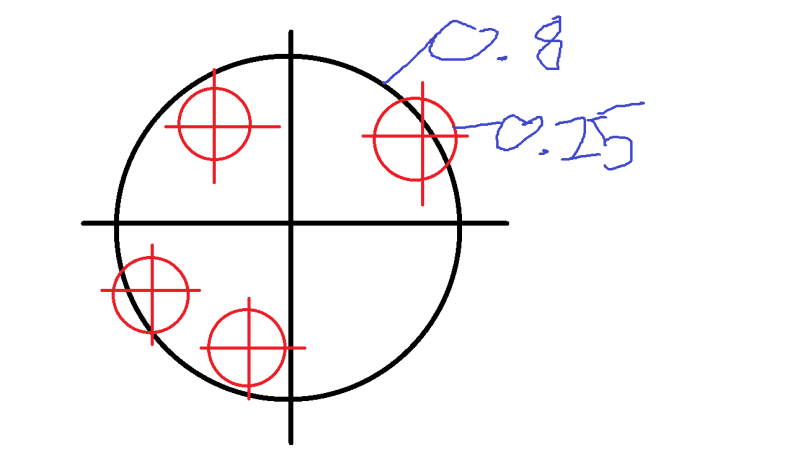

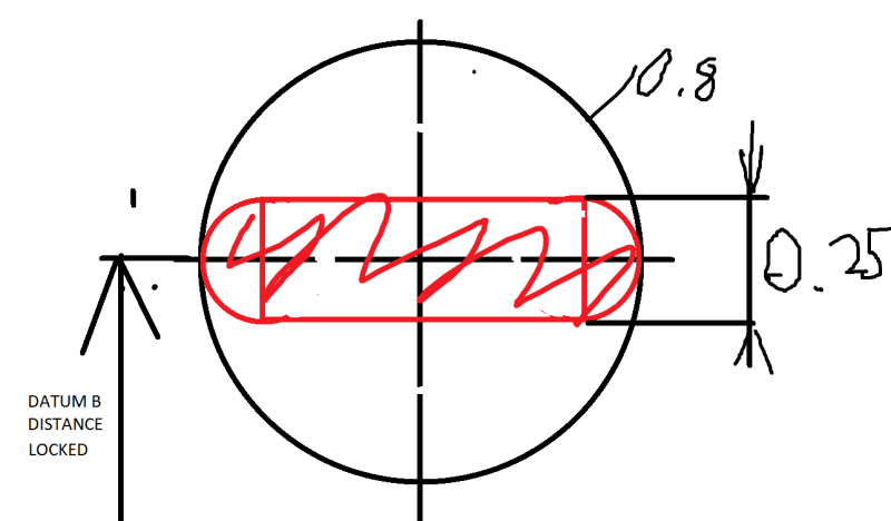

Hi All
Can any one explain exact difference between composite and multi-segment pos tolerance, is Multi segment used for refinement of uppersegment ?
in both lower segment controls orientation and feature relation then what is the difference and how to choose which one to use with same datums.
refer images from asme y 2009 and list the difference pls
image from fig 7.39a and 7.46 c

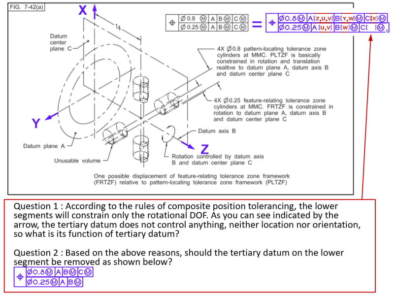

Evan, it cannot be a refinement of a requirement if the basis for that refinement is allowed to change.
Are you allowing for the adjustment of the part between inspection steps to generate different datum simulators/true geometric counterparts for the same datum feature references on a composite tolerance?
That each level is allowed different orientations of the part relative to the identified datum simulators/true geometric counterparts?
How much tolerance is allowed for those shifts in orientation?
How does that affect tolerance stacks?
Then comes this question: If the part orientation in a composite tolerance is allowed to change while using same references/same order why then the requirement for the order being the same?
My position is rational - fix the location and orientation of the part relative to the datum simulators/true geometric counterparts established by the first segment and use those datum simulators/true geometric counterparts as references to establish orientation as mentioned in the lower segments. If a reference does not establish orientation or is not desired to control orientation, it can be omitted.
What is irrational - requirement to include references that cannot control orientation in a segment with the limited purpose of controlling orientation.

"We're saying that B is needed in the lower segment because referencing it affects the orientation of the DRF. If you disagree, that's fine."
You say that because you accept that the part can be repositioned for the lower segment and therefore the tolerance zone for the lower segment can be allowed to exit the tolerance zone for the higher segment. It is your statements that support it isn't a refinement. You misread the conclusions your statements support for my understanding.
I say there is only one DRF in a composite tolerance. Every level has access to exactly what is established in the top level. They cannot be redefined.
If they can be redefined then there is no need to say they have to be repeated, although they aren't repeated in their entirety or at all - then any references should be accepted. Why not, in the example, allow [A|C(M)] if the user wants that to be repositioned basis?

No, it does not make sense.
Consider a simple rectangular block that has 3 nominally perpendicular surfaces designated as datum features A, B and C, and two through holes perpendicular to datum A.
You can use a composite position tolerance for the holes referencing A, B, C in the top segment and A, B in the following segment. After the top segment requirement is verified, there is no more need to keep the part fixtured to the simulator of datum C. For the second segment, the part can only be supported by the datum A and B simulators. The holes would be evaluated for perpendicular orientation to datum A, lack of rotation in the direction constrained by B, and mutual location. You don't have to keep the datum C simulator or the part static in the directions that C arrested for the first segment for that. If the bottom segment does not reference any datums, then you don't need any simulators or constraints to verify it. Only the mutual location and orientation of the holes are then considered.
Unlike you may conclude from just reading the descriptions in the standard without giving any thought to the practical application of the concepts, You don't need to actually verify for each lower segment that the "feature relating" tolerance zones do not exit the tolerance zones of the segment above it. In practice, each segment's tolerance zones are respected as long as the features are found to fall within them: Once it's found that the features are within the PLTZF tolerance zones constrained by A, B, C, you no longer need to worry about that DRF when verifying the following segments.
