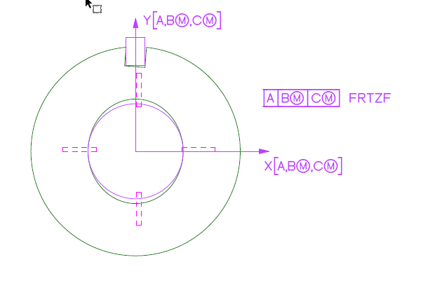

We really need the sketch, so here it is. This is the as-produced part that pmarc and I were describing, with the C slot that is skewed / off center relative to the B hole.
The customized DRF would result in this:
I don't think this is what Y14.5 intended. The FRTZF is oriented to the center plane of the C slot, and B does nothing.

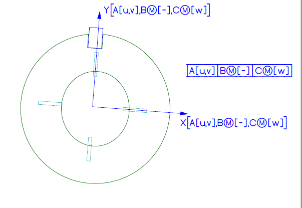

Here is how the lower segment would look, if we apply interpretation 2 from my earlier post:
I believe that this represents the intent of the lower segment properly. B and C both participate in constraining the w rotation. We need the B simulator to provide the axis about which the C clocks the part. Neither B nor C constrains the rotation on its own. After the DRF has been established, the FRTZF is allowed to translate relative to it - this is what makes the lower segment different from the upper segment.
